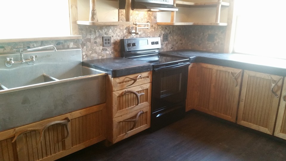

Took this picture yesterday after getting the range. We're still waiting on the dishwasher and looking at freezers. We're also looking at 4 drawer filing cabinets, but sticker shock on the decent ones has surprised us.
I made the drawers out of 3/4 plywood and put sanded bead board on the face framed in pine. The cabinet doors are similar with sanded bead board and pine. Then I went through my collection of antlers and found a few smaller ones that looked nice. I cut and sanded them so they would fit flat, then drilled them for some threaded rod. Cut the rod and used as much Rexel glue as I could to hold the antlers onto the rod and also glue the antlers onto the wood. So far, it seems to have worked.

Very nice work on the cabinets!
   / Garden Kitchen/Processing Room #65
Looking great...very unique! :thumbsup:
