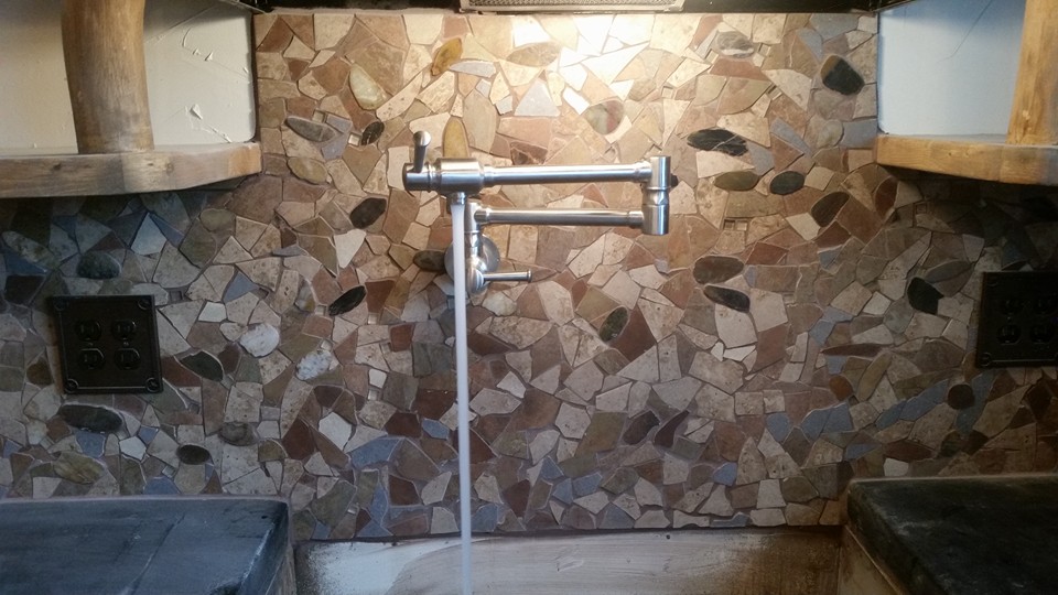

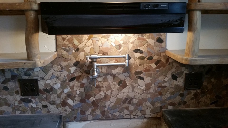

After reading every review on Amazon for Pot Filler Faucets, this one stuck out as a good deal. I did make a huge mistake. When measuring where to run the water line and where to mount the faucet, I forgot to take into account where the vent hood would be. As luck would have it, I put it too up too high. After going over my options, I tore apart the wall, lowered the water line five inches, then put it back together. I think I got lucky and nobody can tell.
The other mistake I made was using PEX that I had sitting around. It never occurred to me to blow out the line before installing it. After installing the faucet, water didn't come out. I took it back off and found a big was of grass packed inside the facet. It took me an hour to clean it all out. That was bad.
Fortunately once I fixed those problems, it was ready to go. My wife is very excited about it and can't wait to use it to fill the pots when she starts canning what she is growing in our garden.

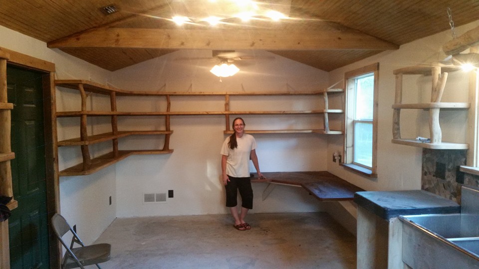

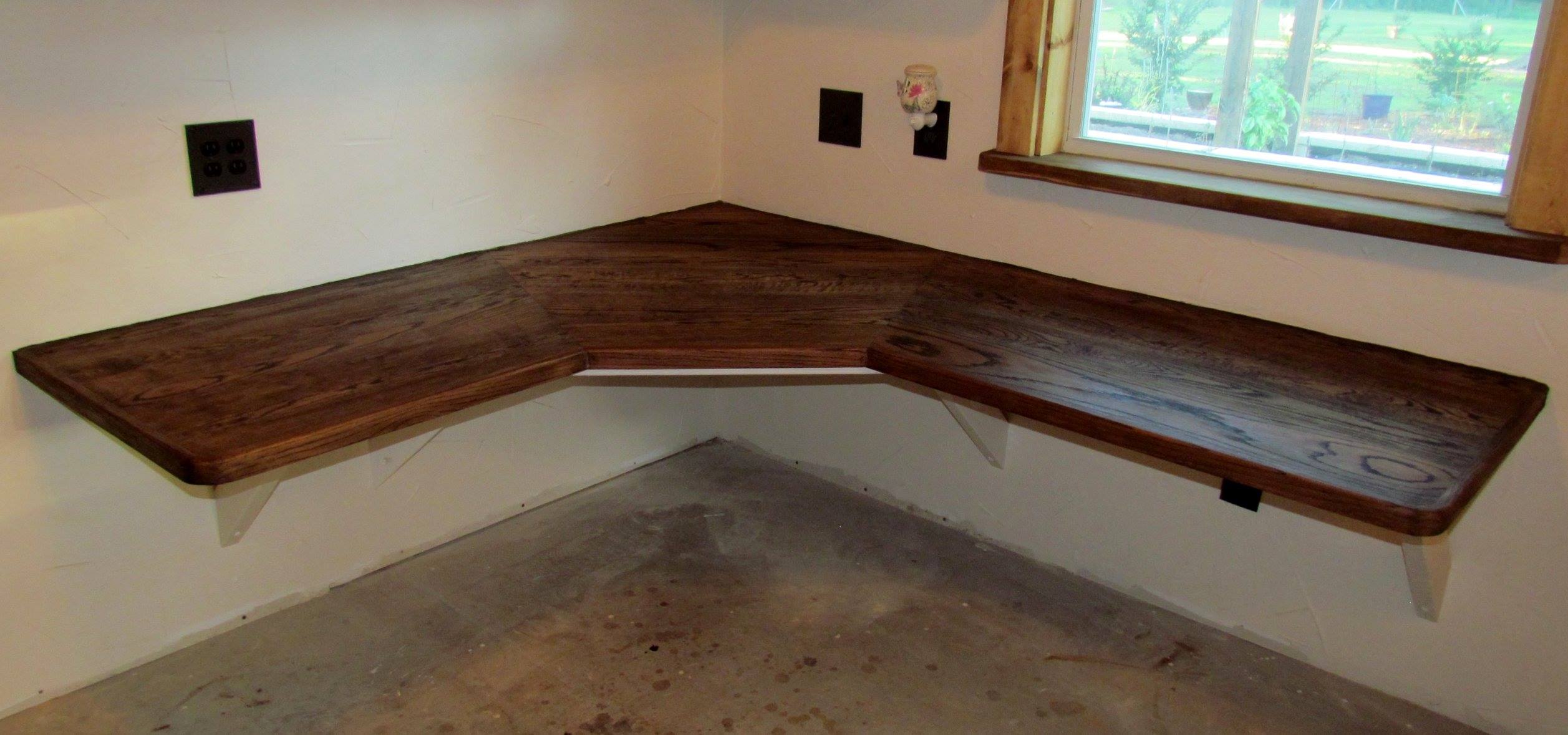

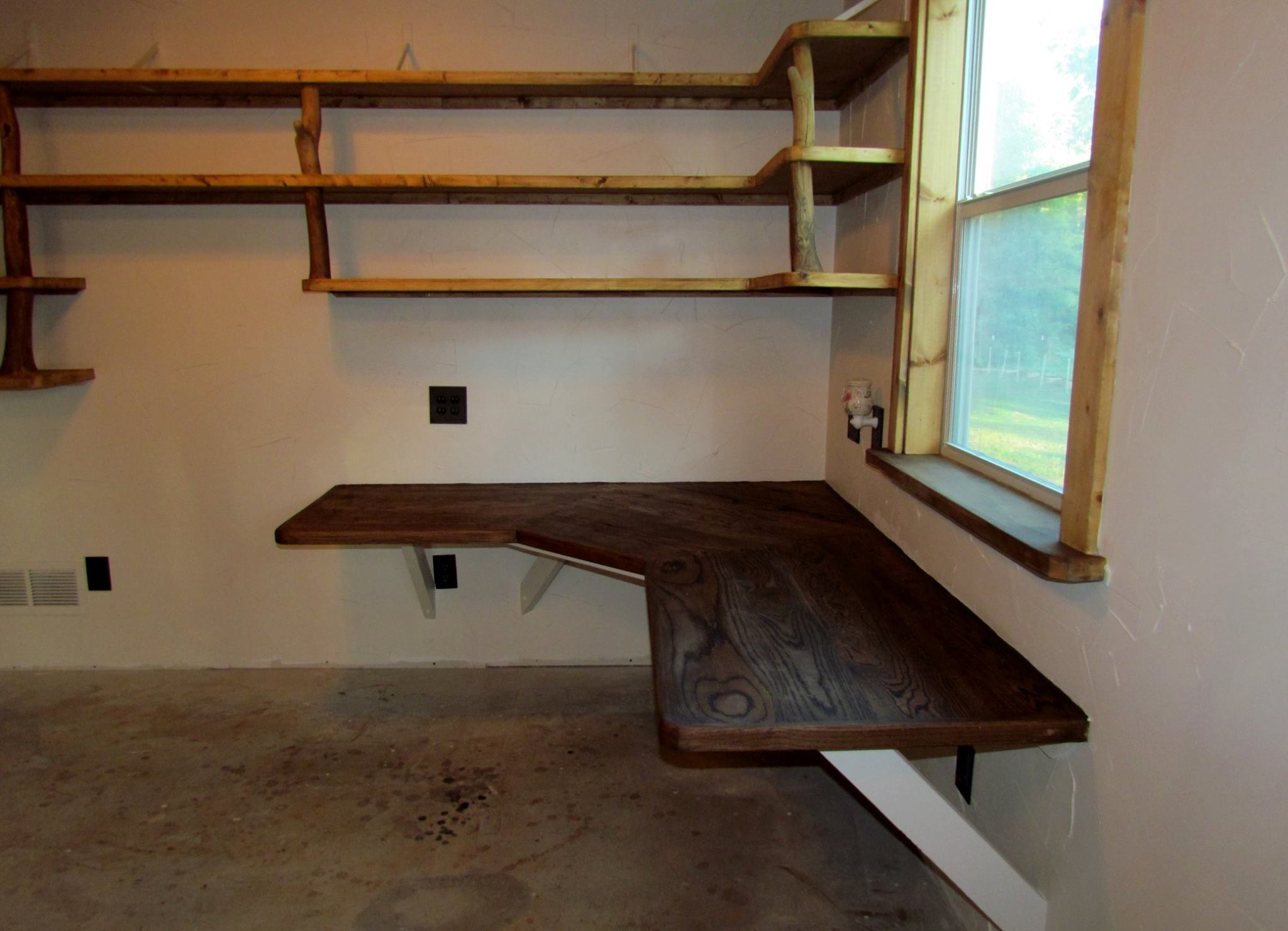

Thank you. She is really excited about the pot filler and having a dedicated space to work on what she grow in the garden. This is all new to us, so we are just winging it and hoping for the best. I'm working on her desk right now. We went to Lowes together to pick out the wood. After comparing what they had there, she really liked the oak the best, so that's what it's going to be made of. She also wanted it at the perfect height for her because she plans on doing a lot of writing out there and a normal height desk is uncomfortable for her. This one is going to be at 27 inches.
   / Garden Kitchen/Processing Room
#58
I went back and forth on what to use on the desk, but in the end, Karen decided that she just loved the look of the red oak at Lowes. I wanted it to not have any legs to get in her way while sitting there, and when sweeping the floor. She also wanted it lower then standard desks and tables. We decided on a top height of 26 inches. I was afraid that was too low, but she sat down in front of it and it's perfect for her to type on. Honestly, it felt pretty good to me too.
Very cool design Eddie both the desk and the wall shelving. :thumbsup:

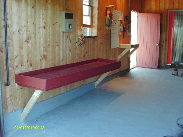

I mounted some display tables and a telephone stand to the walls in the old store at work in a similar fashion a few years back. It meet GAP compliance nicely as made cleaning underneath the tables very easy. I came in one day and the owners son was standing atop my work trying to light the modine heater. :eek:
Never thought it would be tested like that! :D
