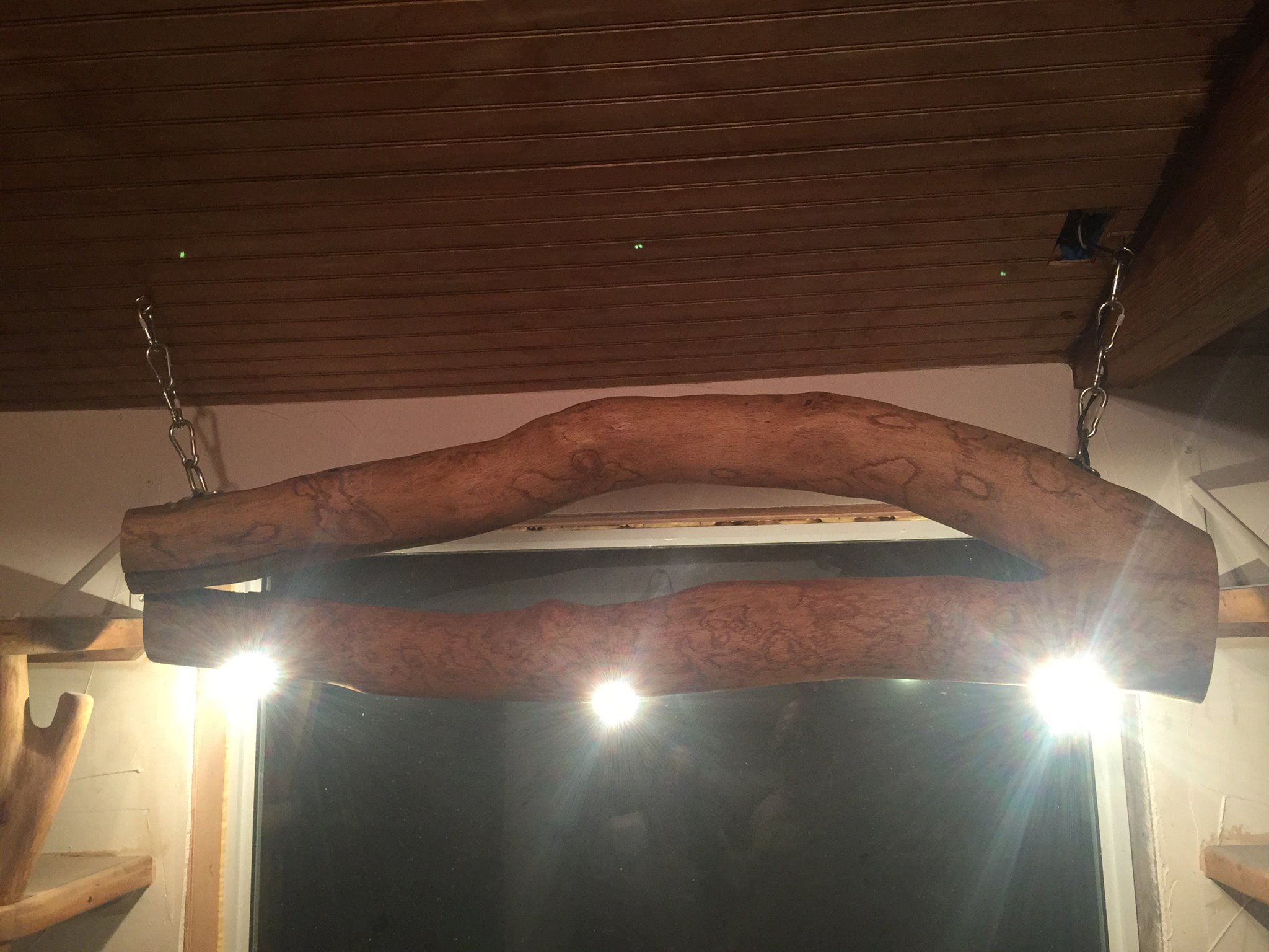

While stain and sealer was drying inside the kitchen, I build this light for over the sink. Mostly it's all of sanding.
I have a big oak tree that fell down awhile ago that I've been slowly cutting branches off of for firewood, and for the shelves. I found a nice Y shaped log on it for my center chandelier, and this odd looking log for my over the sink light. My original thought was to do a mason jar light fixture, but the ceiling is too low for that. Then I got the idea to do something like Christmas lights, or an LED rope, but that didn't look right. I found some G8 bases on Amazon that I figured would be easy to recess into the bottom of the log, and have part of the G8 bulb sticking out. I cut a channel into the top/back of the log to hide the wires and then ran it up the chain into the outlet box I put in the ceiling. I'll cover that with a blank faceplate.
It's very simple, but I think that's what makes it look nice.

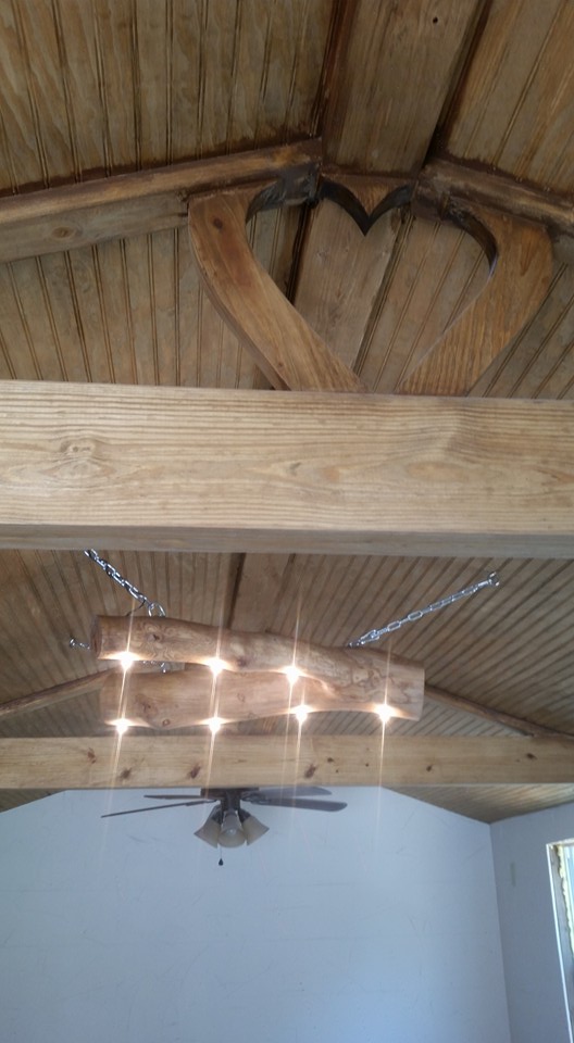

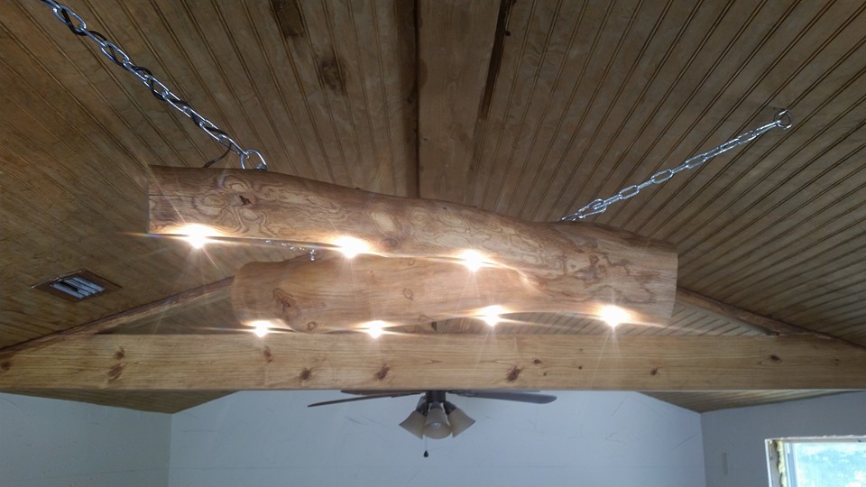

I finished up the log for the center light and got all the electrical outlets connected. I find outlets to be tedious, and tend to put it off for as long as I can.

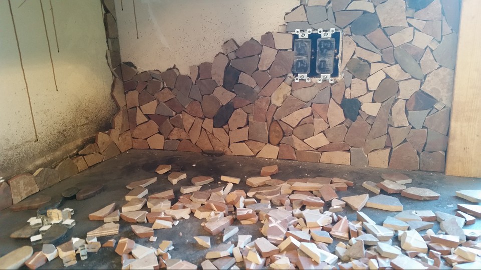

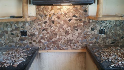

Now that the counters are done and sealed, I've started on the back splash. I'm using 6 different colors of tile, two sheets of cut and polished rock and about half a sheet of half inch glass squares. It's slow going, but the results make it worthwhile.
   / Garden Kitchen/Processing Room #50
Looks good, but that IS a lot of "hunting and pecking" to fill in the back splash
