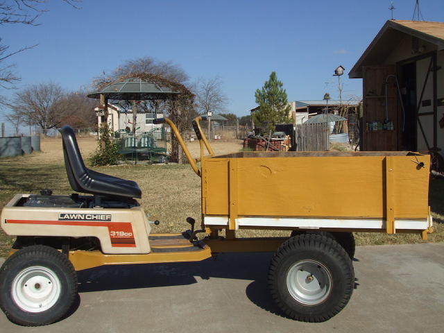

Don't laugh.......but I have $23.74 in this (wood and one hydraulic fitting). It'll look better with some paint (gotta get rid of that ugly green and yeller..), and I have since made a battery box and got it wired up.

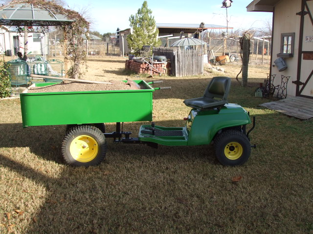

I can't remember where I saw them, maybe on another forum, but a couple of people built some really neat ones:
Bobodu,
Does your masterpiece have an hydraulic dump? Tell us more about it. Any more pictures? My wife needs one of these. :)

I looked around and I don't seem to have any pictures of the pump before I covered it up with the wood. But the pump is mounted about halfway down the main frame with a belt going up to the engine. Another belt runs from that back to the tranny and this one has a movable idler pulley to engage the gears. I linked the pulley up to it only tightens the belt when the peddle is pushed. Anyone who has real meat eatin' God fearin" gears knows what a pain it is to put the tractor in neutral every time you move to a new pile. The pump is a 1.7 gpm with a built in valve and this powers a single action ram. Still have to get a big spring to pull it back down because I didn't have enough room to mount the hinge far enough back to let gravity do the job and I had this cylinder on the shelf.

Here's another way to run a small pump. This is actually a P/S pump from a Sonoma that I won on ebay for 99 cents plus 3 dollars shipping!! There is a tank under the seat that I made from a short chuck of 5 inch pipe.
