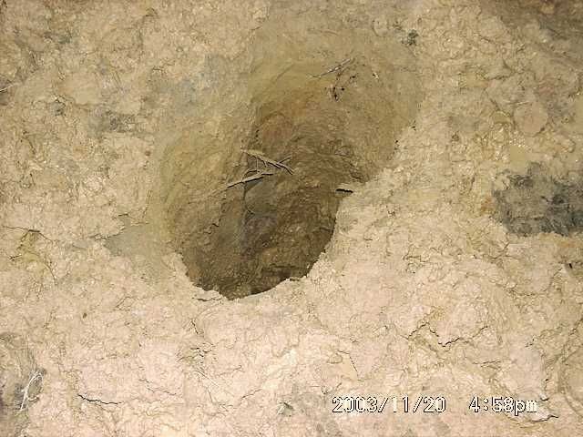

I got the 8 main holes re-dug out today with the 14" auger. And got most of the water out of the other holes.
Here's a pic of the front right twin hole.
gary
   / gary's pole barn project(not Spencer's) #14
Re: gary\'s pole barn project(not Spencer\'s)
Gary, it looks like you are off to a good start. How hard is your ground to dig holes in? It looks like a lot of small limestone rocks. With all your pine trees, I did't expect to see soil with so much calcium. Don't pines normally like acid soils? Hmm... Also, what happens when it rains really hard? Will the water drain around the barn or come flowing through it? When I bought my property, there was a small barn and the floor turned into a river when it rained. I had to build some mounds of dirt on the high side to redirect the water flow.

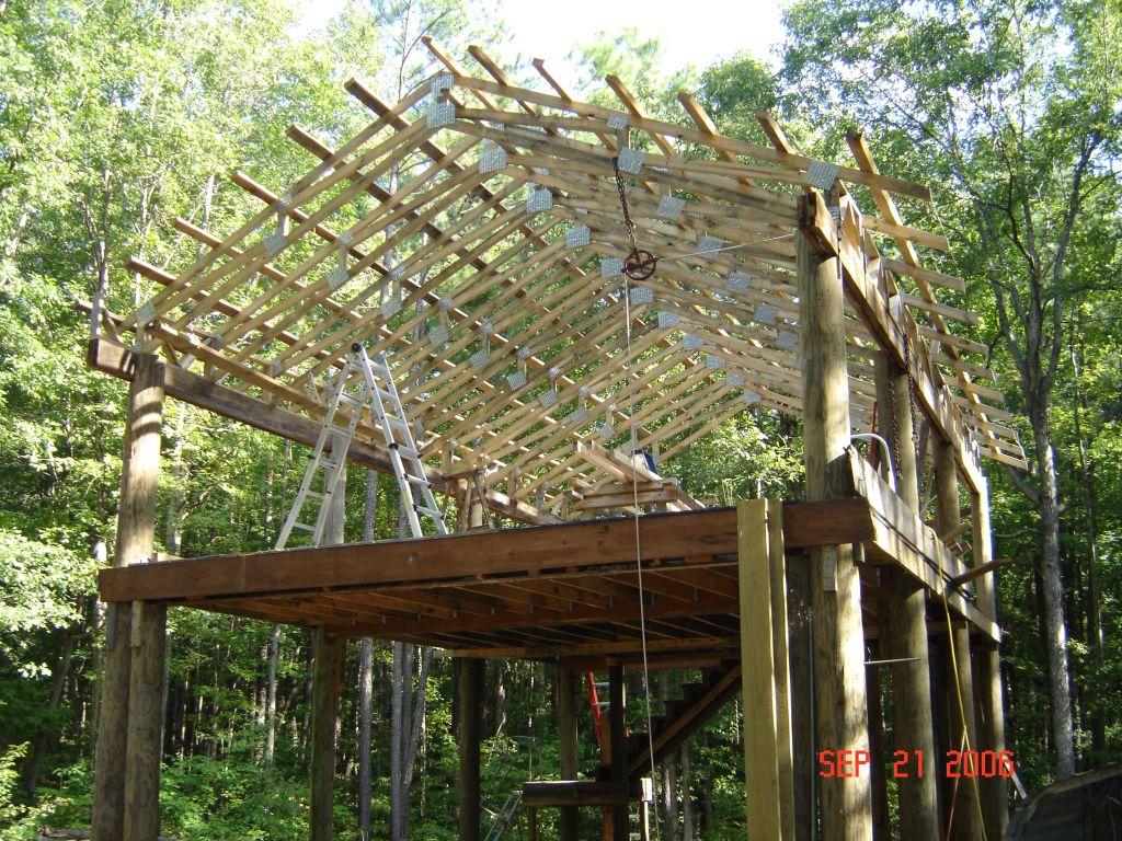

Hello again!!! long time back. we've had another boy and it's been soooooooo busy. just getting going again with the barn. Got some new pictures.
#16

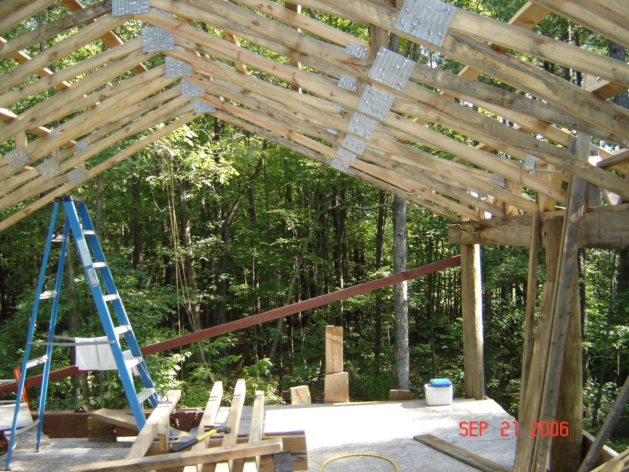

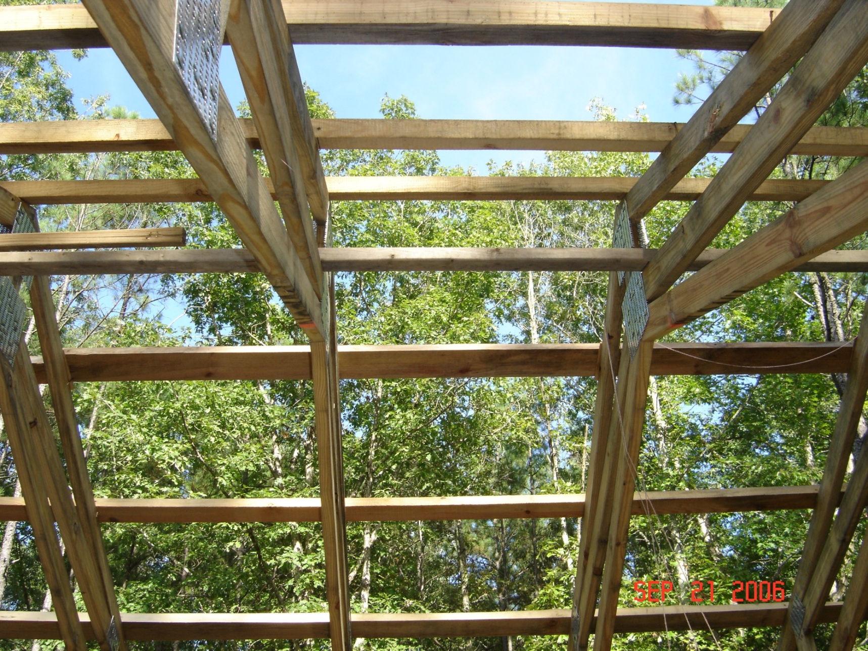

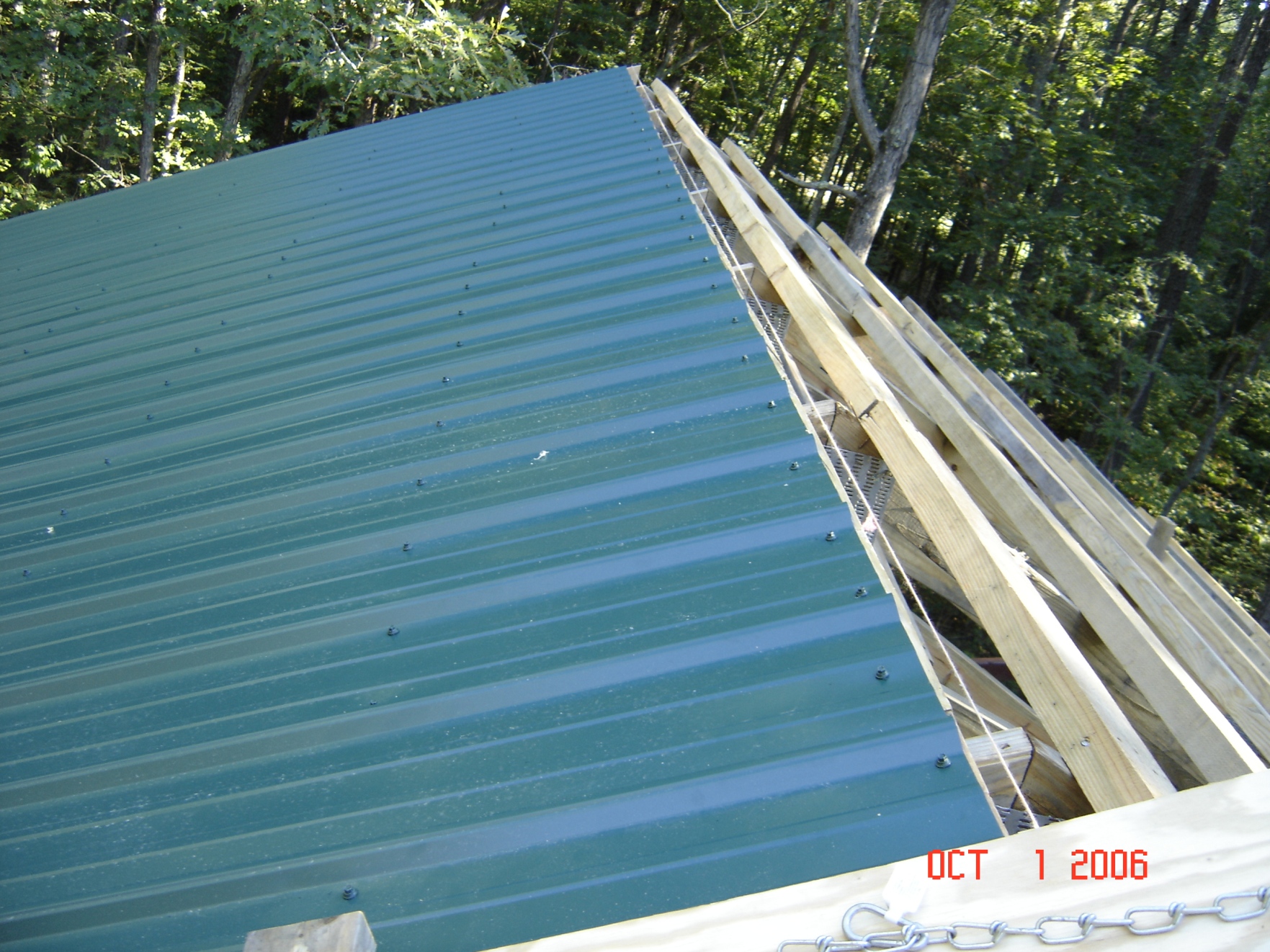

another one from today. These are the sissor truses, 11 of them for 30'. They are 6-6 pitch and 20' wide.
Got 11 of them for $700
The purlins are what I'm putting up right now and I just boought the metal for the roof for another $800
gary

Bird, well that a very funny idea, because for the last 2 years we've been calling it JW's(my 5yo) barn, becasue about the time it'll be done he's the one that it'll be for.
But since I have no help, except for a few extra hands for very rare times. I put all the floor joists up all by myself, cut each one to a custom length, laddered them up there and power nailed each in place. Took the better part of a year for just that.

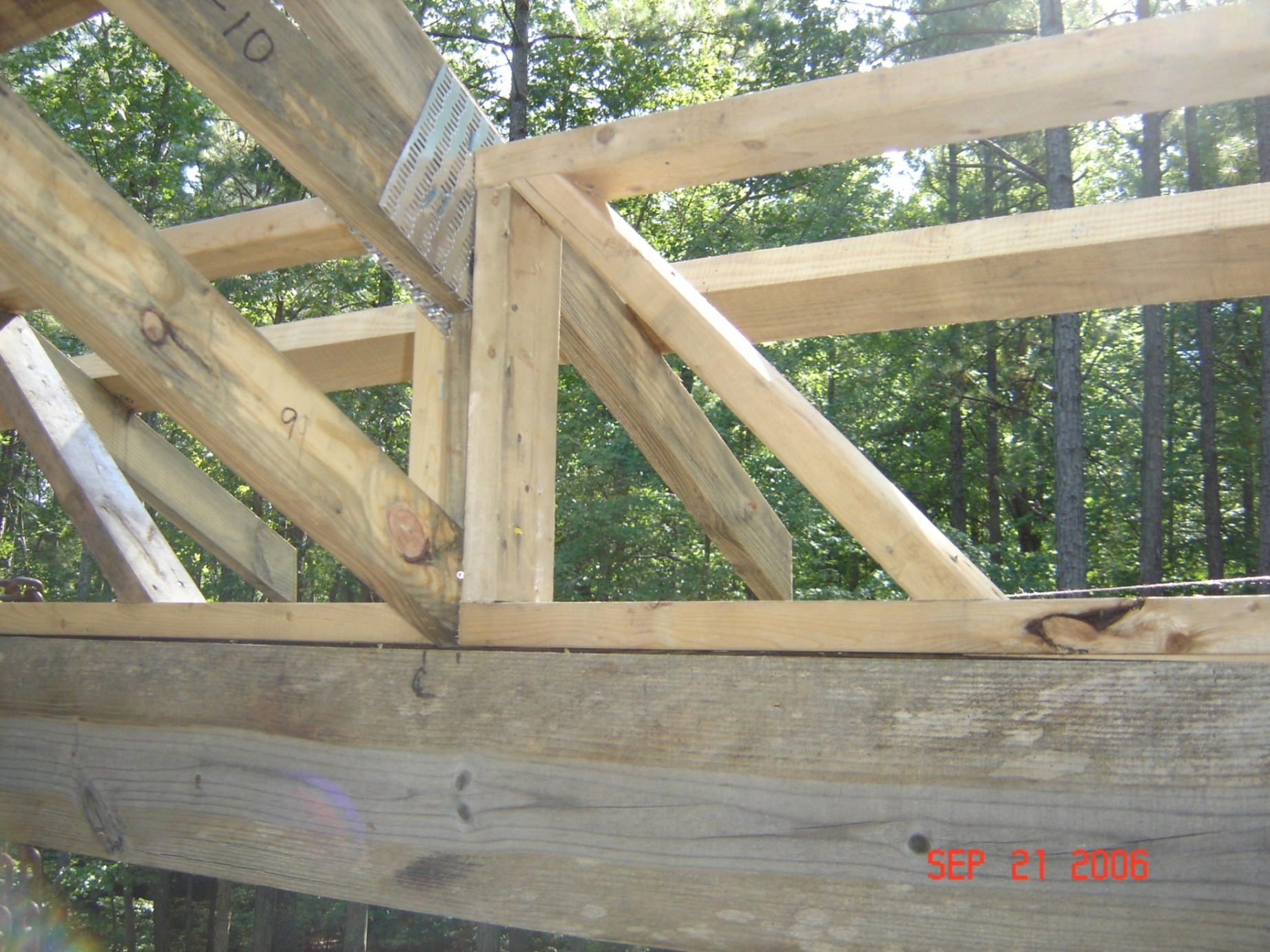

Great to see your back at it!!!
Why did you put truss's on your endwalls? Why not just frame up your walls to the roofline?

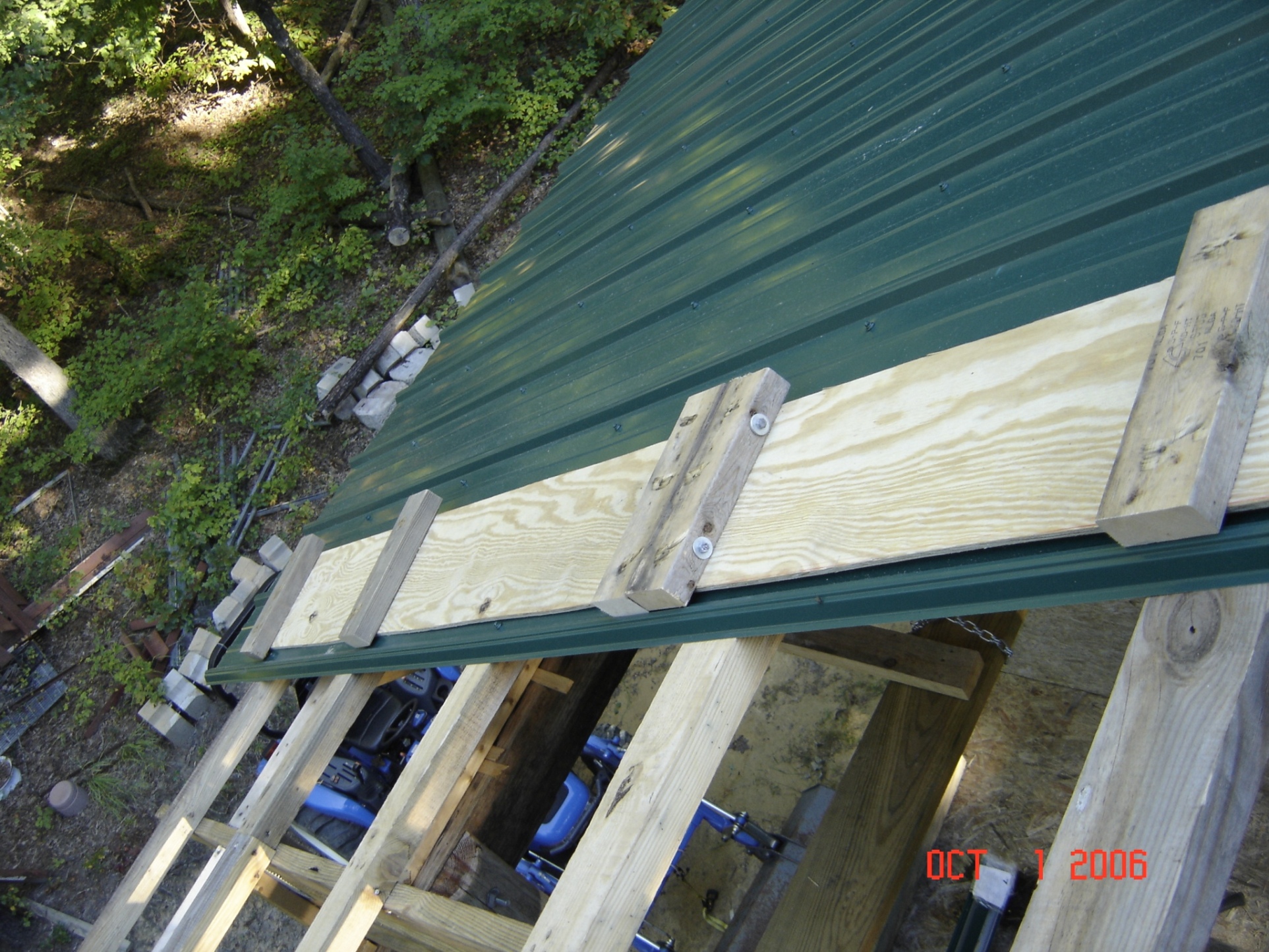

Hello, can anyone provide me with some ideas for installing my ribbed metal roofing?
I've got the purlins up and have gotten a few of the 13.5'x36" panels up, but I've been doing it by sitting on the purlins and reaching across the panels to screw them down. Now getting near the end I'm not going to have the purlins to sit on.
Should I use a ladder or something to lay down on the panel and secure it from tyhe oppisite side of the roof? Any ideas?
thanks
