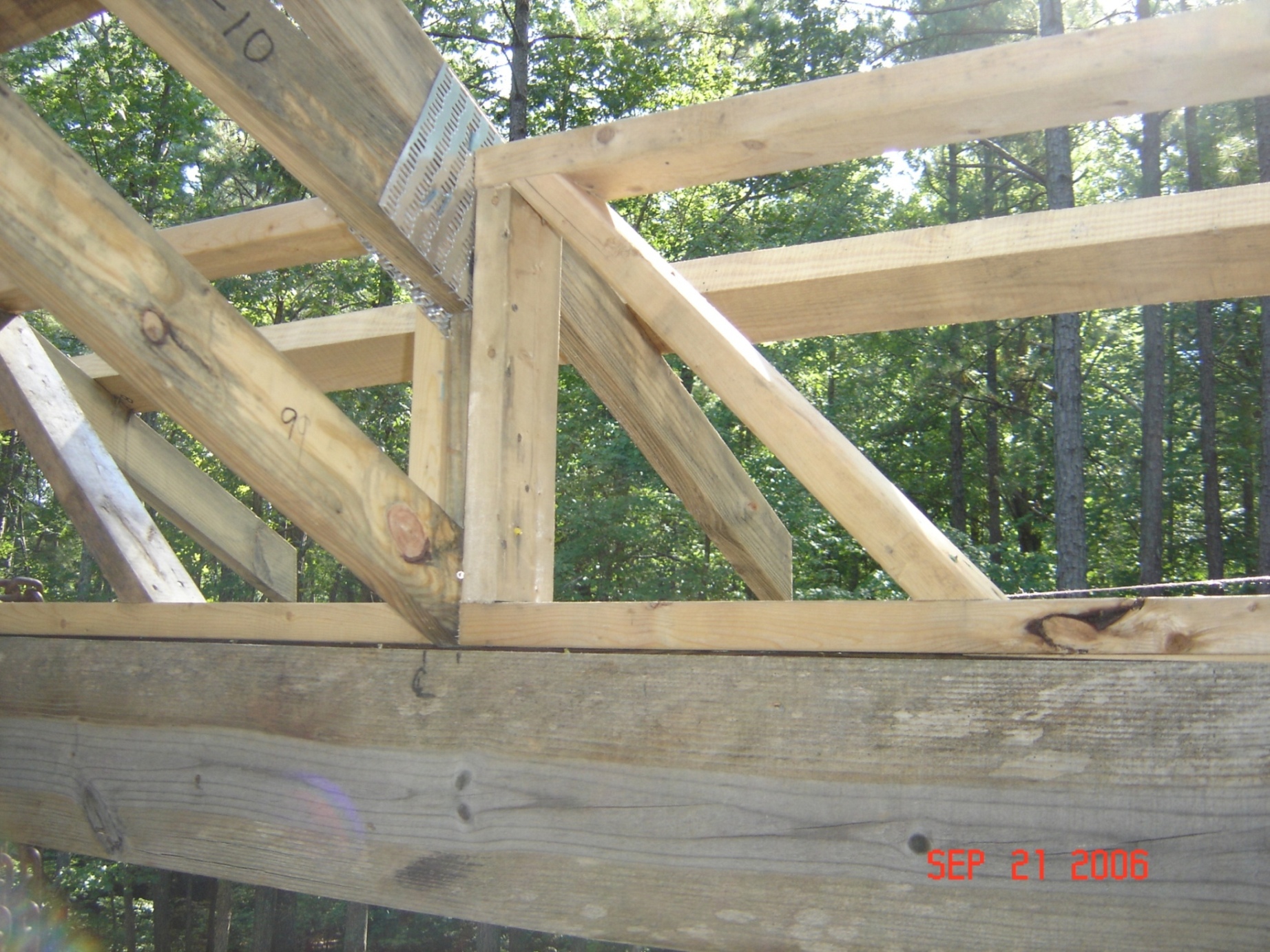

Looking at your latest two pictures I can't determine how your scissors trusses are braced? Surely there's some sort of cross-bracing to keep them from collapsing but I couldn't make it out. I've never used that type truss before, so was interested in looking.
   / gary's pole barn project(not Spencer's) #22
cross braceing?
with the use of the tension webs (that require no permant braceing)
his perlin spaceing on the roof looks good.
based on span and basic load, virtually no permant braceing is required

Glenn9643 said:
Gary,
well, that was an interesting problem with putting them up on the wall. It took the better part of a day to put just one up with 4 of us working on it.
We could get it up, but had no real way to brace it well enough. Because of the scissor trusses inherent top heavyness they alway wanted to "flip" on us. They only weighed 120lbs each, but were just plane awkward without a crane.
After sitting and astaring at the problem for a while I came up with this method of building these 2x4 boxes to sit on top of the wall. this way they gave me something to nail the truss to and also to help square it up and space them properly.
hope this pic helps
gary

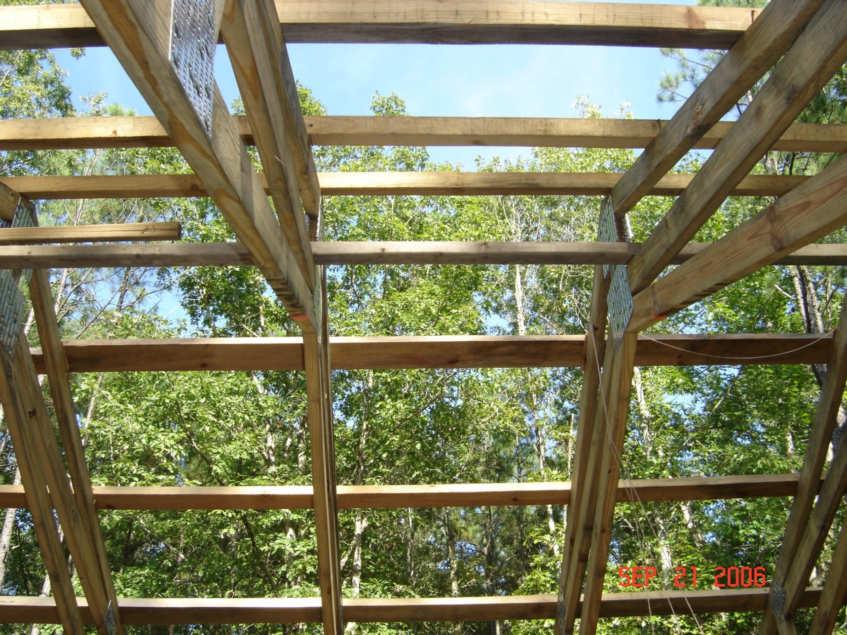

Purlins are ture 2x4 pine wood I sawed on my sawmill a year ago. and are 24"OC up the pitch. There are a total of 7 right now and the last one I'll put and use at the bottom for the facia board.
Oh, and I've been up on the purlins putting the metal roof up this week and there is absolutly no movment, no bouncing or swaying. And I'm ~230lbs.
here's another truss and purlin pic

I can see where the knee-walls you built helped in erection and keeping things upright and aligned.
The second picture also shows a 2x4 within the trusses just below the peak of the roof. I expected to see some diagonal bracing through the trusses as well to strengthen so they can't all collapse like a house of cards if you get a strong wind. Hopefully your knee-walls will provide that strength. Everything looks good; you'll really enjoy it after you finish.

Glenn9643 said:
everything I could find indicated a requirement for lateral and diagonal bracing when installing the trusses.
yes when installing trusses, but once your permant braceing (in this case purlins at 2' OC) are installed (or sheathing) then much of your temorary braceing may be removed.
again based on the span, and use of tension webs (which have a much larger L/D requirement for out of plane buckleing) other than the roof and a 1 or 2 on the BC, no addtional permant braceing is required on a truss of that size.
BCSI (Buliding componet safty information) can supply all the neccary information based on temorary lateral and diagonal braceing, essepecial for long clear span (60'+) trusses.
