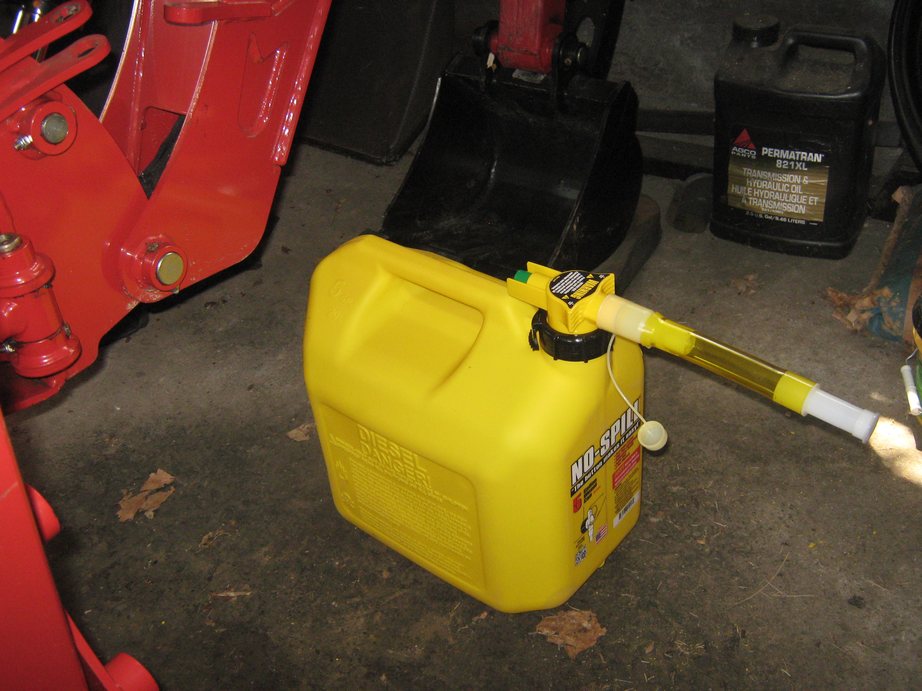

The No-spill cans can do that.
I replaced all my gas cans with the No-spill cans. By far the nicest working cans I have used. (available for diesel also)
Pour fast, slow or instantly stop with the button.
No-Spill Gas Can - For Life Out Here
IMG_1310.JPGyou can get a extended spout also.

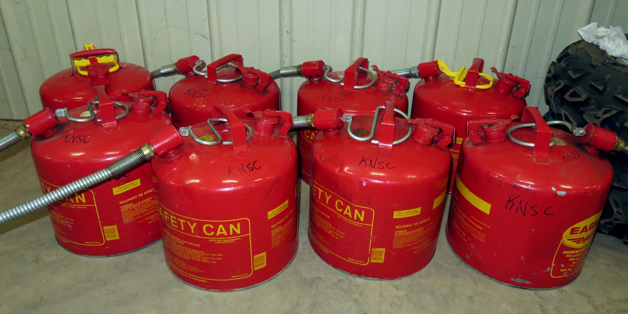

Eagle class II safety cans - really
I'm a bit surprised of the plastic fuel cans following we have here. :D Nonetheless, here are the reasonably priced Eagle steel cans we use, and the plus side of them is they don't leak. We have many more cans than whats pictured here. These get carried on machines and occasionally do fall out. :eek: That is why some are dented as seen in the group shot. No they are not perfect but at $60 each, they are good enough for us kids. They've worked well enough, I purchase one for home use. I should add, we do beat the snot out of them here and we must have these flex spouts.
