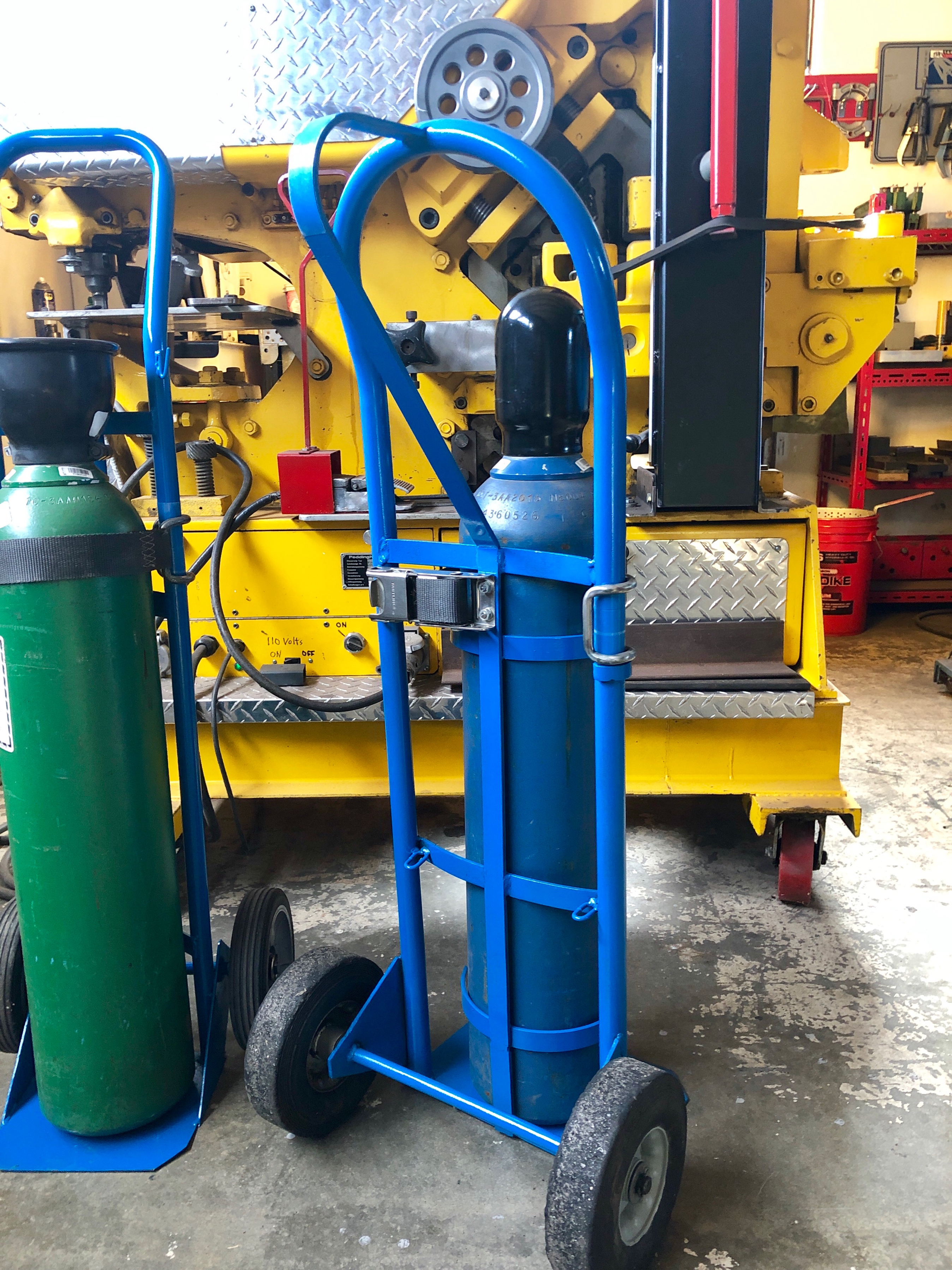

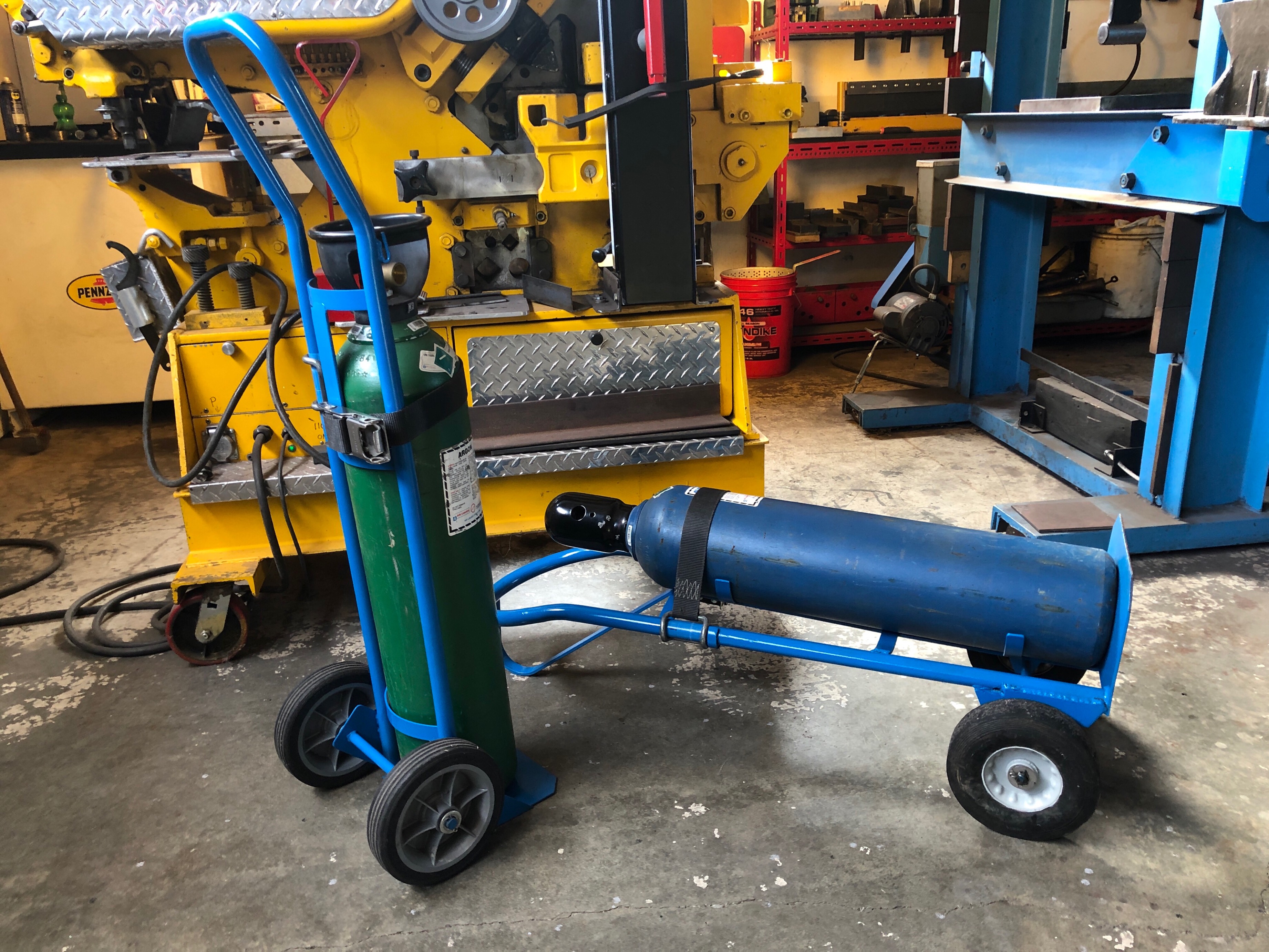

Most LWS sell carts like this. The back wheels are just a kick stand to make moving around a little safer with less weight to hold onto. This cart is how many hospitals move their spec gases around.
Agreed. The lean back feature was designed for safer moving. It should be put in the upright position for storage and operation.
I designed this single cylinder cart to be laid horizontal with tank for transport. The entire unit can be strapped down easily. I use it for inert gases.
