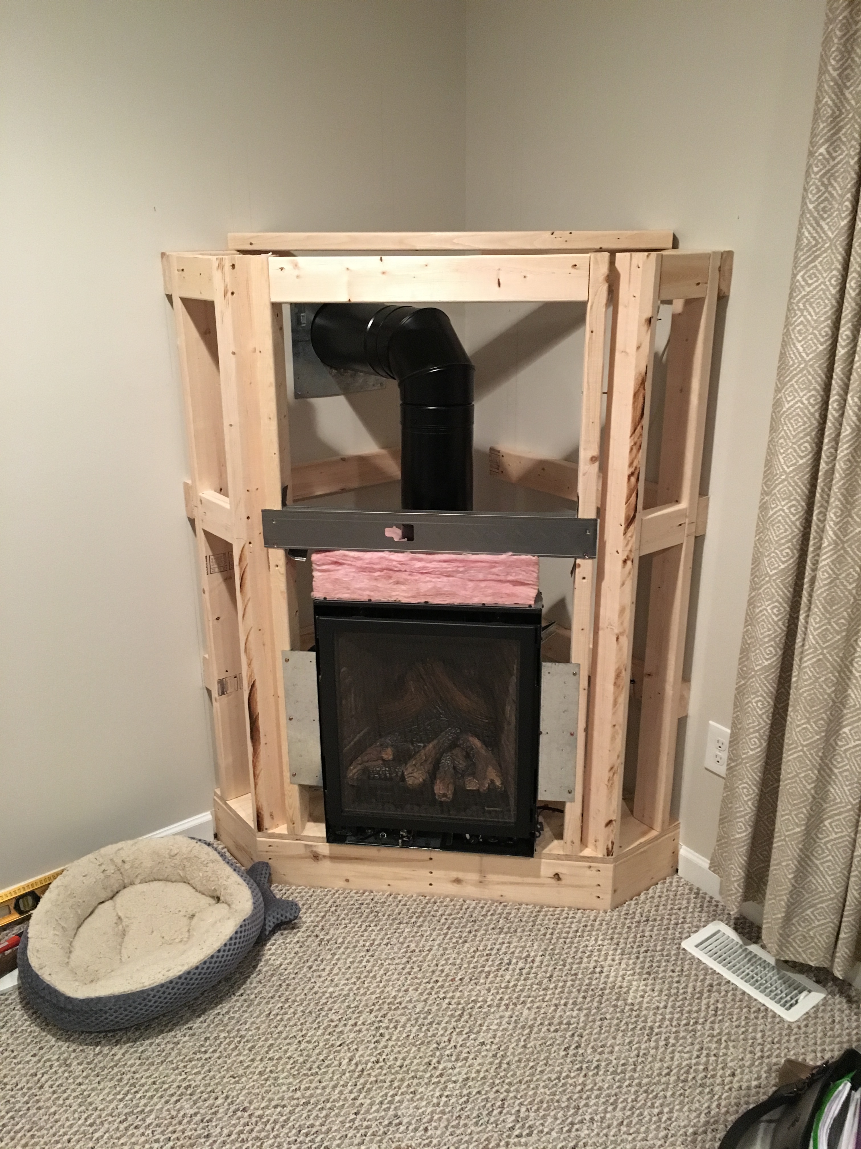

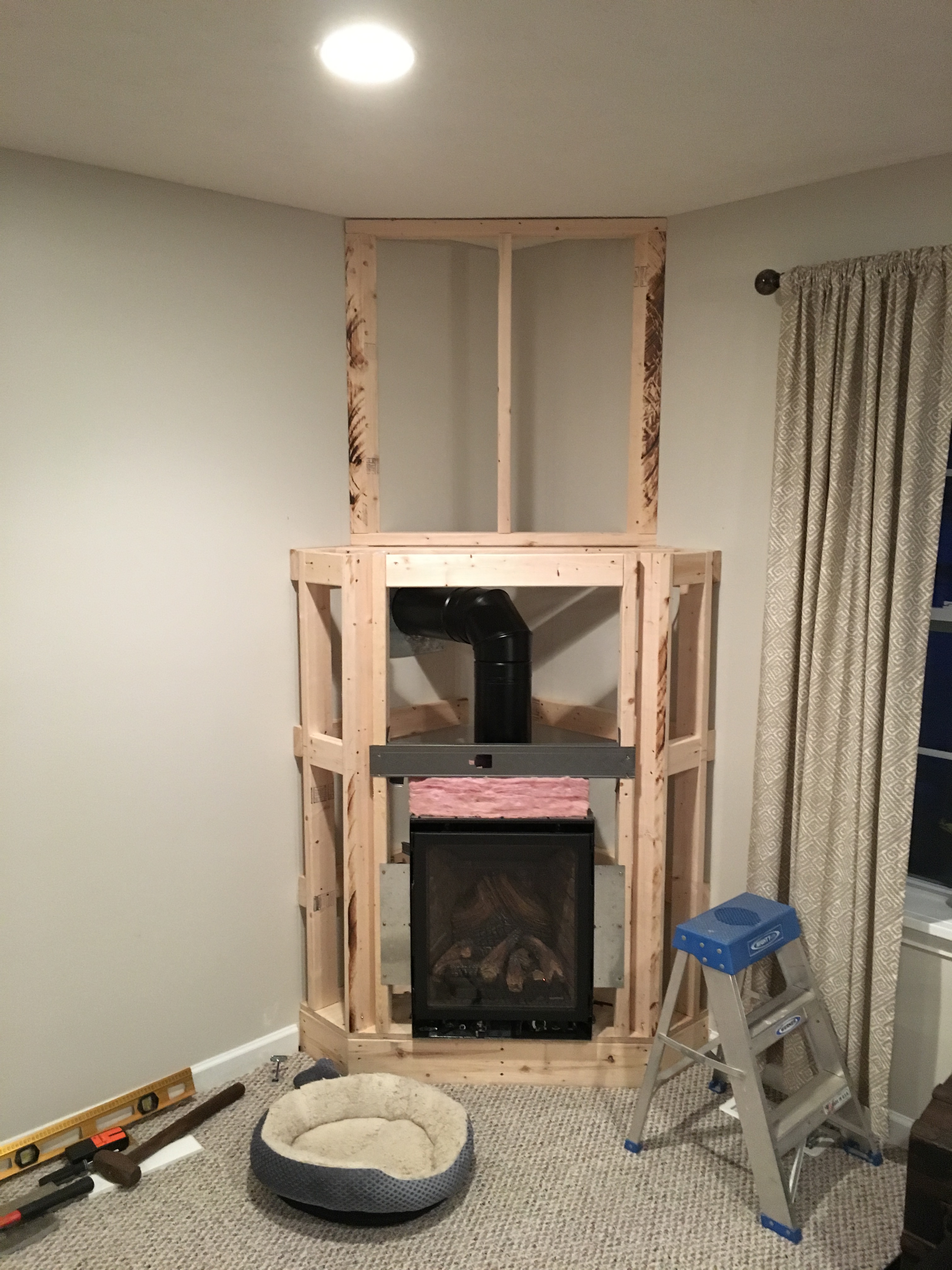

I'm going to have a gas fireplace installed soon. I'm doing the framing for the install (inside corner of the family room) and a pro will do the actual unit install with gas and electric hook ups.
To prep for the install, all I need to do is build the platform that the unit will sit on. The installer needs the space to put in the gas, electric, and vent through the wall. Once that is done, I will frame up the enclosure, have it all inspected, then do the finish work.
Even though this is a 'zero clearance' unit, there is still plenty of clearance required. Especially above the unit where the coaxial vent pipe comes out and does the 90 degree bend to the exterior wall. I expect a lot of dead space where no combustible materials may be used. This is probably because the vent pipe and space above the firebox will get hot.
So here's my question... Can I take advantage of that heat be leaving an opening at the top of my enclosure (and possible a small vent at the bottom to allow a convection)?
Seems like two good outcomes. 1 - A bit of extra heat in the room. 2 - Lets the heat escape the enclosed cavity.

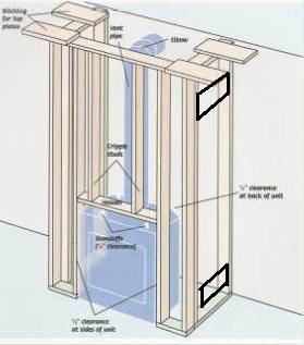

Here is a picture of a 'bump in' framed with a fireplace installed. I drew a couple of parallelograms where I was thinking about putting my vents... Just an example showing how warm air could get out of the cavity above the fireplace by letting cool air in at the bottom.

Doug, I know all that, but it doesn't have anything to do with fire code, clearances, etc. The gas fireplace at our last house still had code requirements for non-combustable materials on the face around the fireplace for a certain distance from the opening. As far as fire code is concerned, it's still a "flame" inside the walls/framework of a home, and they don't really differentiate whether it's direct vent or not -- that's more about airflow and gasses.
If you look at the drawings for your fireplace at that link you gave, it has face clearance requirements just like any other gas or wood fireplace. I suspect if you look at building/fire code for your location, it's going to forbid openings into the wall framing within a certain radius of the fireplace (it's normally in the 5-10' range, but I don't know the exact numbers for your situation). There are similar requirements that prevent stoves and fireplaces from being located near HVAC ducting and other types of "chases" within a home. Anything that provides a possible path into the guts of the framing is not allowed.
Been awhile since I installed mine but as I recall the "clearances" all involved the unit and the interior framing that enclosed it (with one further caveat for any mantle). None of them amounted to much because the unit itself is totally enclosed and is insulated (not unlike your kitchen oven). I was thinking about trying to add vents on the chimney chase to recapture any heat going up and out and was told I could. Not so sure what I would gain though...double wall pipe with exhaust on the inner tube, intake air on the outer tube. I'm not so sure how hot that pipe gets and whether it would be worth it.

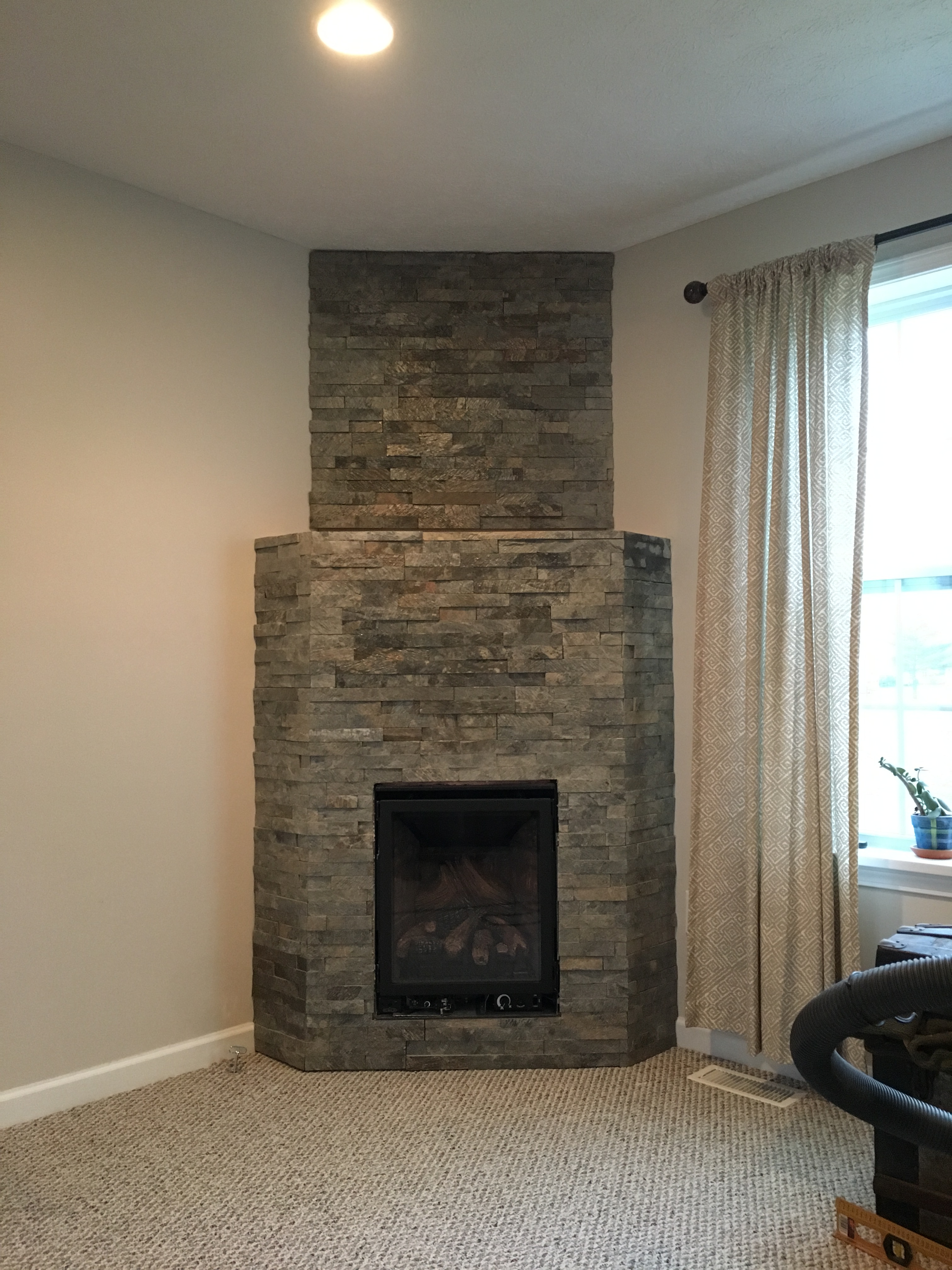

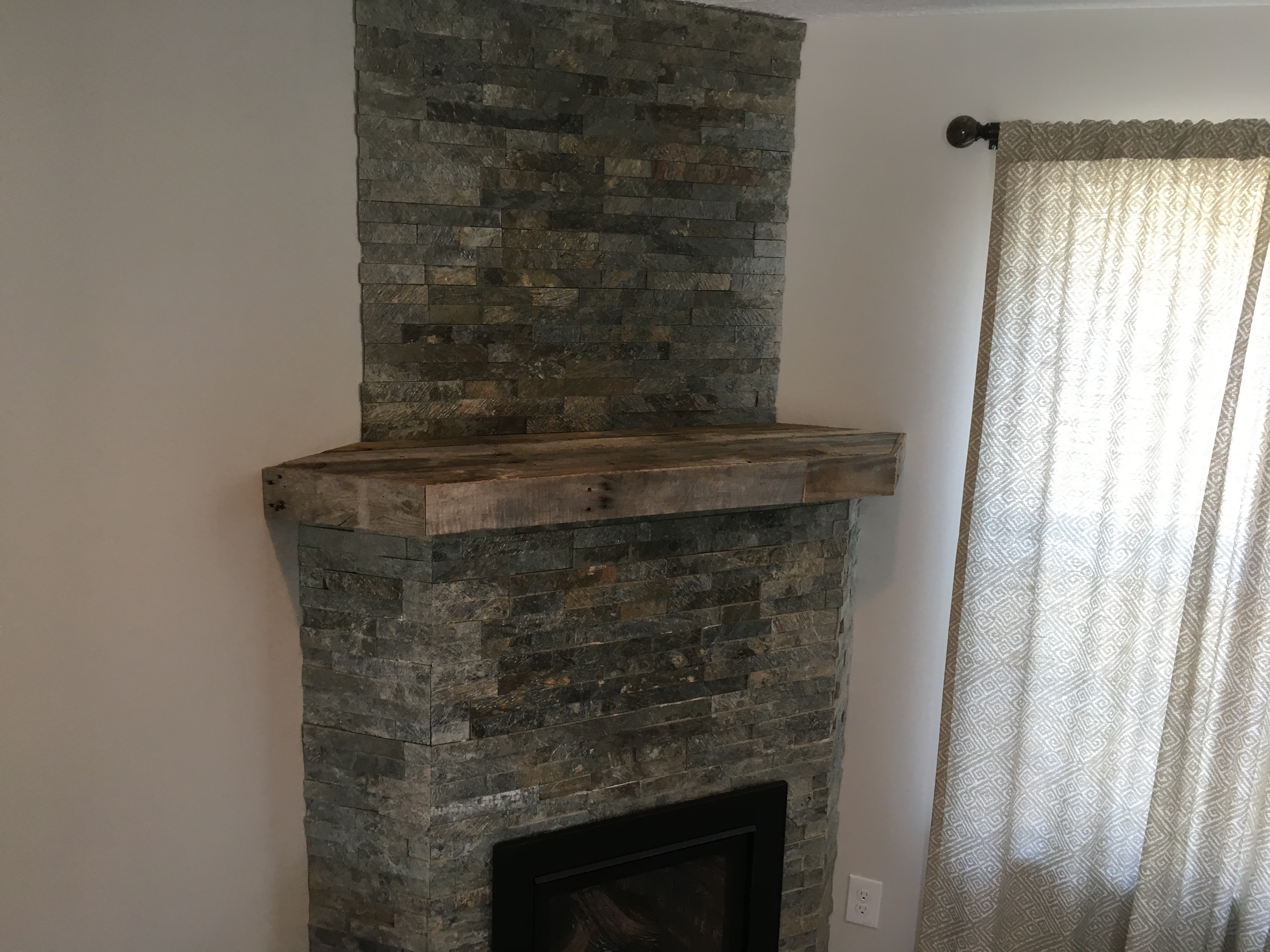

Done!!! Did a corner mount portrait style unit and built a ledger stone front with a recycled pallet mantel.
