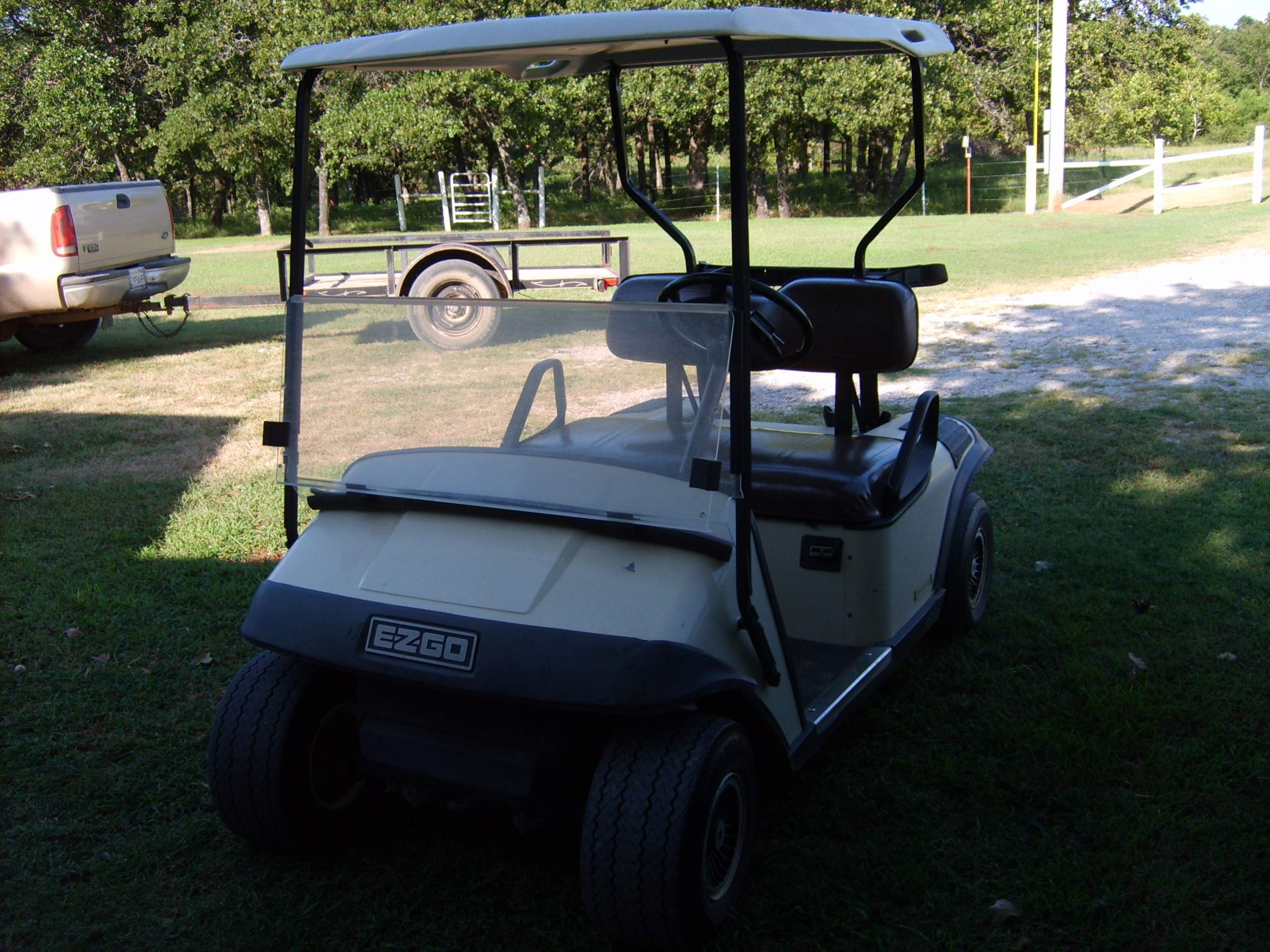

Gale, we were talked into buying a golf cart last year and haven't regretted it a bit! We were looking for an electric and didn't want to spend more than $1500. We came across this one for half that due to the seller just wanting to get the cost of the newer batteries out of it. He was selling due to taking advantage of the government encentives of buying electric cars and all. After he told me he'd take $750 for it, it was all I could do to dig out the cash. Had we waited 10 minutes we might have missed the deal all together! It's a true blessing to us. We've got 40 acres and our shop is about 300 yards from our house as well as we feed in other pastures and it make feeding a breeze. Ours is a 1995 36v EZgo and I'm in the process of adding a bed to the back. I'll probably start a thread on that when I get a little farther along. Anyway, I think you'll really enjoy your cart. They are so easy to get in and out of and quiet. Like others have said and you've found out just keep the maintenance up on them and they'll last.
