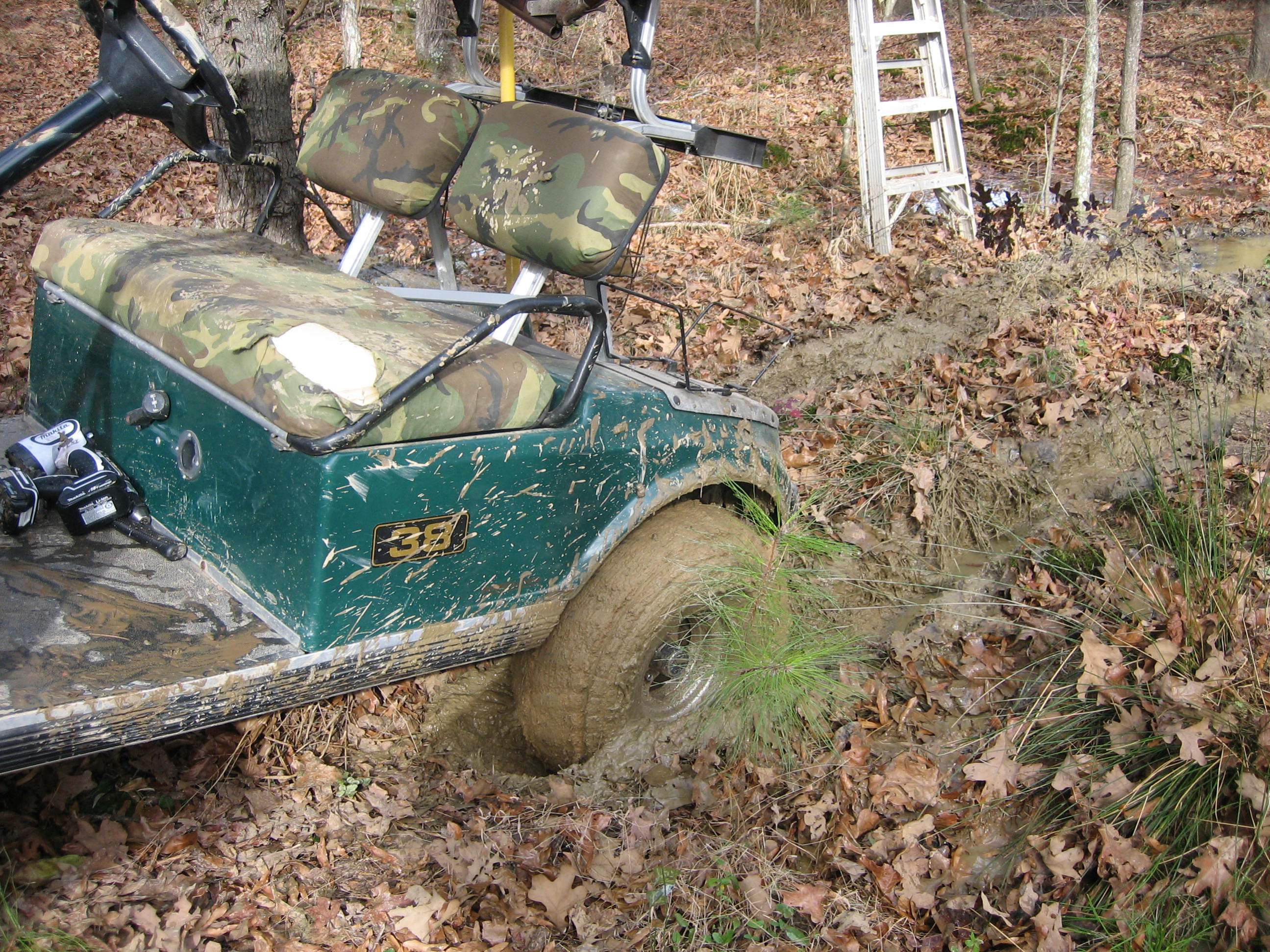

I've been stuck once in ten years, made it though the mud but couldn't quite climb out the other side. I snapped a pic, hung my "no trespassing" sign, put it in reverse and went back out the way I came. Sure made a nasty mess of me and the buggy though.
