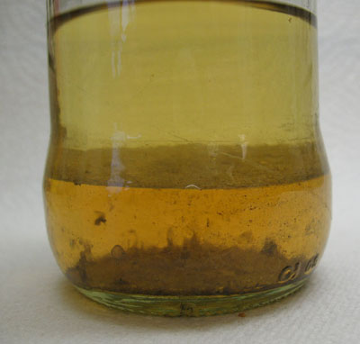

Crud2 in E10.jpg]Ethanol is not only a scam but is loaded with problems:
1. It absorbs water.
2. It can corrode fuel system parts that were not designed for ethanol.
3. Crud grows in it.
4. water absorbed in it can freeze and clog your fuel line in cold weather.
5. It develops less power.
A friend couldn't get an engine (I don't remember what kind, maybe a mower) started after letting it sit all winter. Cleaned the fuel system and it was full of crud. See the pic:
