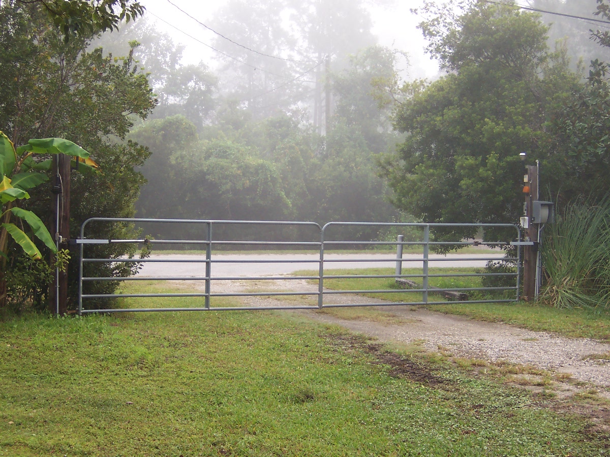

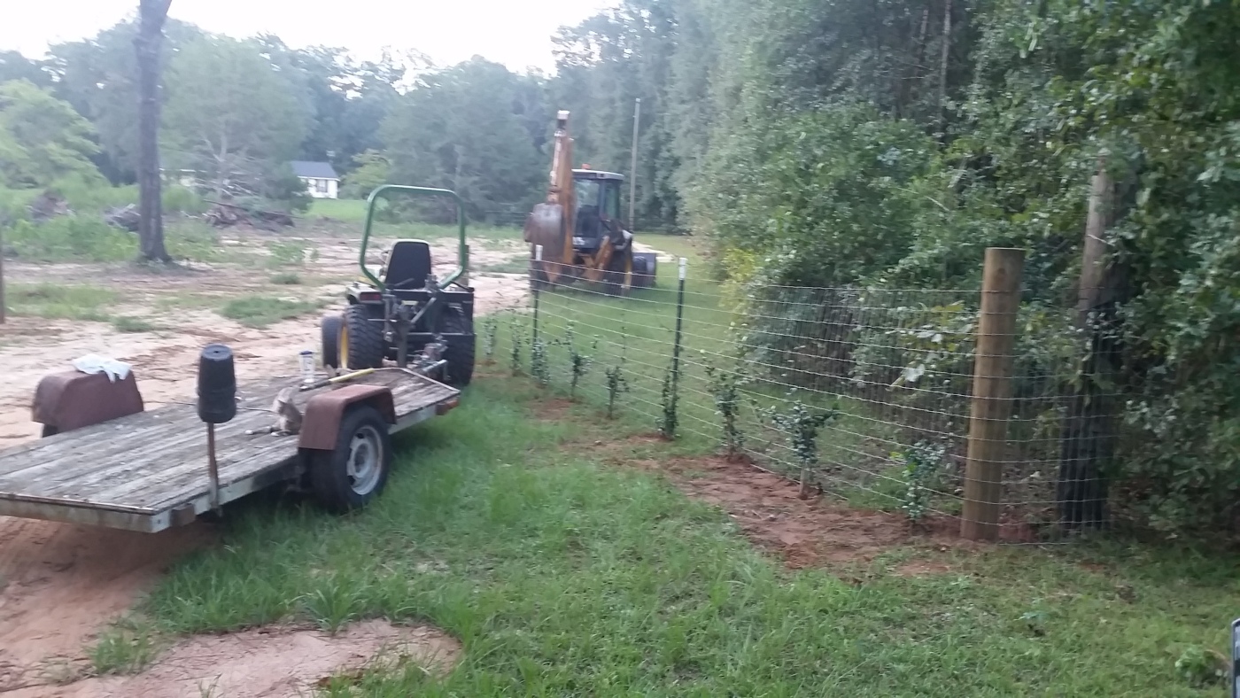

First pic is with power poles set 5' deep with 2 12' gates.
Second pic is 6" posts from local ACE Hardware set 4' deep with 14' gate.
Haven't had problems with either one sagging.
A 6" round has more wood than a 6" square post and most 6" square are only 5" X 5".
