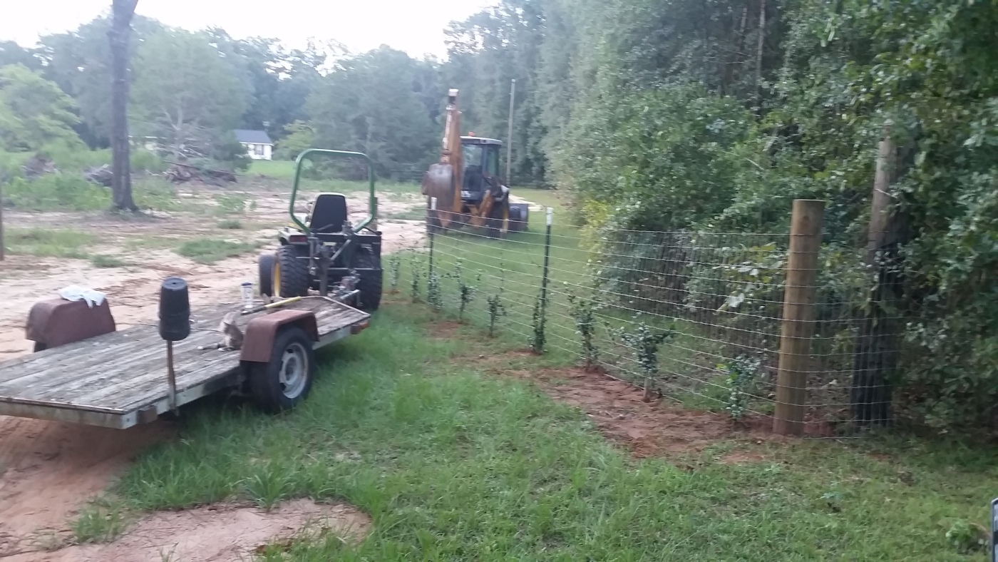

I bought some fence posts from TSC and I think they were 8-9". They were fairly straight and super sturdy. I bored the holes with a 12" auger and tamped dry concrete and dirt around them. I've been told the concrete will absorb moisture from rain and set. They are solid as a rock either way. I hung double 10' gates so they don't have much weight on them.
   / Gate post/fence post #12
Ok so cement or just tamped? The first pic are they 6x6? I personally like the look of square. Se likes round. So you know we are going round unless I have a "scientific" argument that square is better.
All the posts are just tamped down as I kept them level.
With the depth I set them I don't think concrete would make a difference.
I always paint a depth line on posts before I set them to make sure I get them deep enough. You can knock dirt in the hole and come up short.

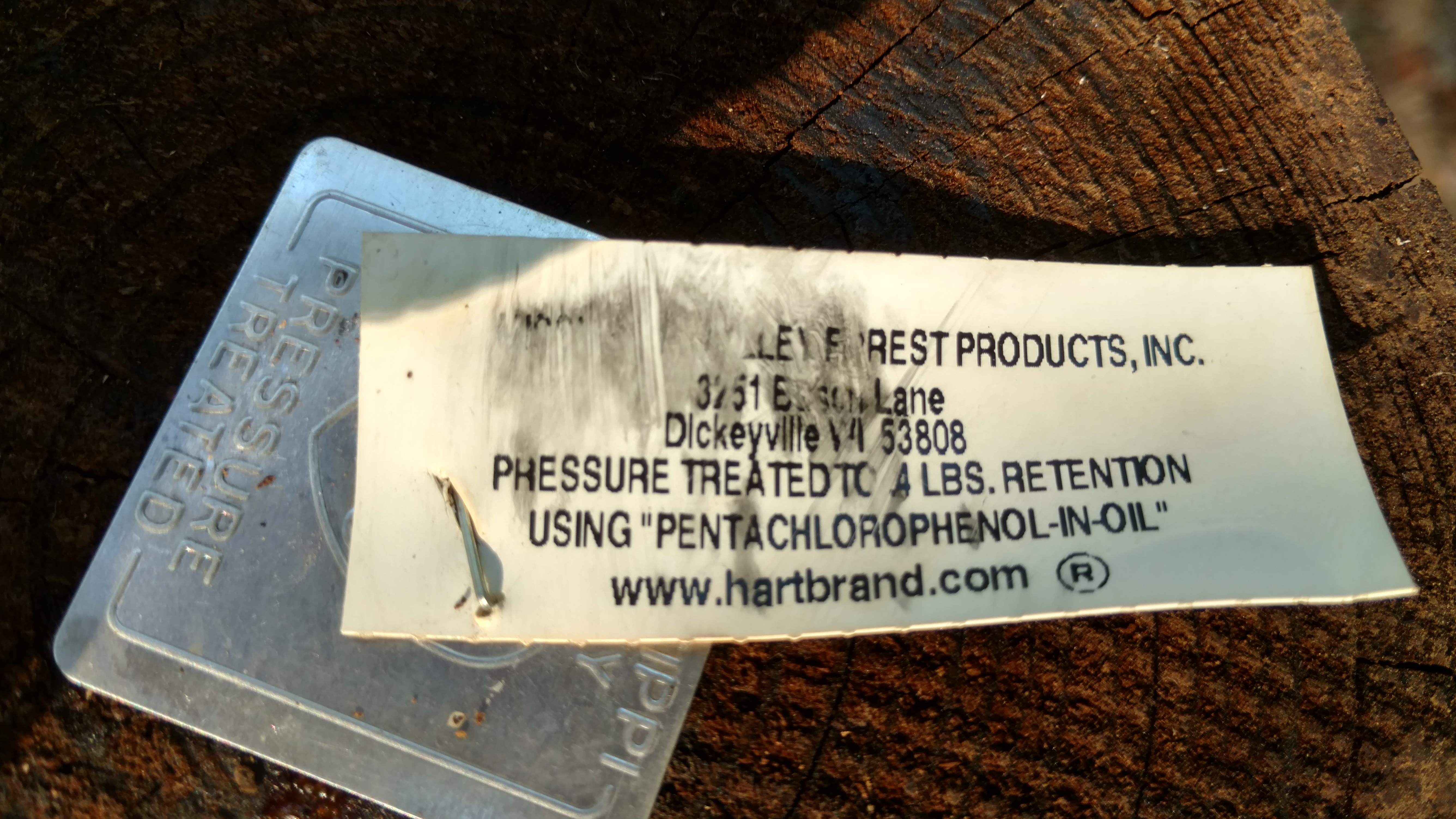

Does any one know what preservative retention TSC has in their posts? I cannot find anything on their web site that tells me that. SWMBO is pretty much insisting on round. It looks from the discussion here that there is no real difference between round vs using a 6x6. Of course that assumes the preservative retention of both posts is the same.
I will have to do some digging to find local lumber yards that have round posts. The big box stores (where I can see their inventory on line) do not seem to carry them. We have several lumber yards in town that I am sure will carry them. They just don't have good on line inventory systems.
The GC stuff carried by Home Depot seems to be treated to .40.
