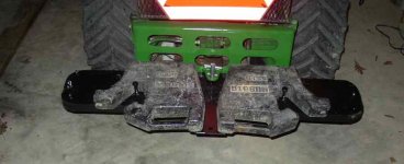

Clint Blake has filled his rear tires with I think antifreeze/water mix. He seems very pleased.
I have two weights on the hitch pin each is 55 pounds. Most of the time I only have one in place. It makes the machine move much better when the bucket is loaded, since the rear wheels will spin when they are lightly loaded.

I feel that the weight on the rear (110 pounds) has made the PT422 feel like a different and much better machine. I don't see how adding 110 pounds on the rear is much worse that carrying 800 pounds on the front.
