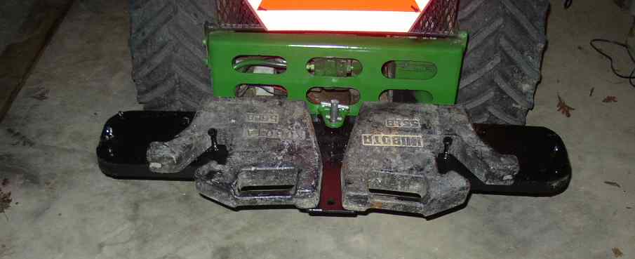

What are you using for those 55lb weights? Can you post a picture? Are they available at TSC, for instance? I like the idea of being able to put one or two on the hitchpin as necessary, and then use neither most of the time.
Phil
/ Gate Post Removal
#22
I bought a couple of 55 lb weights from a local Kabota dealer. I made a bumper to support them. I have attached a picture. Not visible is a second bolt with the head cutoff through a hole in each weight. A hole in the bumper (a 2 X 8) is reinforced with a steel plate.
Bob Rip

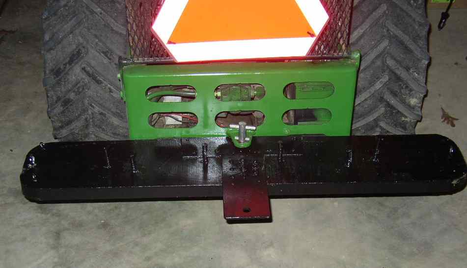

Attached is another picture which shows the bolts if you look closely.
The hitch pin goes through the steel plate and the wood of the bumper.

/ Gate Post Removal #24
<font color="blue"> I don't see how adding 110 pounds on the rear is much worse that carrying 800 pounds on the front.
</font>
Because now you will try to carry 900 pound on the front. /forums/images/graemlins/wink.gif
/ Gate Post Removal
#25
Good point, but the relief valve will kick in. I guess we will all wear our the PT in different ways, some from turning the tires around and some from weights on the tires. /forums/images/graemlins/smile.gif /forums/images/graemlins/smile.gif /forums/images/graemlins/smile.gif
Even when not fully loaded the weight helps by keeping some traction on the rear. Carrying a 500 pound load limits my ability to back up a hill since the rear wheels start to slip. The extra weight prevents that. Maybe I should just buy a 1430.
Take care, but not all of it.
Bob Rip
