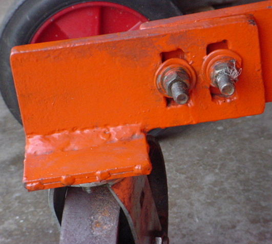

JoeL: I really like the York rake; it looks like a great tool, but at $3,500 with the blade and wheels it's more than I want to spend. I like the way they did the caster on the wheel mounts. The only good, big casters I've seen are for scaffolding and they are pretty narrow where the Yorks are very wide.

Ken,
Here is a little more detailed photo of the adjustment slots. Pretty crude I guess..... but works

BigDad: OK, thanks! It looks like it a better solution that what I was going to do!

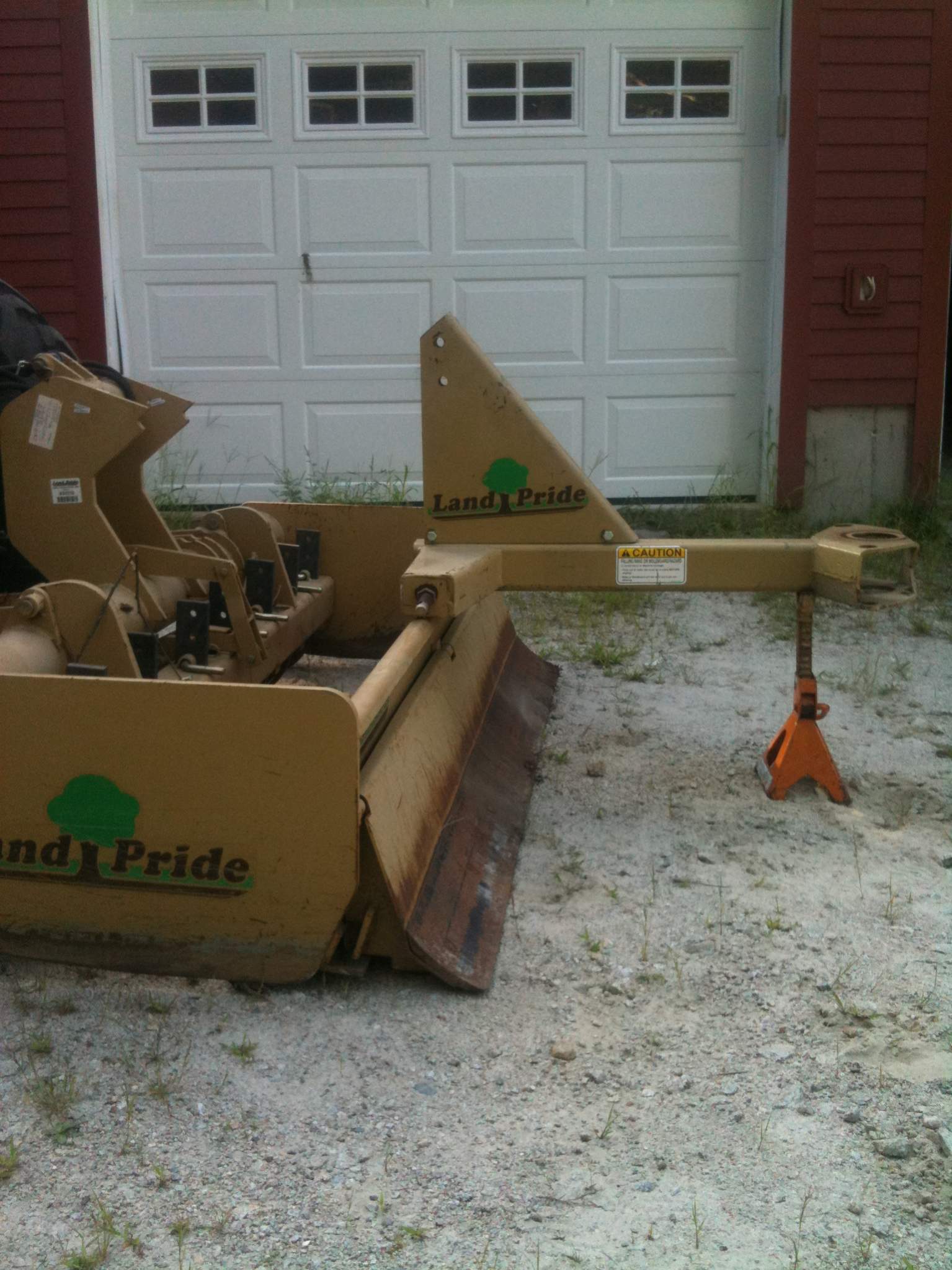

Some good ideas on here so far. I also want to add a gauge wheel but I want to put it on my box blade. I want to have a single tailwheel design.
I also plan to have a heavy duty rear blade some day, and want to be able to use my gauge wheel on it. I'd like to keep the option open to easily move it to another implement.
I am planning on adding brackets to my box blade (and whatever other implement I use it for) to hook in a standard 3pt hitch type implement. See the pic for a good idea of what I mean.
Another reason I want to do it this way, is because my trailer is 18' long, and just barely big enough for me to haul my box blade, tractor, grapple, and regular bucket. If I want to take my landscape rake, I can attach it to the box blade (like my gauge wheel would normally be) and fold it up vertical and secure it for transport. This way I can carry an extra implement. I couldn't take anything large or very heavy this way, but for the landscape rake I think it will work well.
I also want to be able to fold up my gauge wheel out of the way, I want to use a hydraulic cylinder to control the gauge wheel in much the same manner as the hydraulic top link controls the box blade. However it would be easy enough to just add a standard manual top link for fine adjustment as well.
This is a spare 3pt frame that I've had laying around for a while. I think it will work well for my purposes, I'll attach the single wheel using a bracket where the rake (or blade, or whatever was on this) would normally be mounted.
