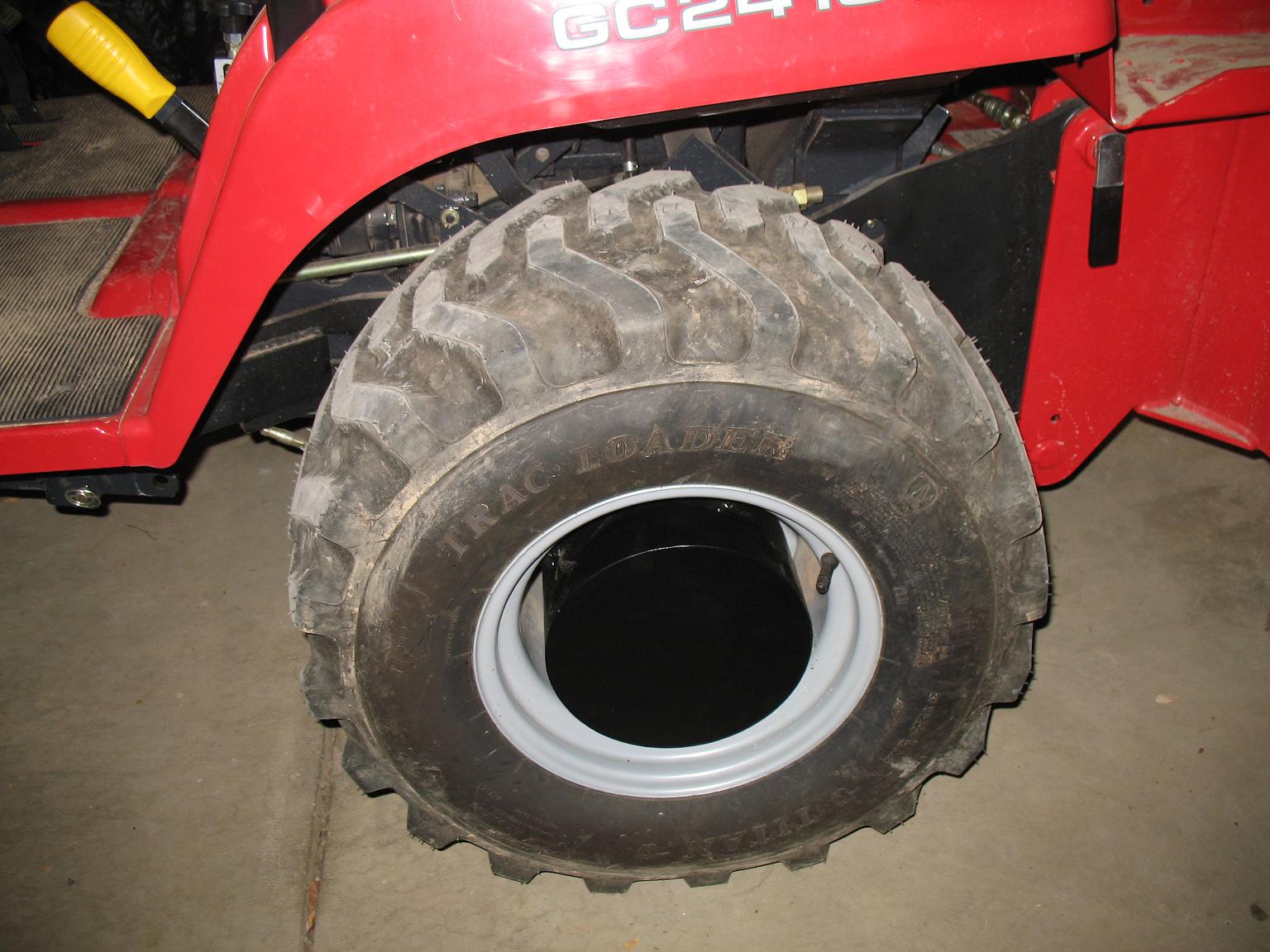

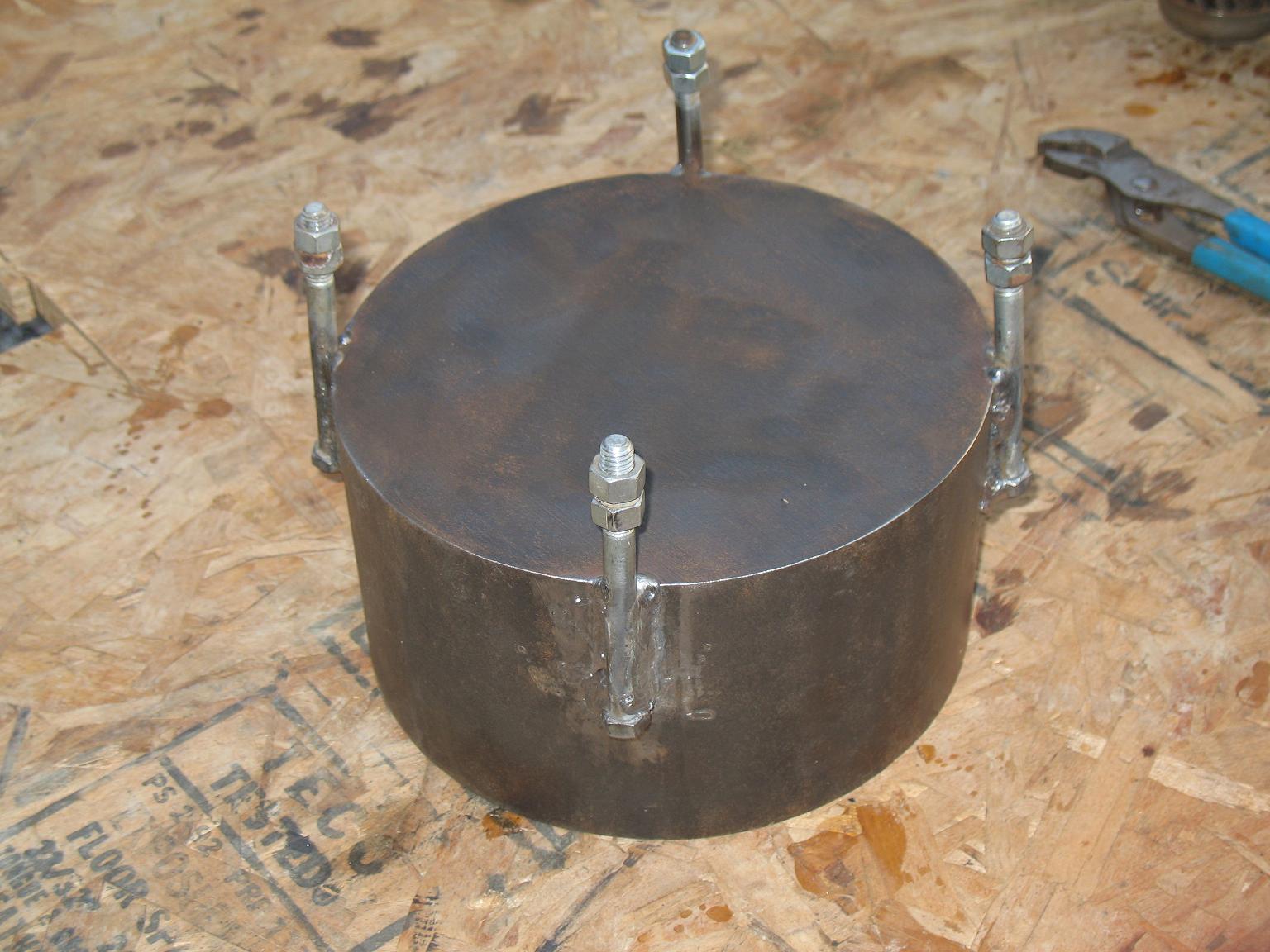

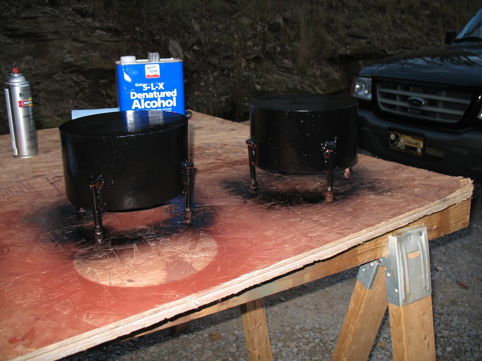

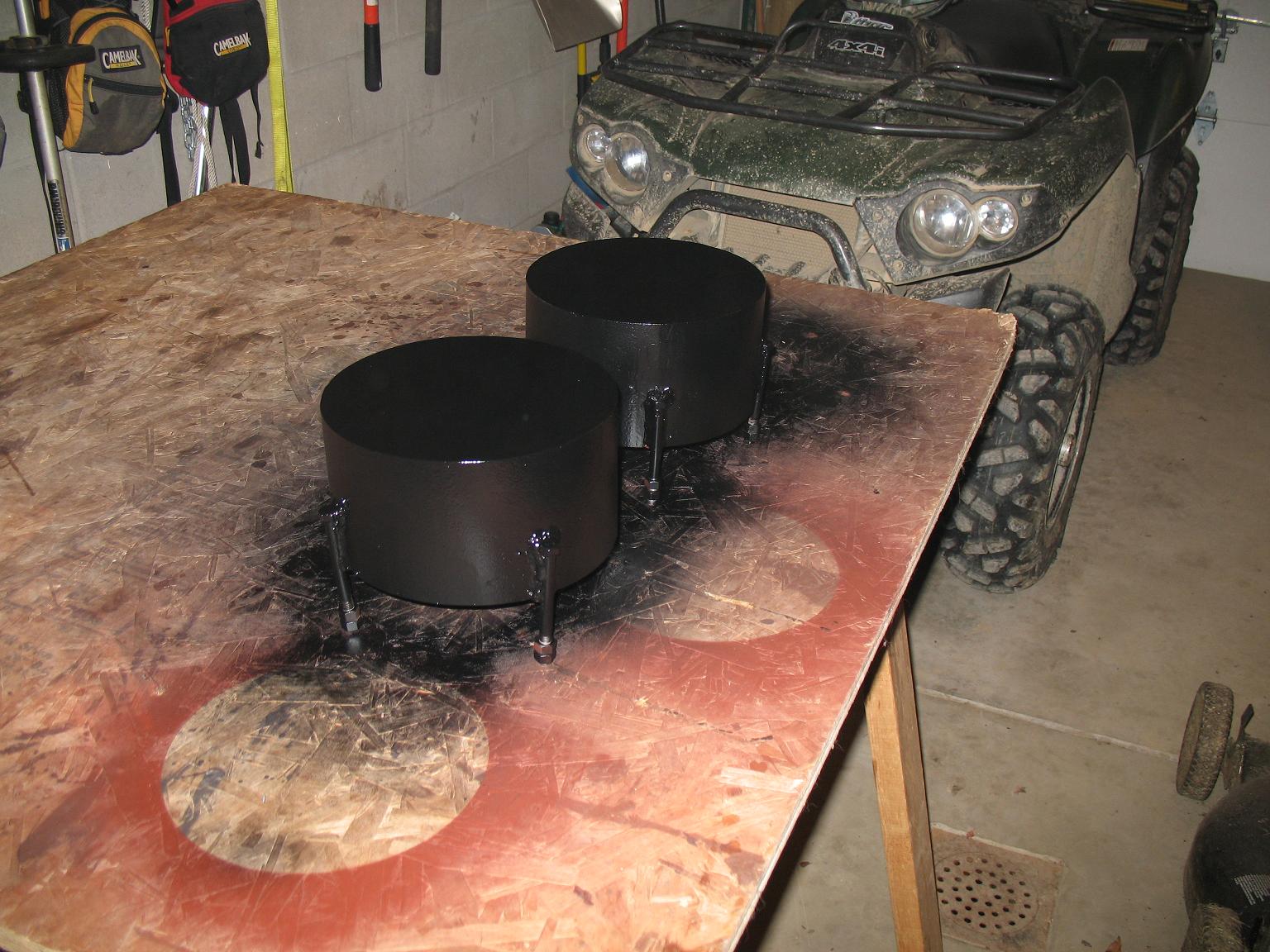

Here are some wheel weights I made for my MF GC 2410. Nice heavy chunks of steel, some Grade 6 bolts, a little bit of help from my Uncle stick welding them up, some primer and paint, and there you have it. 74 pound (each) wheel weights. I had to bend the bolts inward slightly (as seen in the pictures), but other than that, they bolt right on to the wheels.

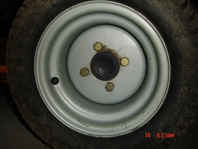

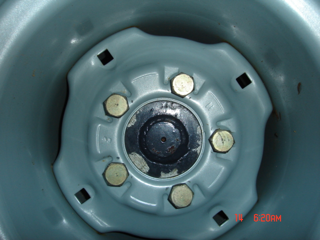

Neat-- when I saw your other post, I started looking for this one.... I could use this idea on my fronts; the BH weight on the rear seems plenty on that end, but the front gets a bit light going uphill when blowing snow.
I take it you used the square holes in the wheels to mount these things.... Has anyone figured out a way to do something similar to the fronts (which have no extra holes:()?
Drill + Drill Bit = Holes :D
I don't see how your going to get enough weight in such a small area, to make any difference. There is a weight bar on the front of my 2310, If you have one, it would be a lot easier to just hang the weight from there.

I was thinking hat the fronts didn't have quite enough clearance behind the center wheel disc, but it does look like there's the better part of an inch between the outside of the axle mounting flange and the inside of the wheel rim, so a drill isn't out of the question.... I see a possible project in the making.
The front "bumper" would be the logical choice, but the front mount quick-hitch business for the snowblower effectively prevents that option: that's where IT hangs. (Hmmmm... maybe add weight to the quick-hitch frame?:rolleyes:)
