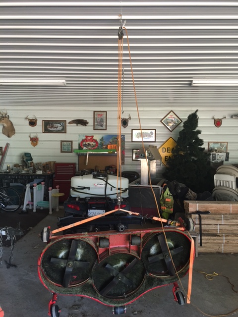

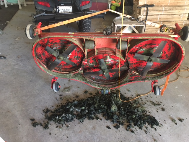

Got my 50 hour service done this morning. I went with the Permatran 821 hydraulic oil, and massey engine oil. My engine oil was black, the hydraulic oil looked fine.
Thanks rider for posting the mower deck up in the air, inspired me to do the same, except I used my deer hoist instead. My mulching deck had an inch or so of "mud" caked on the underside of it. Cleaned it up pretty good, and let it dry out.

Looking good. I need a mulching deck!

Scut 4 big bucks . . . on several other threads I wrote about the benefit of using a spray polymer to greatly reduce any buildup on mmm decks and blades and similar. Its especially true with mulching decks of all kinds.
Note: a spray polymer is a superior product. Its not "pam" or wd40 or teflon sprays.
