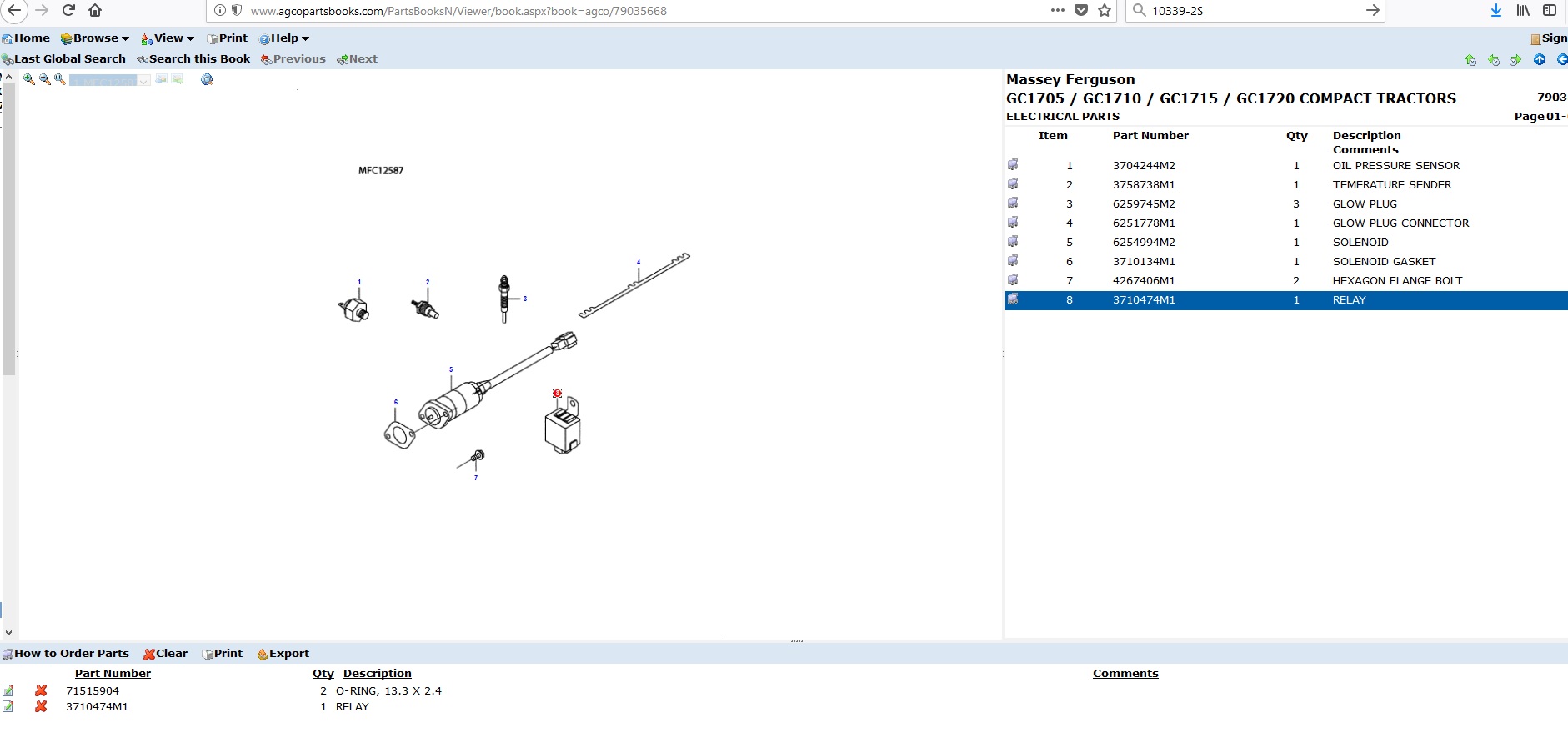

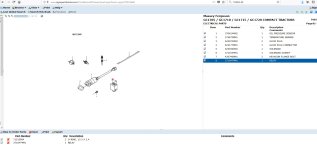

The parts book lists the relay on the same page as the solenoid, but gives no description of its operation. 3710474M1 RELAY.

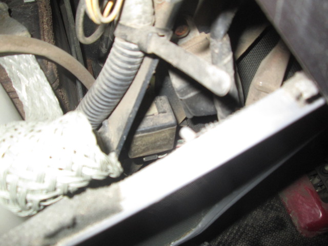

It is located under the dash on the left side.A black 2"x2" box. I have no idea how to test it, except by removing a battery cable if the tractor doesn't start. The solenoid has to be energized to shut the tractor off. With no power, and if the solenoid is moving freely you would hear the click when it shifts open. I am making an assumption that the relay is a timer for the solenoid, I could very well be wrong.
