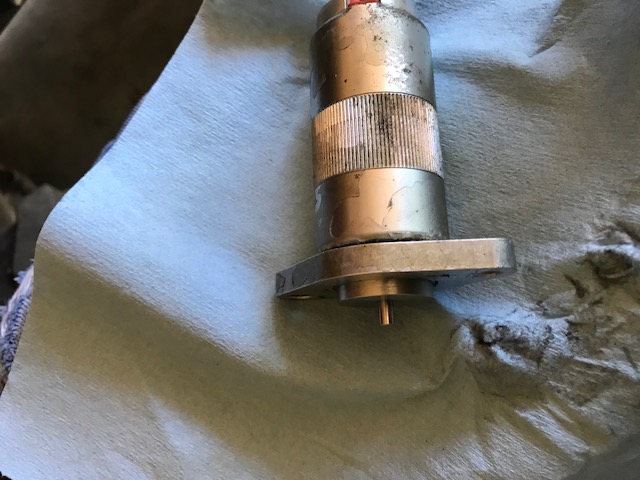

Acted up on me a few times today, I decided to remove the solenoid, there was some oil in the housing on the pump, the shaft looked fine, moved in and out freely, every time I pushed the plunger to move the shaft back out, there was oil on the shaft. I assume there is an O-ring in the solenoid that stops the oil from coming out with the shaft. I did look at the relay and all looks fine, I inspected the electrical connection and it looked fine. I do hear the relay click with the key and I hear the solenoid 5 seconds after I turn the tractor off click so I'm ruling out the relay.
I am safe to say I need a new solenoid and gasket?
Pumpguy, is it normal to have a little oil on the pump and shaft where the solenoid is mounted?
For $180 I'm thinking about taking the solenoid apart to see if I can fix it if the oil in there is normal.
Why is there a gasket between the solenoid and the pump? Is there suction?

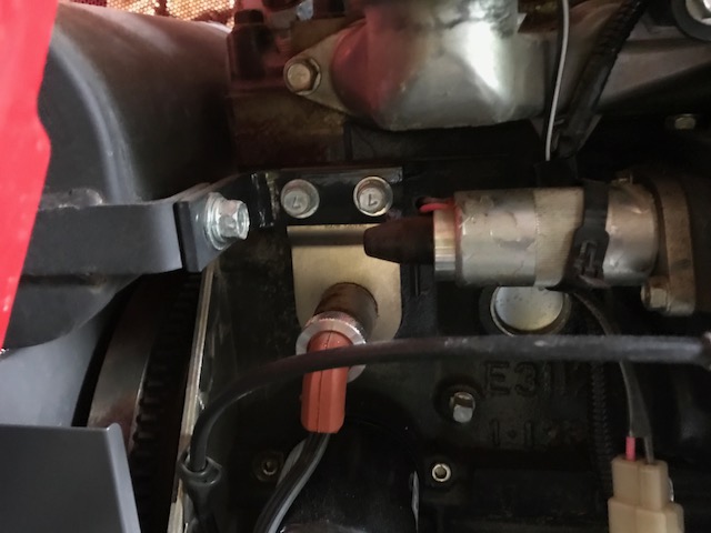

It's an idea but I hate to mess with mine.. LOL I just went out and put my hand on the solenoid and turned the key on and off and I could feel it working. I assume the plunger inside the rubber boot isn't actually connected to the shaft that goes in and out because it never moved.

#25
What is this small drain on the boot for? Is there an electrical timer of sorts that controls iner winding?

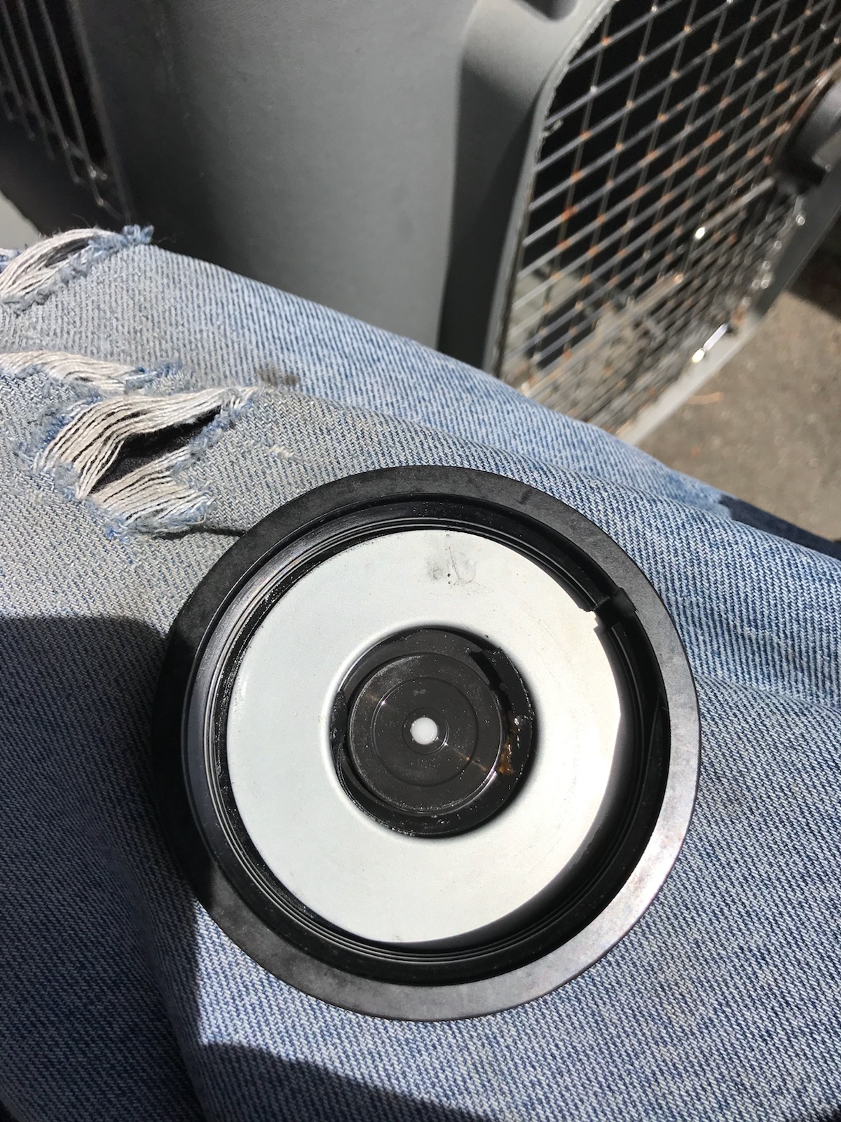

Took the fuel cap apart for the heck of it, I have a mangled seal in there.
I don't know, if the solenoid isn't supposed to have any oil on the shaft when you push it in and out I guess I'll buy a new one, if it's normal I am at a loss as what is causing it to not get fuel to the injectors right away.
I will completely remove the solenoid and see if it starts right away, if it doesn't I guess the rack is getting stuck. If I need the pump looked at pumpguy, is it something you would do?
