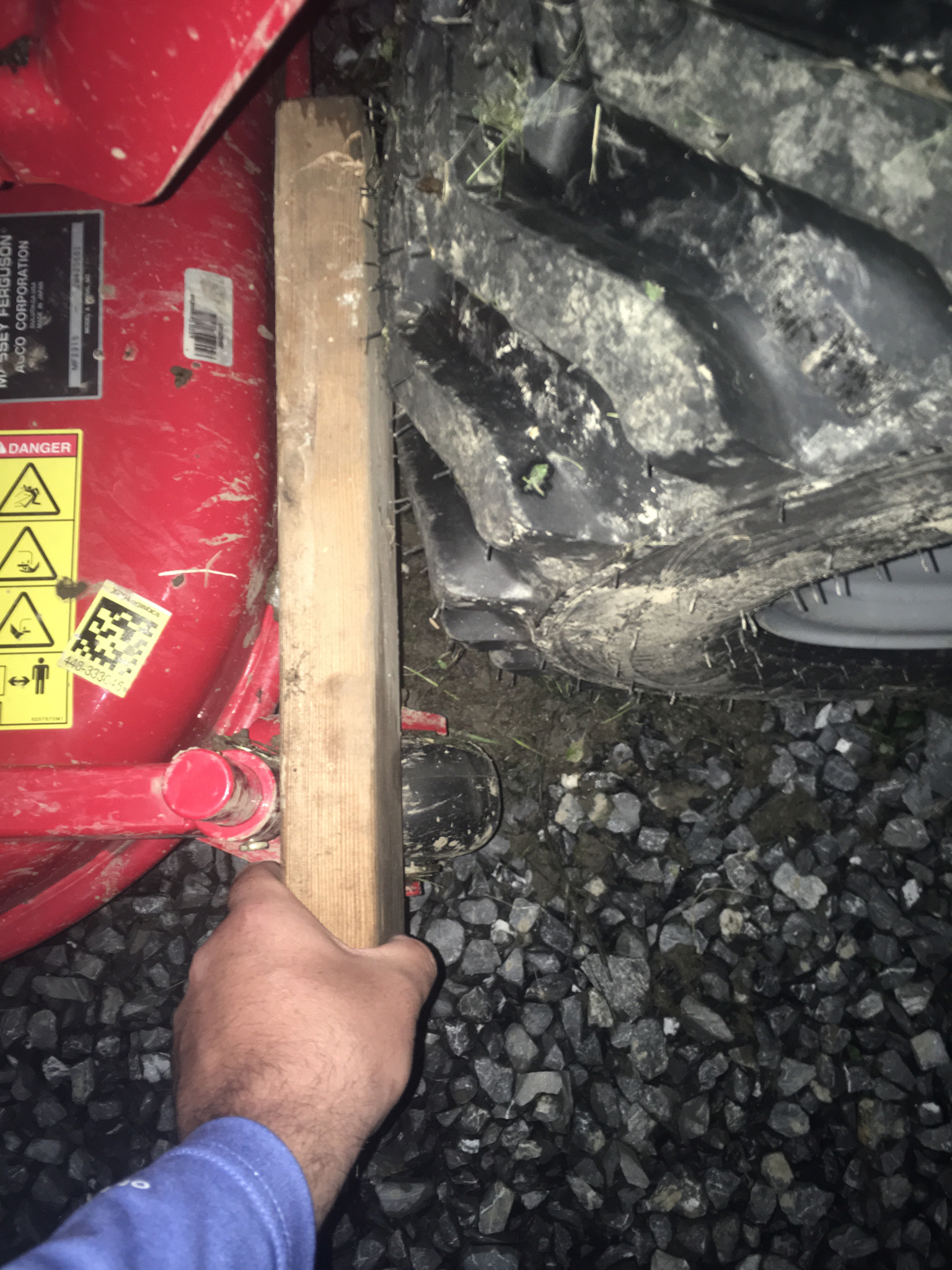

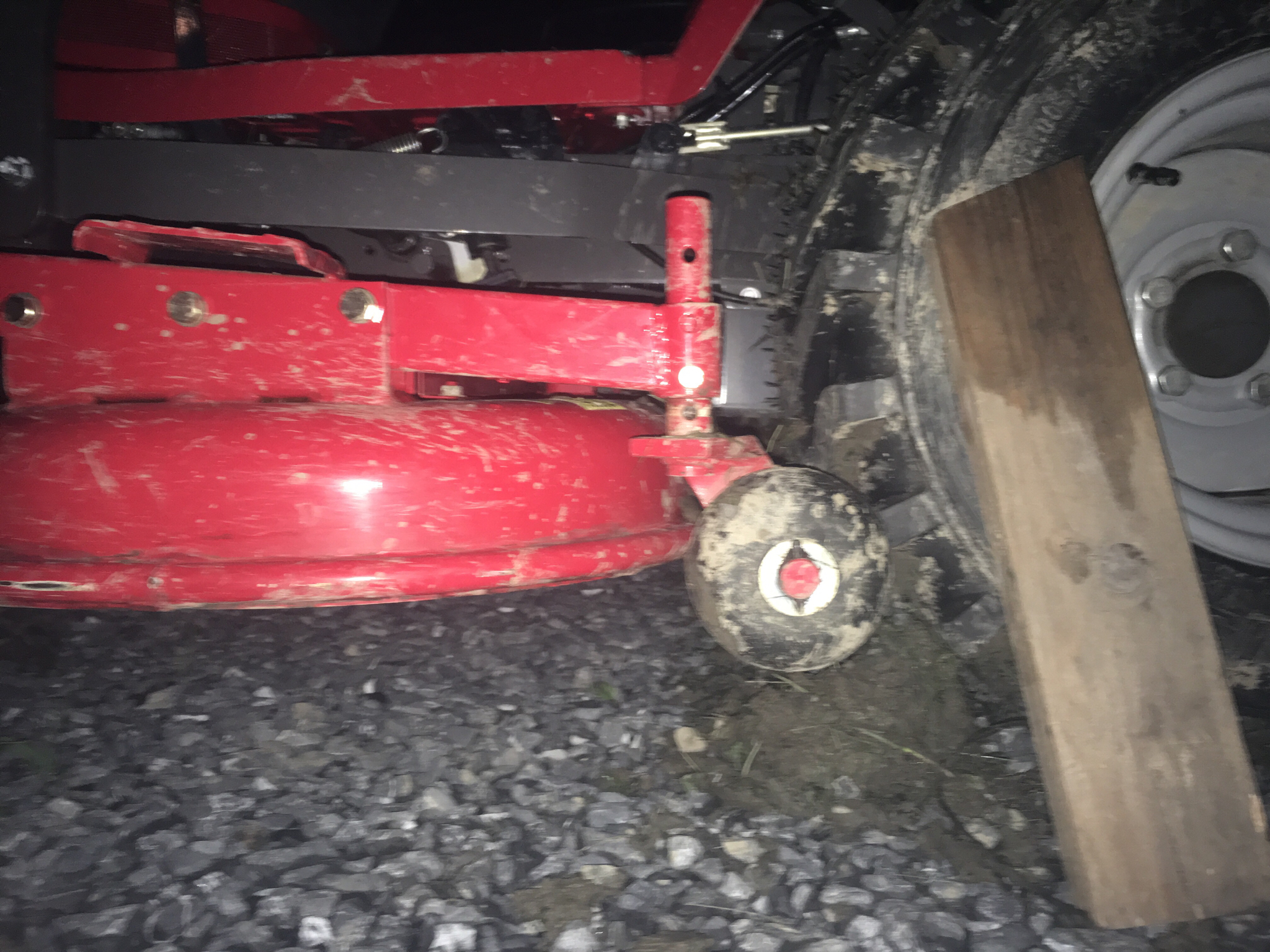

I went and grabbed a piece of 2x4 and took some pictures and measurements. Here is what I came up with, if I did this wrong let me know.
Greetings Chad,
Well, what you are showing maybe could work for measuring - but it isn't what I was thinking of. More importantly - you seem to have your rear deck wheels set much higher than mine and maybe its just the pictures - but your rear deck wheel seems to have less space to the tire than does mine.
As an example - my rear deck wheel on the right side is about 2 inches further out than my tire and it is set forward more. Now granted if I raise the deck up to its fullest height - that effects things some.
But the idea of the deck wheels is to have them set for just above the height of grass height you want because the deck is a suspension deck. Then you raise and lower your deck for fine tuning. It almost looks like your deck wheels are set so lowering the deck would cut it down to maybe an inch high. I don't know if turf tires are narrower than yours - but it seems like I have more space from the camera angle you have. Essentially - you want to be able to raise and lower your deck with your hydraulics - so that the roller wheels or brackets don't hit the rear tires.. then you measure outside the side of the tire to see how far out you'd still have clearance. When my deck is all the way down I'd have more clearance than when I'd pull it all the way up. And because the deck wheel sticks out further than everything else - I wouldn't want the deck wheel adjusted to the very very top.
Its raining now - but I'll try to take some pictures tomorrow.
I was thinking of having a 1 x running 90 degrees different from your's (in other words going in the same direction as your 2 rear deck wheels. Then you can see how close

3) I'm using very large turf tires and it looks from the picts that you are using ag tires or maybe industrial tread. You probably will have more space than I do because of tire type if everything else was equal. Your worst-case will be with the deck raised. As was suggested, run a 1" board or any handy straight object across the back of your rear tires , between the rear tires and the deck wheels. With that board in place, does it clear everything or are the mower wheels too far forward to even get the board in there ? If the board clears, even while you run the mower deck up to the highest point, you'll be OK running the rear tires out as far as you like. In other words if the mower wheels are too far forward, then at some point you'd have a conflict trying to widen the rear tractor tires. I think you can see that but obvious things are often hard to describe in English.

I'm thinking my industrial tires are bigger than your turf tires. I tried to put a 2x4 next to my rear tire and it will hit the tire on my mower. I took some more pictures. Let me know if this is wrong and I'll try again lol

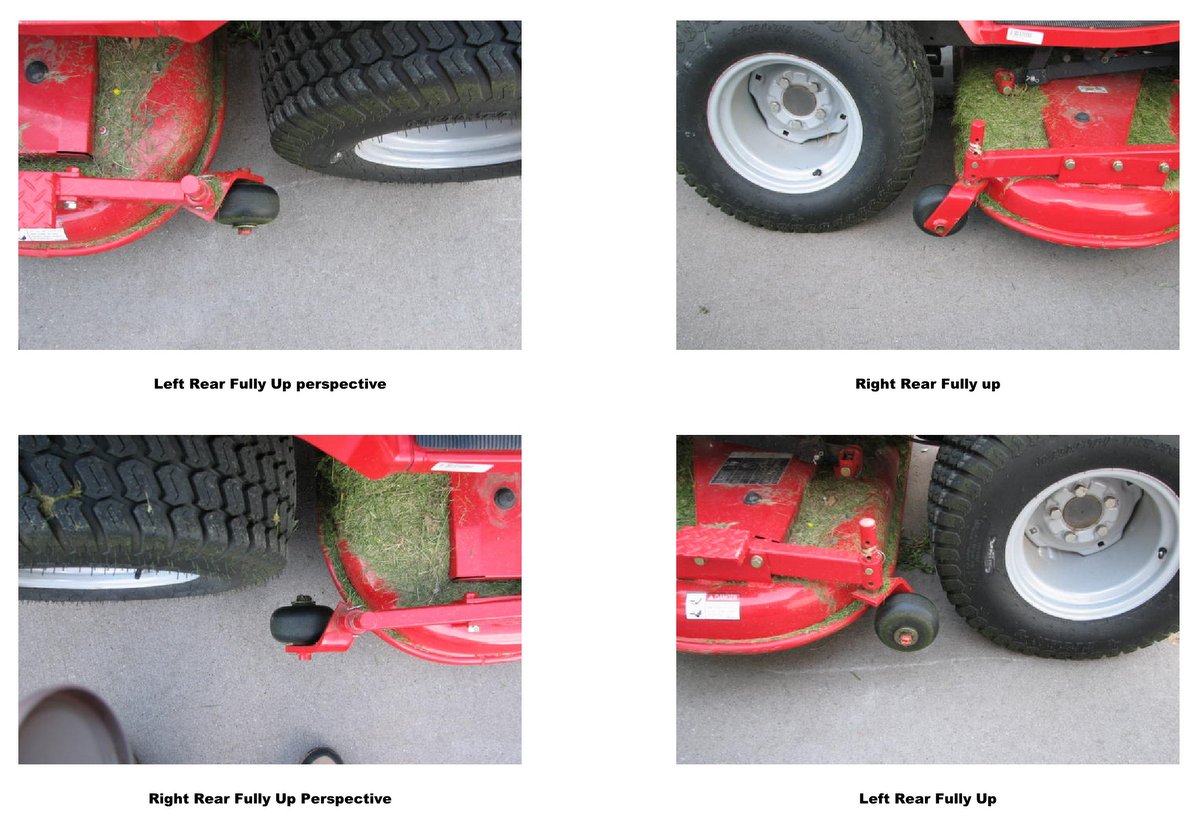

Here are some pictures of my deck showing the deck resting on the wheels on the ground and at full up position. I also took shots showing where my pins are set on the wheel brackets - and the gaps to be considered when choosing spacers. All photos are labelled for direction and position.

The rear turf tires on my GC1715 are 12 inches wide and 24 inches as a diameter - they are not worn. (yes, 24 inches - I measured 3 times even though the tire sidewall says 26 x 12 LOL
AS far as the u shaped front attachment bracket for the deck - I have 1 inch of threads exposed.

My industrial tires measure 25.5" x 12" tread width to closer to 13" to outer sidewall.
My mower deck has the same 1" of threads showing in the u shape bolt in the front.
