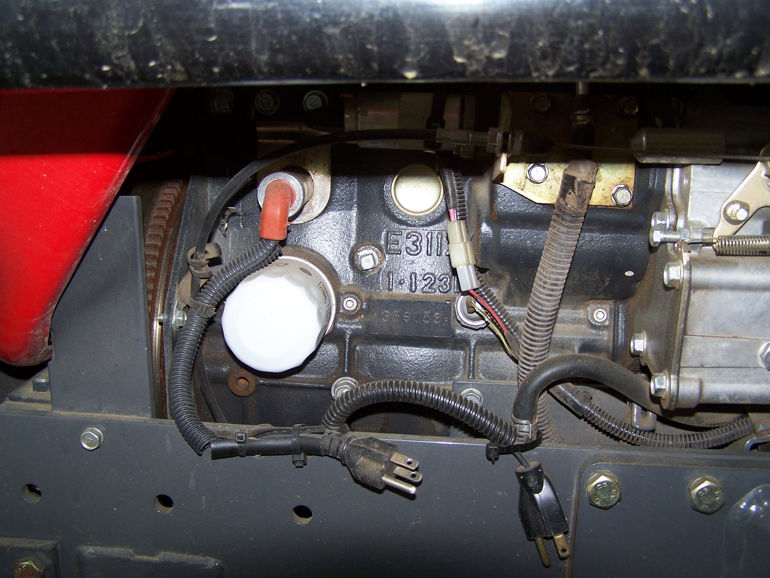

Where are the block drains can maybe you take a pic? I think I know where it's at I just want to be sure.
I think it was the square bolt to the right of the oil filter.
I don't understand, so that has to be drained as well, not just the radiator and overflow tank?

Many engines will hold as much or more coolant then the radiator does.

Removing that plug drains the coolant out of the block around the sleeves so you're getting a more thorough draining of the complete system

Gotcha, thx.
