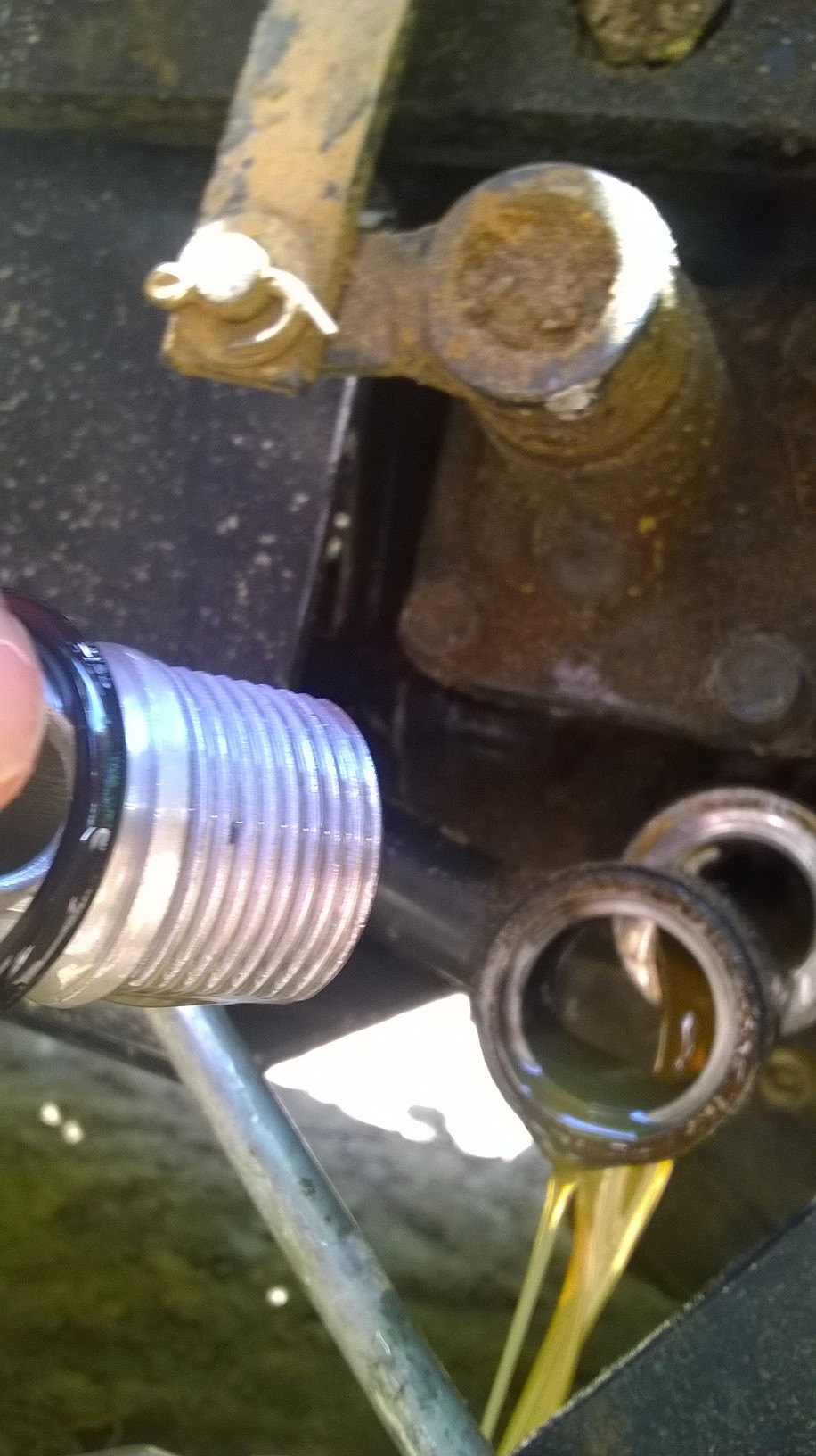

I checked quick disconnects and checked several fittings for hoses I had recently replaced. Everything seemed fine.

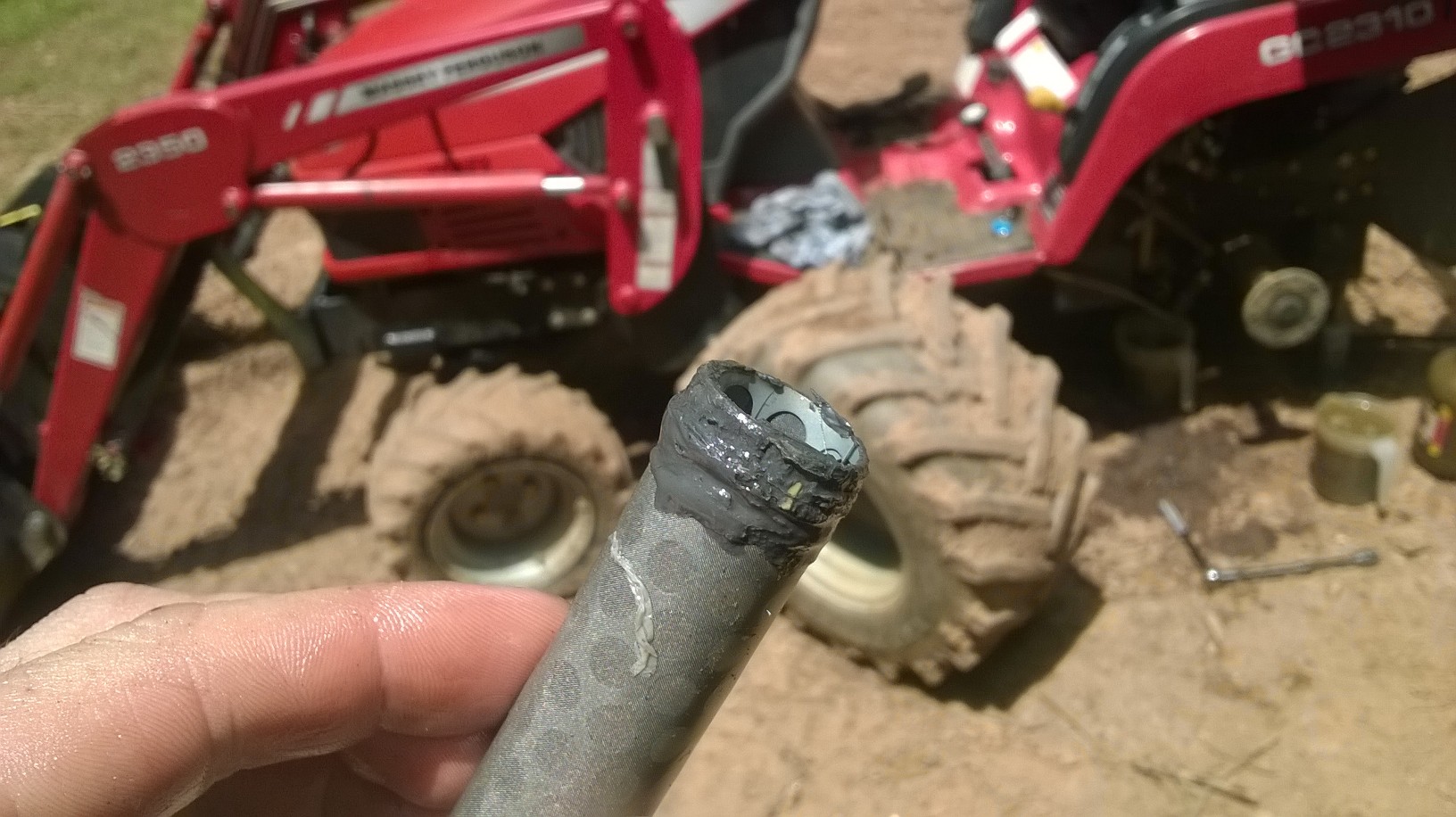

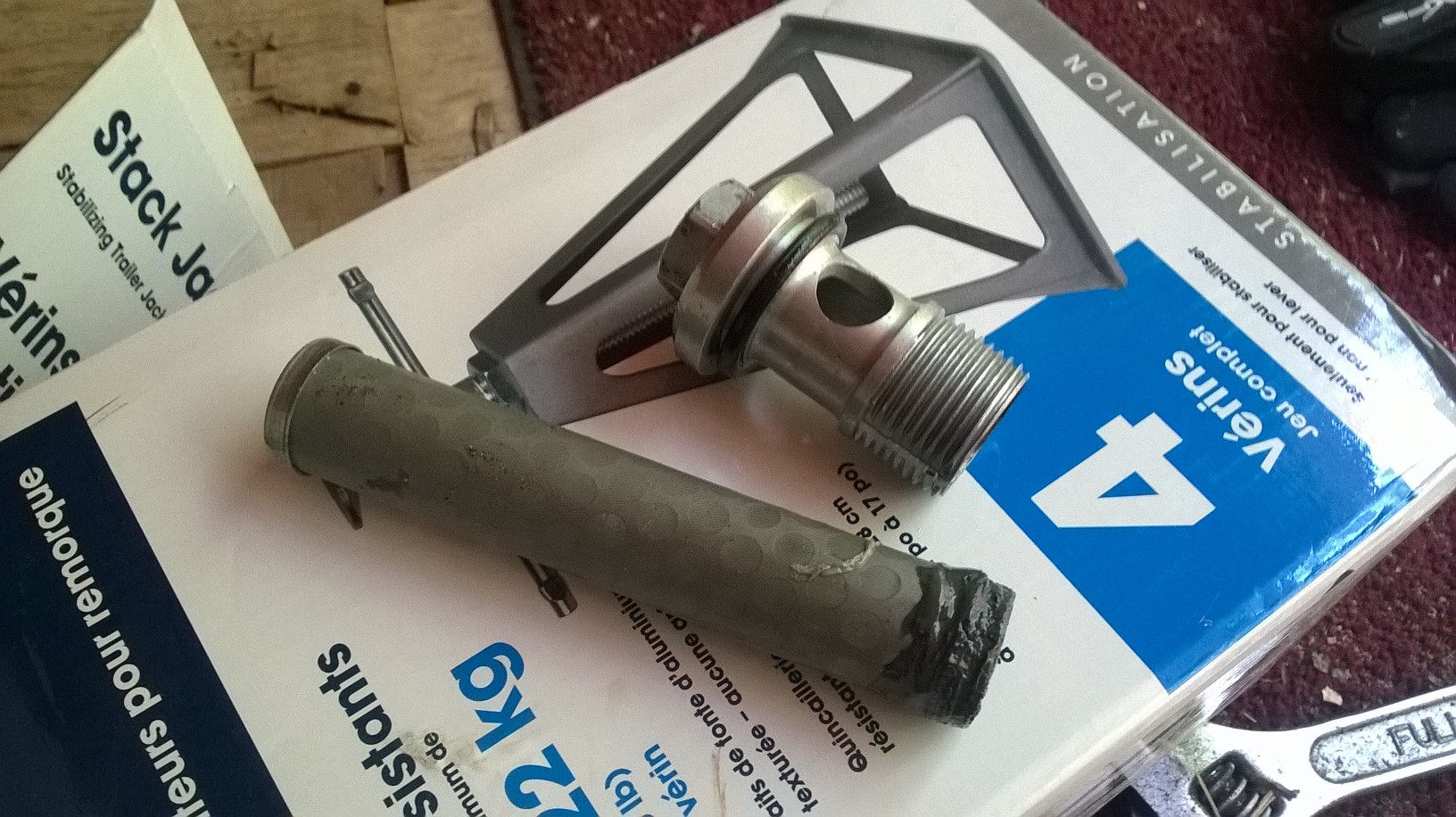

I removed the suction filter bolt. The suction filter had become detached, and was kind of floating around in the chamber. It looks like the previous owner had broken it somehow and tried to fix it with JB Weld.

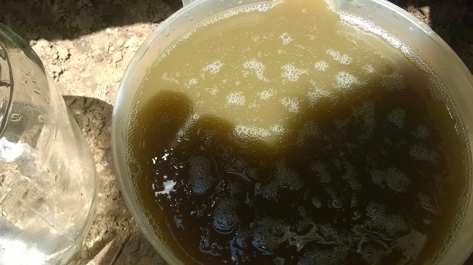

I let all of the fluid drain out and then put the bolt back in until I get the new suction screen from jacks (part 4265208M91) ... The fluid had lots of little air bubbles in it.

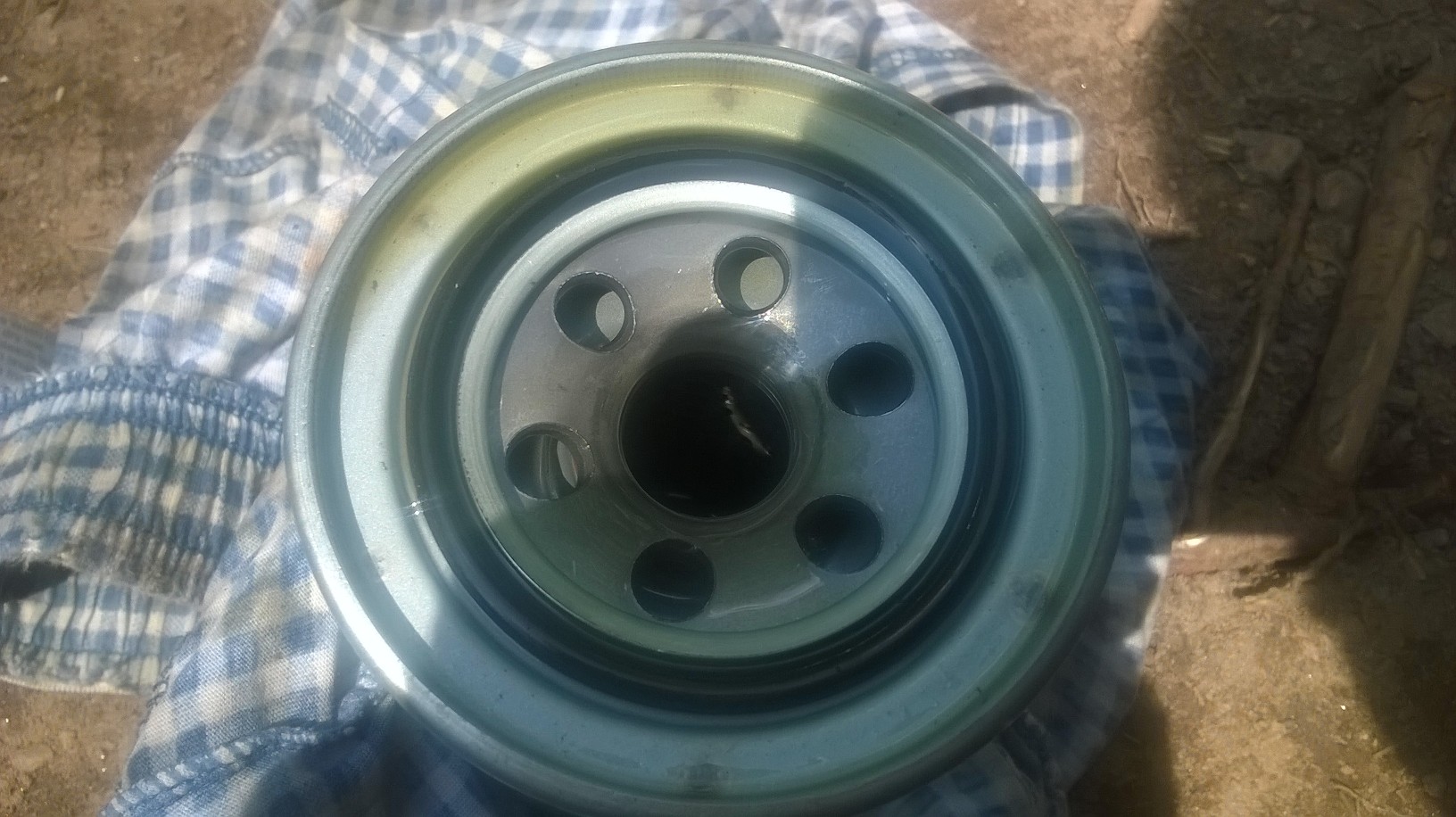

I also took the hydro filter off and let out another little bit of fluid. The inside of the filter looked clean. I think the end of the filter had imprinted "DK11".
I'm still not 100% certain the suction filter contributed to the issue (even though it should certainly be addressed) ... I'm thinking the JB Weld signifies the previous owners willingness to cut some corners, and likely the fluid is just under-spec. Is fluid foaming common? Is there any way to quickly test the fluid to determine the type or the presence of an anti-foaming agent? I'm not crazy about driving an hour each way to my dealer for permatran ... but I will if necessary.

In your picture of the strainer plug/suction line, I believe there is an o ring that fits between the tractor and the suction line (can't really see in picture), and another on the plug that goes against the suction line.
Don't worry about any oil left in the cylinders, it will have a negligible effect when you refill the reservoir.

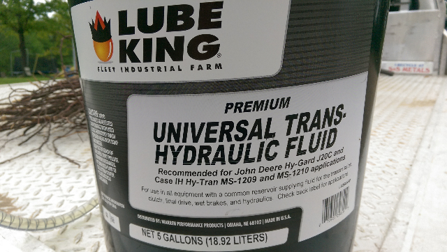

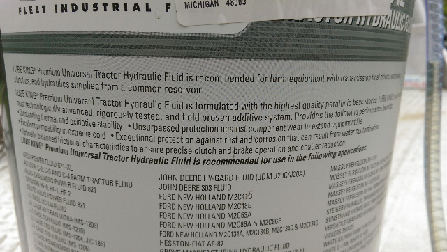

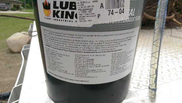

I'm sure that there is probably a certain point in the duty cycle life of hydraulic fluid in these machines where what you are saying makes sense, in regards to excessive heat and wear. I probably put more hours on my CUT in a year than the majority of owners on this forum will do in 5 or 10 years. And I probably also get my fluid to a higher temperature as well. That's because I use mine commercially and often for hours and hours at a time. But even then, I don't think that I can get the oil hot enough to break it down to the point of losing protection in the manner it was designed for. Maybe if I ran it 20 hours a day and never gave it a chance to cool down, maybe then that would apply. I just don't see it happening, especially at the rate that most users work their machines.
You are correct that additive packages are proprietary to brand, and each package is touted for specific benefits. But I doubt that an adequate additive package is lacking from the "store brand" oils that are spec'd for specific compatibility.
Here's a picture of the label on the bulk hydraulic fluid I use. Clearly, it meets numerous manufacturers base specs, and it also claims to have an advanced additive package as well.
