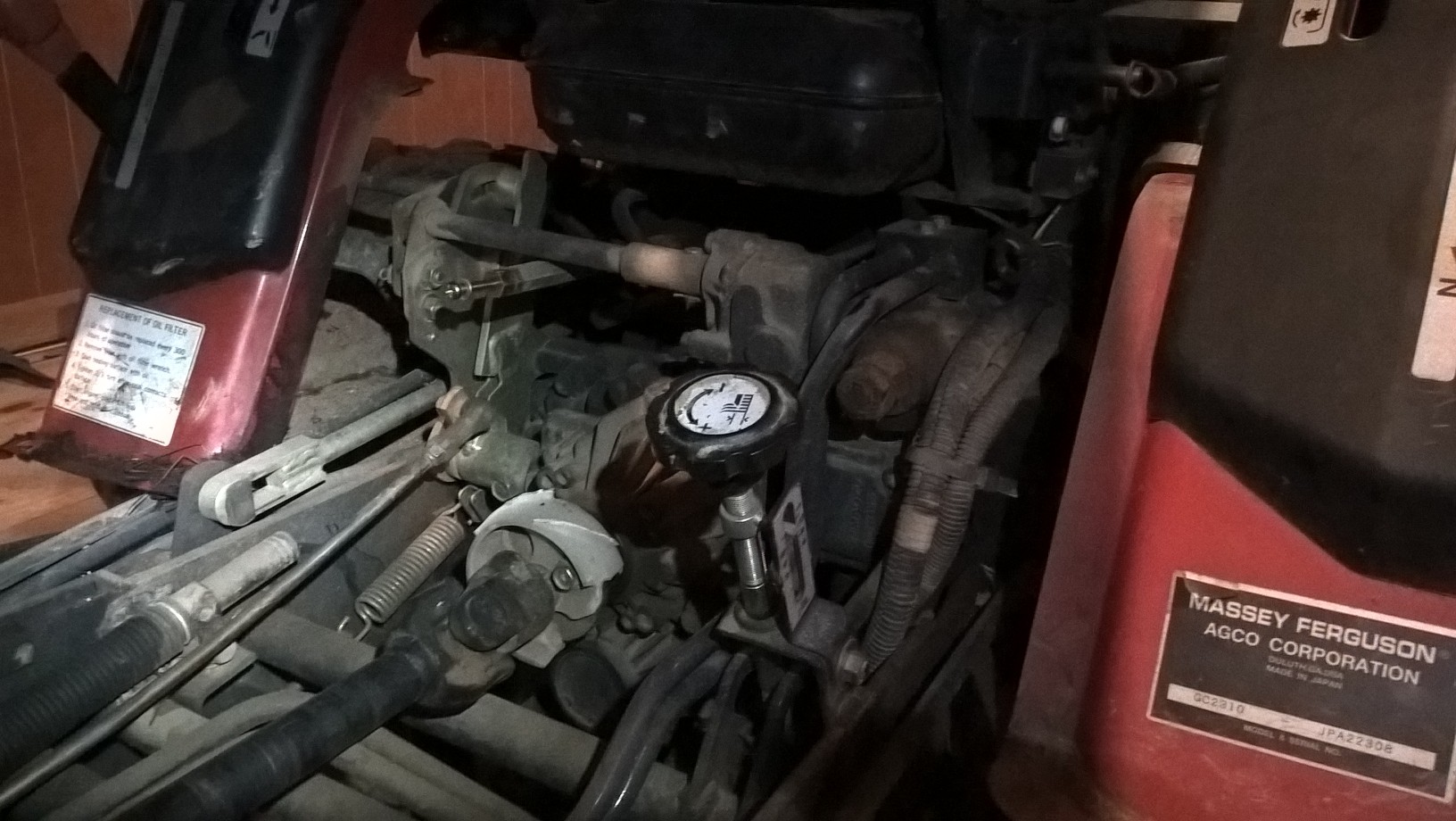

I finally am getting around to this. I've been using the tractor for other stuff over the last months and didn't want to tear it apart and lose usage until the winter.
I'm trying to pull the pump. I got off the floorboard, but nothing looked obviously like a pump:
I was researching, and I think I need to look for something like this:
http://www.shimadzu.com/hydraulic/products/gearpumps/k25cur0000003s0y-att/gpy.pdf
Any guidance on where to start?

I believe the pump is the black square, located directly behind the 3pt control in your photo.
