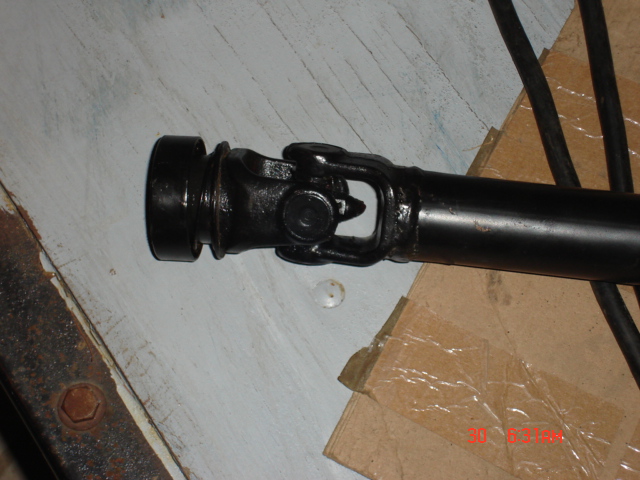

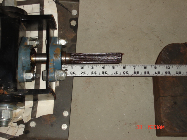

Sorry about your illness & glad you're back with us! Do you have any photos? I've removed all the blower stuff on mine --the driveshaft extension, the quick-hitch assembly that hangs from the front "bumper" and the blower itself--here are a couple of shots of the shaft, etc. When you say "play in the front yoke" do you mean in the universal joint area at the quick-release, or are the mating splines on the straight section perhaps worn? BTW, the stub shaft length I mentioned earlier is measured from the face of the mounting plate, not the bearing face where I put the ruler (oops).

I measured the rear part of the stub shaft sticking out of the rear of the Quick Connect and it has virtually no play, I feel an ever so slight movement if I really jerk hard on it but not much. Mine does not stick out as far as yours does. Mine only sticks out 4.75 inches whereas it looks like yours stick out 5.625 inches (almost 1 more inch).
The play that I have is between that shaft in your first picture and the splined yoke at the front of the long mid-pto driveshaft (opposite the one in your second picture). The universal joints feel tight, but I can easily rock that front yoke noticeable on the shaft. When it turned at PTO speed with a load it really wobbles.

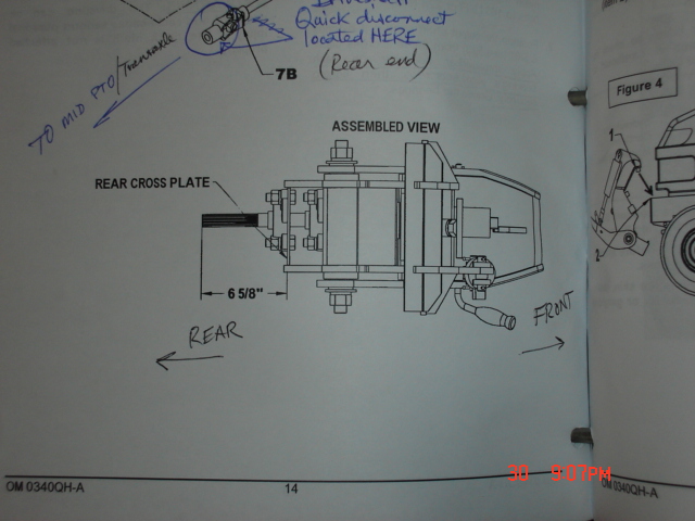

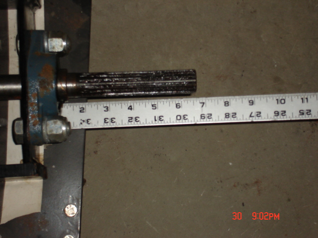

Attached, corrected photo of the sub-frame splined stub shaft, with the grease wiped off the end and the ruler placed against the "cross plate". Referring to pages 13 and 14 from the manual, the exposed end should extend 6-5/8" from the cross plate. Note that mine does.
It certainly seems that your splined stub shaft is not positioned correctly- either the set screws let go and the shaft slid forward, or maybe it wasn't positioned properly to begin with.
If the u-joint really feels tight, then most likely the metal on the splines & grooves is just badly worn. Perhaps repositioning the shaft so it protrudes the full 6-5/8" will allow clean metal splines to contact their respective grooves & all will be well. If not, perhaps the pieces are beyond salvaging and will have to be replaced. If repositioning the shaft seems to improve things, I'd say the problem is in fact worn splines and favor replacement... 2000 rpm can quickly turn nasty, as we've read in these posts.

I measured the the length of the of the rear output shaft on the Quick Connect from the rear cross plate to the end of the splined shaft and mine measures out to be 6.3 inches. That is ~0.325 inches (~5/16") less than it should be (6 5/8 inches). Moving the shaft back the 0.325 inches to give me the full 6 5/8 inches most likely will not help much with the wobble. I would suspect that I need to replace the yoke since it appears to be worn beyond reason.
