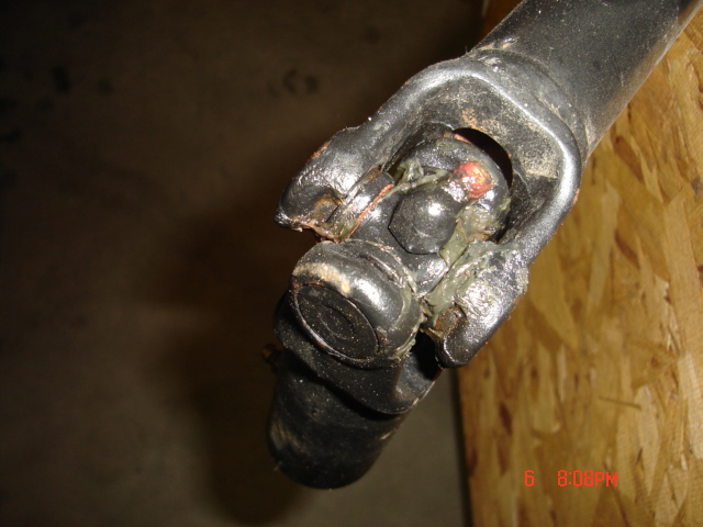

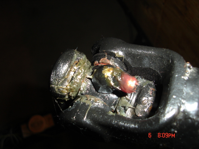

Walt-- Looks like these u-joints employ c-clips on the INSIDE of the caps/needles (under the caps, as it were)-- I tried to take a pic of the set-up; though it's a bit hard to see through the grease, the first picture is the clearest. It appears that the little opening in the casting is where you would stick a tool in to pry the c-clip out. The rest of the removal should be the same as any for other u-joint, I would guess.

That didn't sound too clear.... The c-clips are on the inside of the yoke holes, not under the caps themselves...:eek: Hope that you'll be able to see the side (edge) of the c-clip in the first picture. The last photo is of the other end of the driveshaft--same set-up.

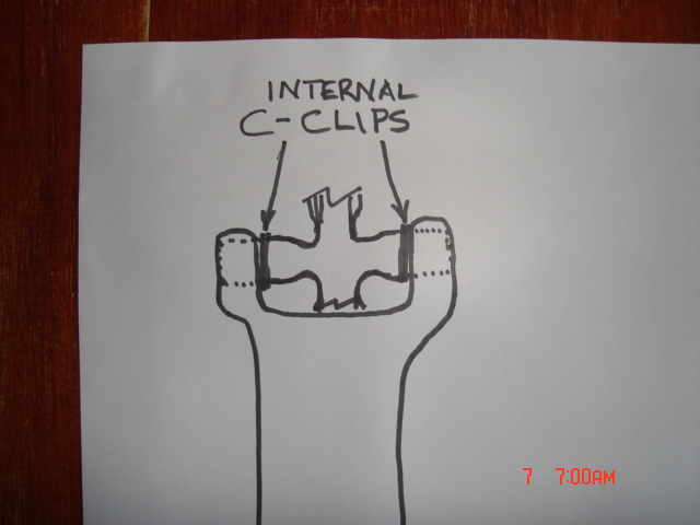

Here's a drawing of how the clips on the u-joint are arranged that I hope is a bit clearer---

   / GC2310 snowblower driveshaft flew off... #48
Thanks for that diagram. That's clear and looks straightforward. I'll try to get around to it tonight or tomorrow.
What's the best way to get those interior C-clips off? I've never don't one of this type before.
