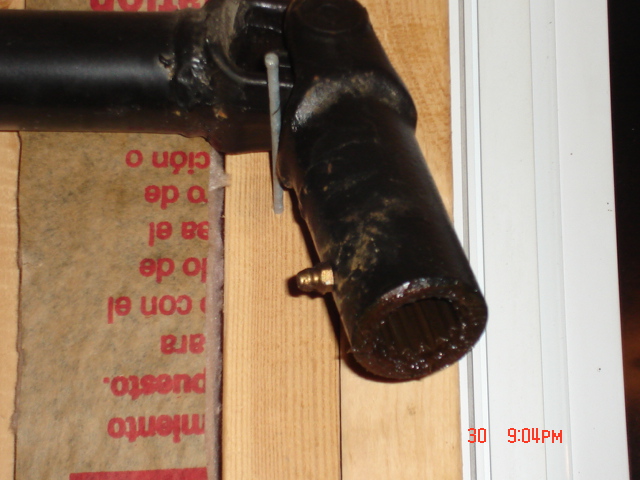

Update,
Weasler Engineering has not (yet) responded to my inquiry about a longer yoke (it's been 8 days).
The MF dealer said my tractor went out of warranty on 3-20 (2 years) so I'd have to bring in the entire setup (tractor, quick connect, snowblower and driveshaft) rather than just the quick connect and driveshaft to show them the play in it. Then they said they'd try to get a factory rep to look at it and do a 'good faith' warranty repair (remember the tractor only has 70.8 hrs on it and only about 20-25 hrs on the driveshaft). The dealer is also 120 miles away (each way) and that would mean 2 separate trips for a total of 480 miles. Plus, I don't own a trailer big enough to haul all that and I'd have to borrow one, twice.
I told him, his suggestion was too uncertain and too much trouble for the small repair that it is and that I would go to the local John Deere dealer (7 miles away) and see if they could help me.
DEWFPO
   / GC2310 snowblower driveshaft flew off... #34
Does anyone actually know what the MF P/N is for this front slip yoke on the mid-pto driveshaft that connects to the Quick Connect on the 2300 series, and probably now the 2400 series. The number stamped on it 6 or 8 (hard to tell)-19190 is not the P/N according to Weasler.
Thanks,
DEWFPO

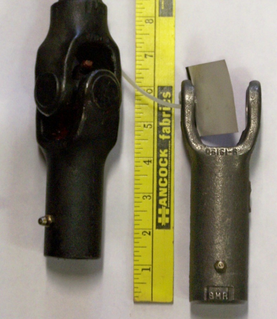

O.K., after much communication between the dealer parts counter and countless e-mails, pictures, drawings, etc.... with an engineer at Weasler (manufacturer of the slip yoke) I have the following data to share.
The stock front yoke on the mid-PTO driveshaft is MF P/N 4263176m91.
Weasler does make a 1" longer yoke that has the exact same dimensions except for length. It is Weasler P/N 812-0615.
I spec'd both with a digital micrometer and all dimensions are the same except the length with the 812-0615 being 1" longer.
I bought 812-0615 from InlandTruck for $26.05.
The new 812-0615 slips over the rear Quick Connect shaft nicely with noticeably less play in it than the original (shorter) yoke.
As stated in my previous posts, with this new 1" longer yoke I should still have .620" of shaft visible when the mid-pto driveshaft is pushed forward, far enough to install on the mid-pto output shaft at the rear of the tractor.
When the driveshaft is locked in place all the way back on the mid-pto output shaft, I should still have greater than 1.6" of rear Quick Connect shaft showing in front of the new yoke.
Question ? I assume the caps on the universal joints can just be pryed off to reveal the C-clips that retain the bearing caps?
Cucch - My shaft sticks out of the rear of the Quick Connect within 5/16" of the spec'd distance. As well, there is not much more shaft that can be extended rearward without negatively affecting the front of the shaft coming out of the Quick Connect.
See the attached photo.
DEWFPO
