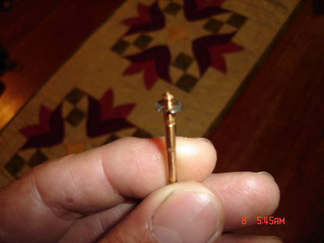

Walt, the rag's definitely a good idea-- I lost the teensy c-clip that holds the carb needle in place on that 71 CB100 as I was trying to put it back on 2 weeks ago-- finally found one left over from a 76 XL250 that was the same size.... but wow, was I hard on myself for trying that in my gravel driveway! --I should know better!!
On the 2300 driveshaft, perhaps a screwdiver, or maybe a piece of 1/8" steel with a u-shaped cutout --to fit around the u-joint, but bear on the c-clip-- might also work.

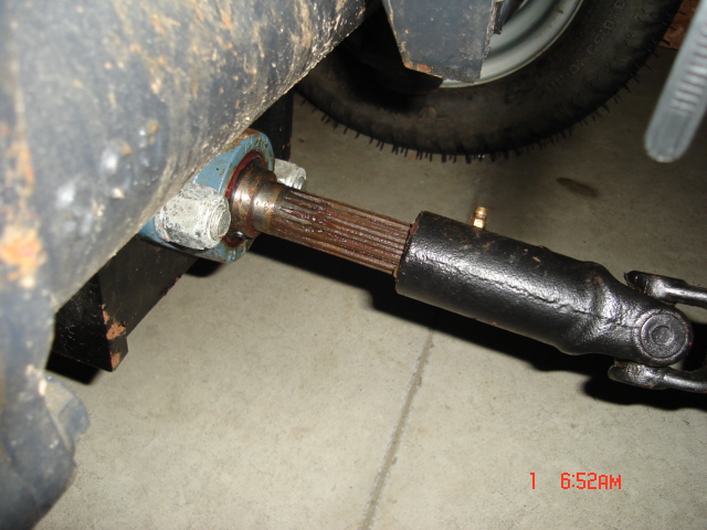

UPDATE :
I've replaced the stock front slip yoke with a new, 1" longer one that I mentioned in previous posts in this thread. In the picture below you can see that there is now only 2" of shaft visible in front of the slip yoke. The yoke is longer by 1 full inch which is approximately the distance from the zerk fitting forward. It fits great, has plenty of clearance and now there's less vibration and wobble in that joint. This should solve the problem I was having.

Some of you may remember me saying that I had a much more pronounced vibration & noise when I had the snowblower raised up as far as it could go and rotating at full speed. If I lowered it a little bit, then I would just get the normal vibration and noise.
Well, I'm here to tell you that since I changed out the front slip yoke on the long mid pto driveshaft to the new 1" longer slip yoke; I get no noticeable change in vibration or sound no matter what angle I have the snowblower at. I wasn't expecting it to solve that issue, but it did.

Walt-- as promised, here's a photo of the stock set-up. Although I've had no trouble with mine, your longer shaft looks like a much better way to go. How much did you have to spend for that little jewel? Makes mine look like it'll fall off any minute!
(On another note, how'd you get the photo in there like that?)
