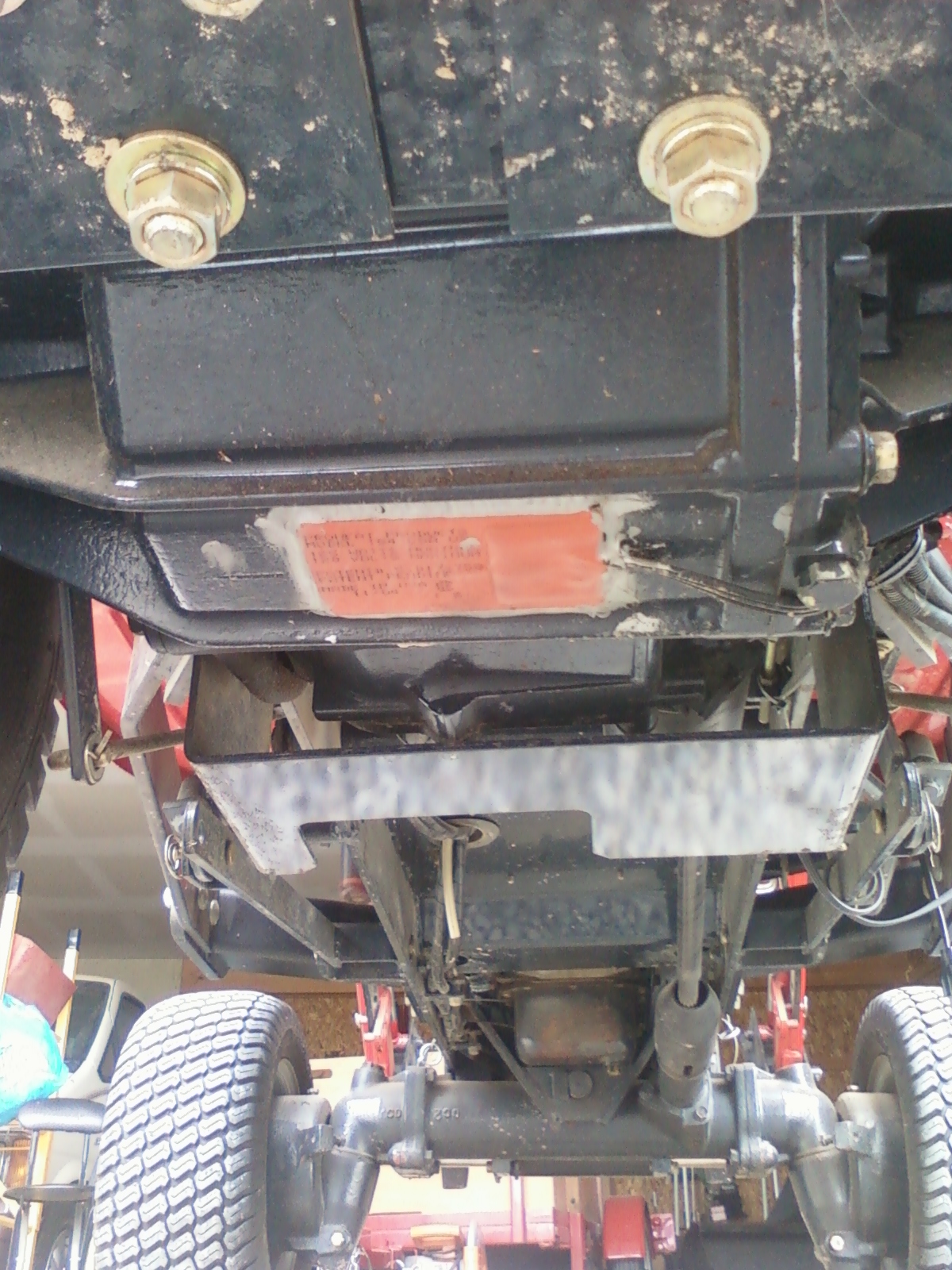

Thanks. Do you have a picture of where you mounted the one on the rear axle? Or can explain where? I haven't crawl under and see what would be a good protected area yet.

The pad heater is not totally protected from anything. But did fit nicely between the ribs on the case. I don't run the Baja 1000 with mine like some do, so I am not worried about it getting damaged.

Looks like there's some room toward the back of the case. I do plan on doing work in the woods so I want any protection from branches I can get. Maybe I could silicone a piece of aluminum to it just to keep it from getting torn. hmmmmmm....
