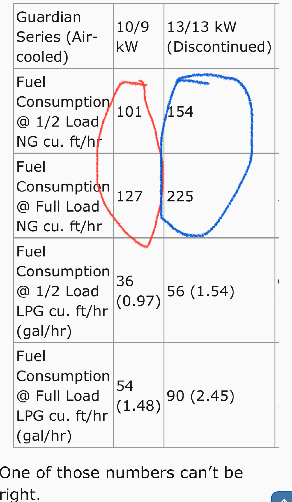

Not sure if you’re responding to my post…. If you are, The two numbers I circled, where at least one of them must be wrong, are both labeled NG
I don't know if the numbers are right or not, but due to ignition issues, natural gas engines do not throttle back their fuel intake as much as propane or gas. It gets too dilute to ignite.
So I might believe that the numbers are in fact correct.

Those two numbers show a 100% increase output for only 25% more fuel (50% load vs 100%).
100% load is typical a bit more efficient than 50%, but not by that much. You can see it disagrees with the other 50 vs 100% load numbers, that are reasonable.
One of those numbers is definitely bogus
Try thinking of it the other way around; dropping from a 100% to 50%, natural gas can't throttle back very much, or the engine stalls. So, 50% load is very inefficient (kWh/therm) for a natural gas engine, compared to kWh/therm at 100%.
Propane can throttle down better, gasoline even better, and diesel best of all. It is a question of the lower limit for combustion, and if the fuel gets too lean, it won't ignite and the engine dies.
Natural gas needs to be at a minimum of 5% to ignite, while propane is just over 2.1%, gasoline 1.4%.
Does that make more sense?

You’re just digging yourself in a deeper hole. Don’t try to reverse engineer a misprinted, or miss-written bogus number.
The 13 kw NG numbers I’ve now circled in blue look reasonable.
See the difference?
Now look again at the 10 kw numbers. You really think you can get double the power for only 25% more fuel…and at maximum load?
Of course not. ICE engines don’t work like that.

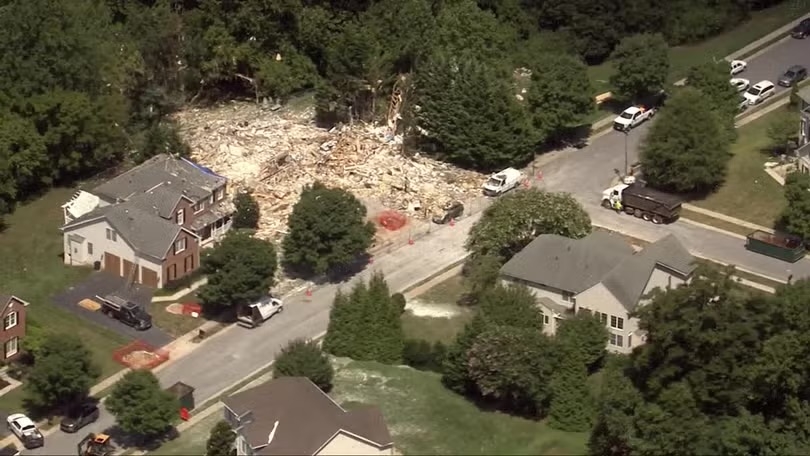

This is what’s left of a natural gas leak near Belair, Md Sunday morning.
See the difference?

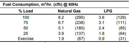

ICE engines don't... unless you have strict RPM requirements.
Here's another similar table straight out of a generator's spec sheet:
On this one, going from 50% load to 100% (ie, an increase of 100% load) takes 50% more fuel. Granted it's not as bad as the previous table, but look at the rest of the jumps.
"Exercise" is basically a no-load run, and it still takes 1/4 of the full load fuel requirement.
Basically like if I put my car in neutral and push the gas down until the engine's running at 3600RPM.
