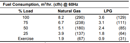

ICE engines don't... unless you have strict RPM requirements.
Here's another similar table straight out of a generator's spec sheet:
On this one, going from 50% load to 100% (ie, an increase of 100% load) takes 50% more fuel. Granted it's not as bad as the previous table, but look at the rest of the jumps.
"Exercise" is basically a no-load run, and it still takes 1/4 of the full load fuel requirement.
Basically like if I put my car in neutral and push the gas down until the engine's running at 3600RPM.
Low generator loads will always be inefficient. At a 0% load, you have a O% efficiency.
“strict rpm requirements” is irrelevant for these tables as the machine is running the same fixed speed at both a 50% load and 100% load measurement points.
This chart shows a 61% increase using NG, from 50% to 100% load. Reasonable numbers
Again, the first 10kw chart has a mistake in the numbers I circled.
I don’t understand how you don’t see it.
These erroneous measurements, or misprinted numbers happens all the time in published specifications, be it owners manuals, or online articles. No guessing of technical reasons to explain the numbers. Simply a case for Occam’s razor.
