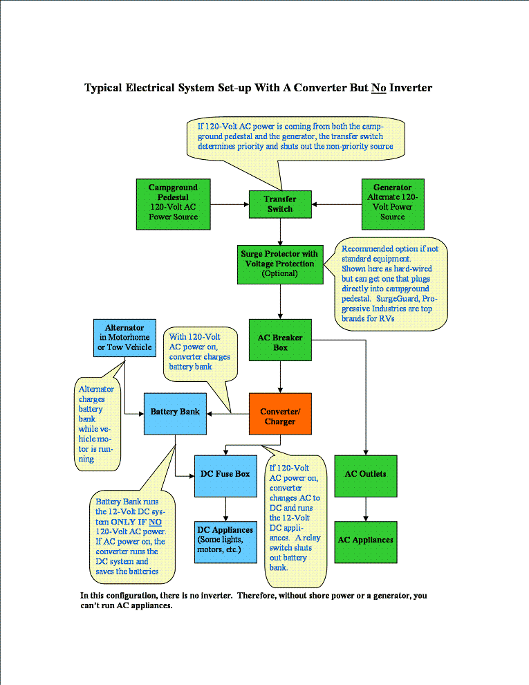

As a side note to backfeeding the house...I'm just curious as to why my motor home is factory built to backfeed the 5K generator back into the coach using the AC source cord with no transfer switch, just a closed circuit. If it's so dangerous to do that, why would Gulf Stream design it that way?
This has nothing to do with the grid, obviously....I just noticed some saying this was bad for the house in general.
This is a typical rv system.. your transfer switch is in there somewhere,,It's totaly automatic as Airstream is very high end,,
   / Generator backfeeding into utility lines #84
Also if the airstream is not plugged into the utility to begin with, it cant possibly backfeed. And if it is plugged in it cant run power from the generator. This is NOT a residential structure that is constantly :plugged" into the utility.

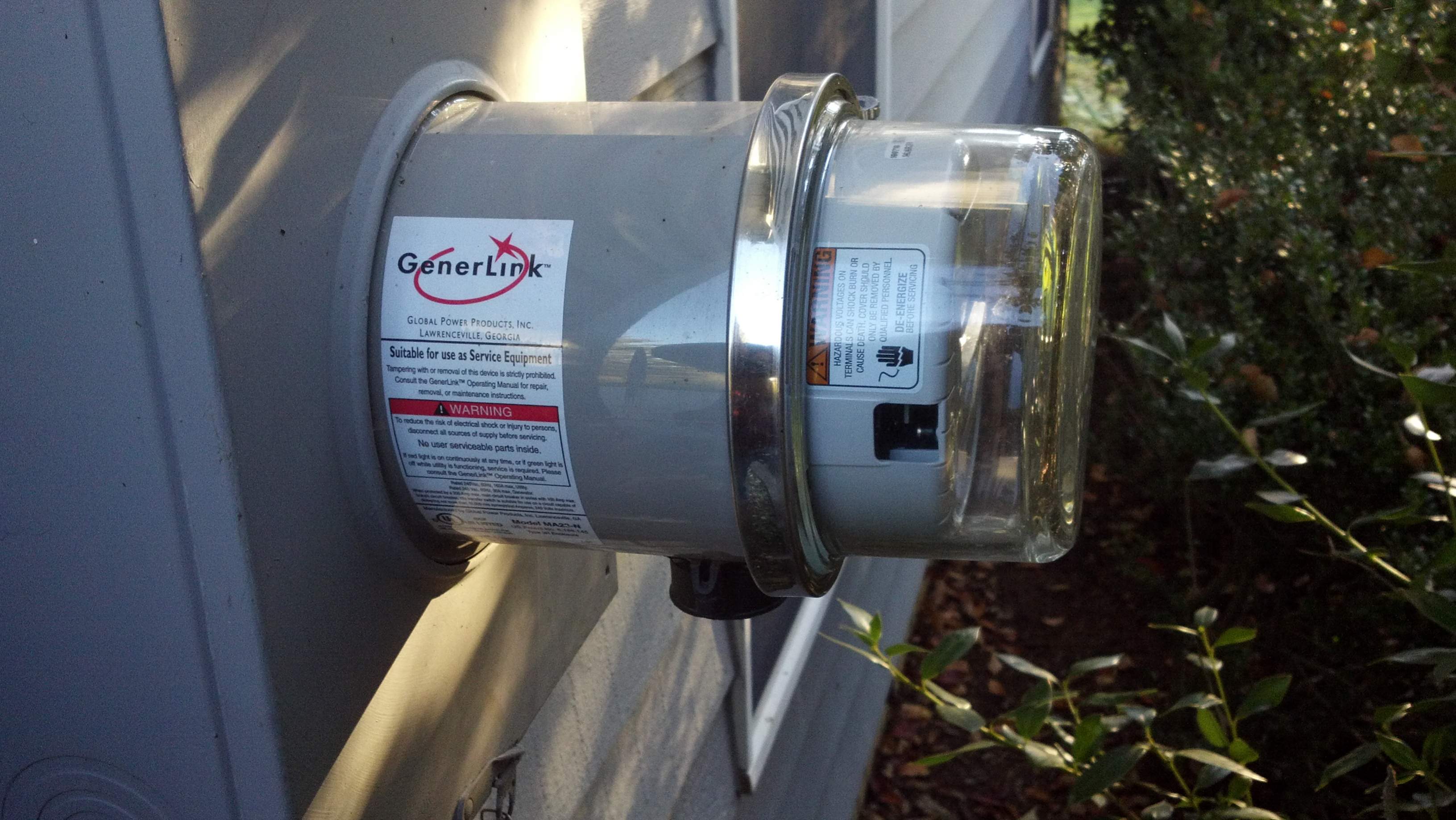

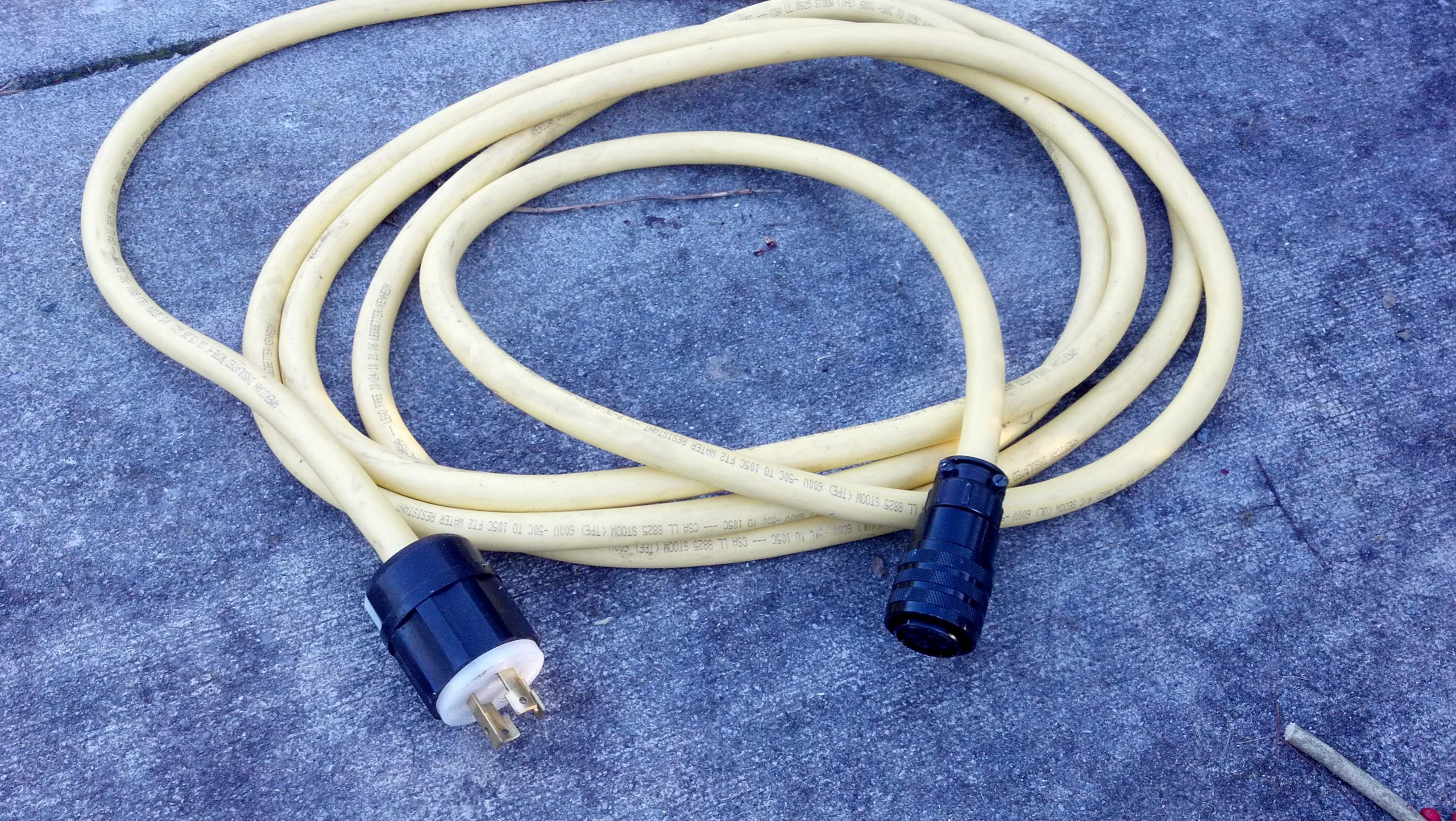

Or look into using a Generlink.
www.generlink.com
I have 400 amp service. This will not work for me. Good idea otherwise. One problem I have heard is that it will not connect to the generator if the utility is working. There is no way to test your connection. I may be wrong about this.
   / Generator backfeeding into utility lines #87
Howdy,
Generlink is made for 200amp service. It is a collar which extends your meter out about 4 inches. There is a special cord end which plugs into it. see picture below. The generlink unit favors generator power. In other words, when you attach the cord, your meter disconnects from the utility, and your on generator power. That is how you test. 3 little lites along the bottom by the plug tell you if utility power is waiting on the other side. If its not lit, then the power from the utility is not there.
30amp Generlink cord set

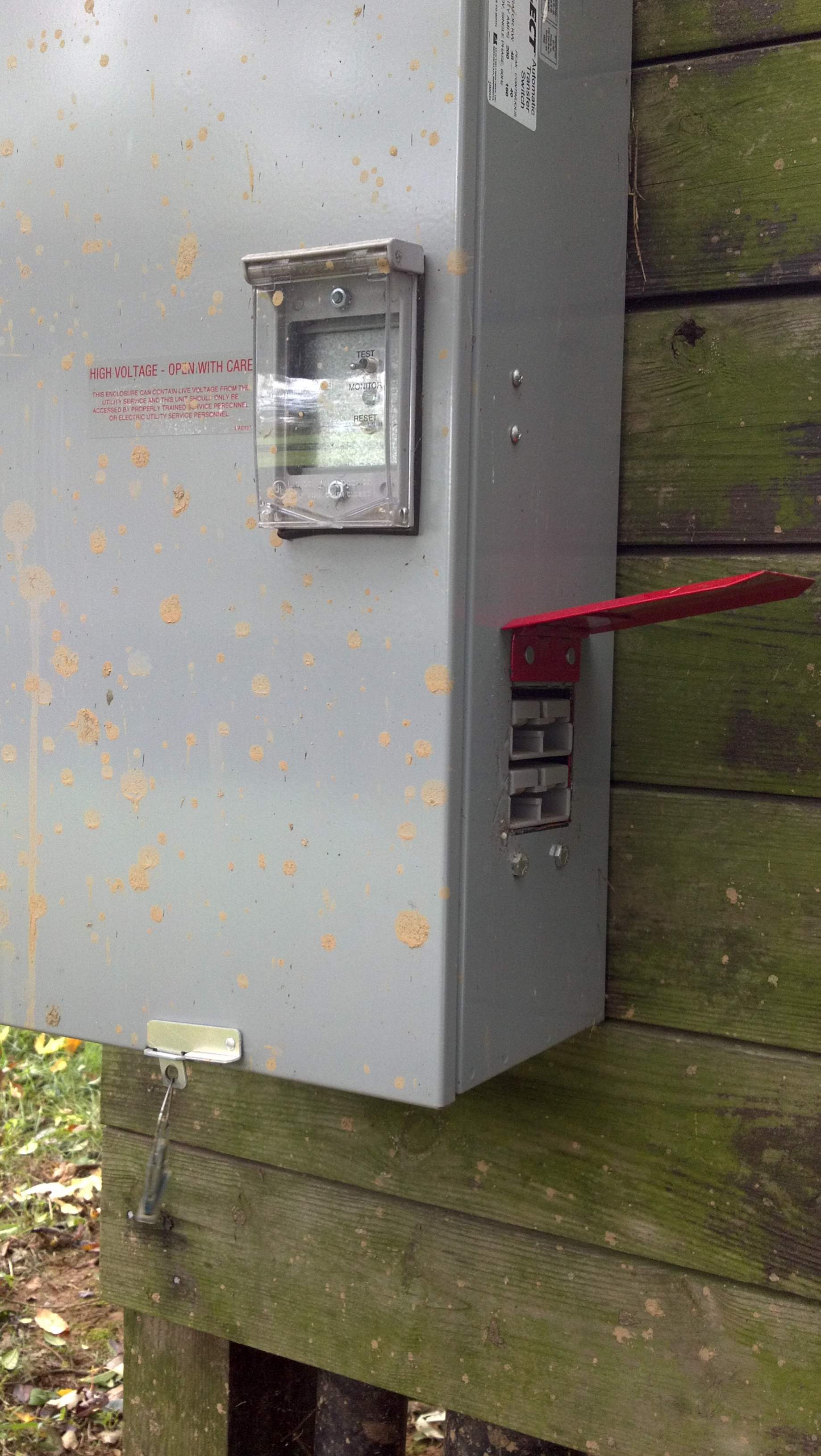

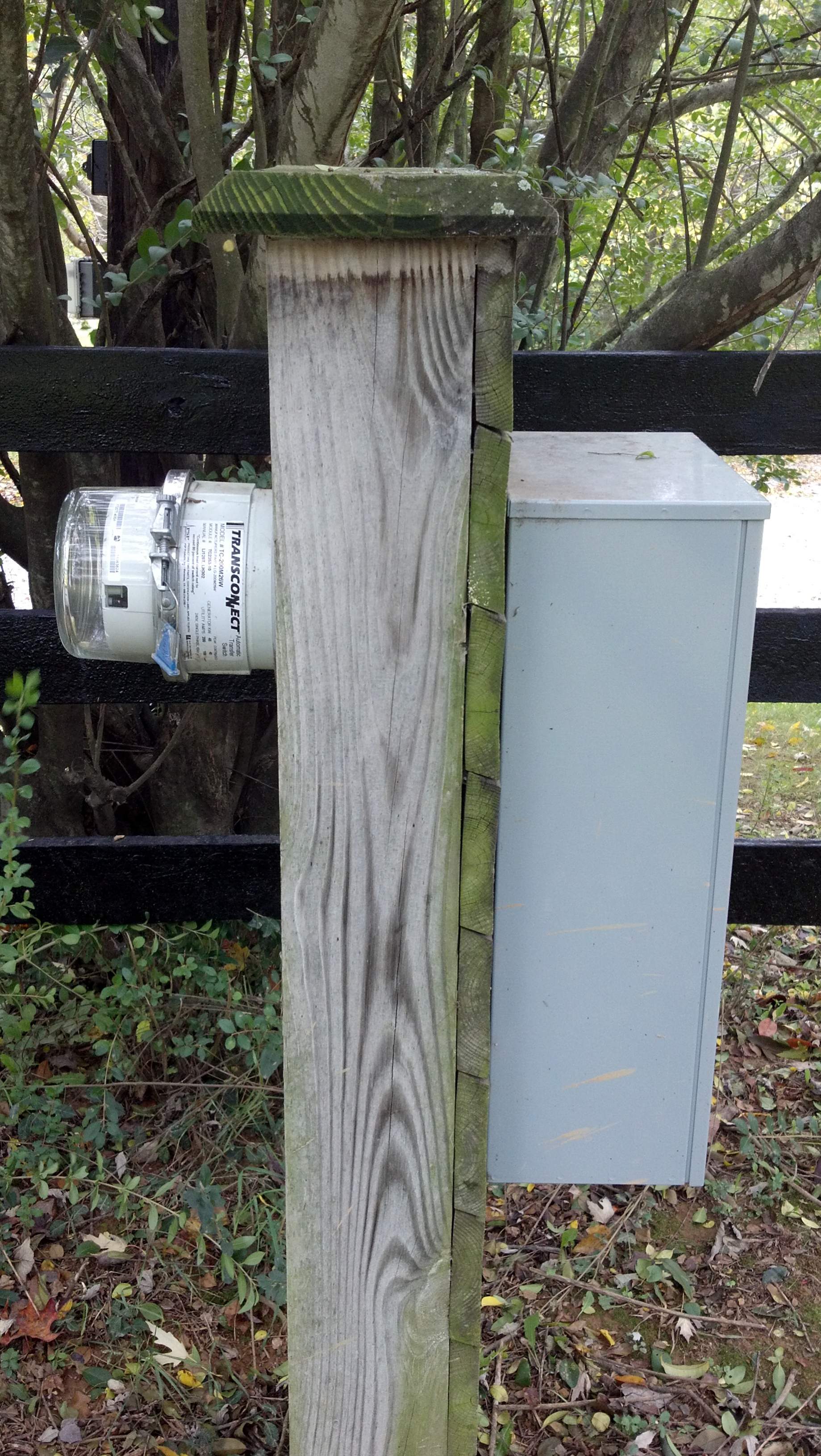

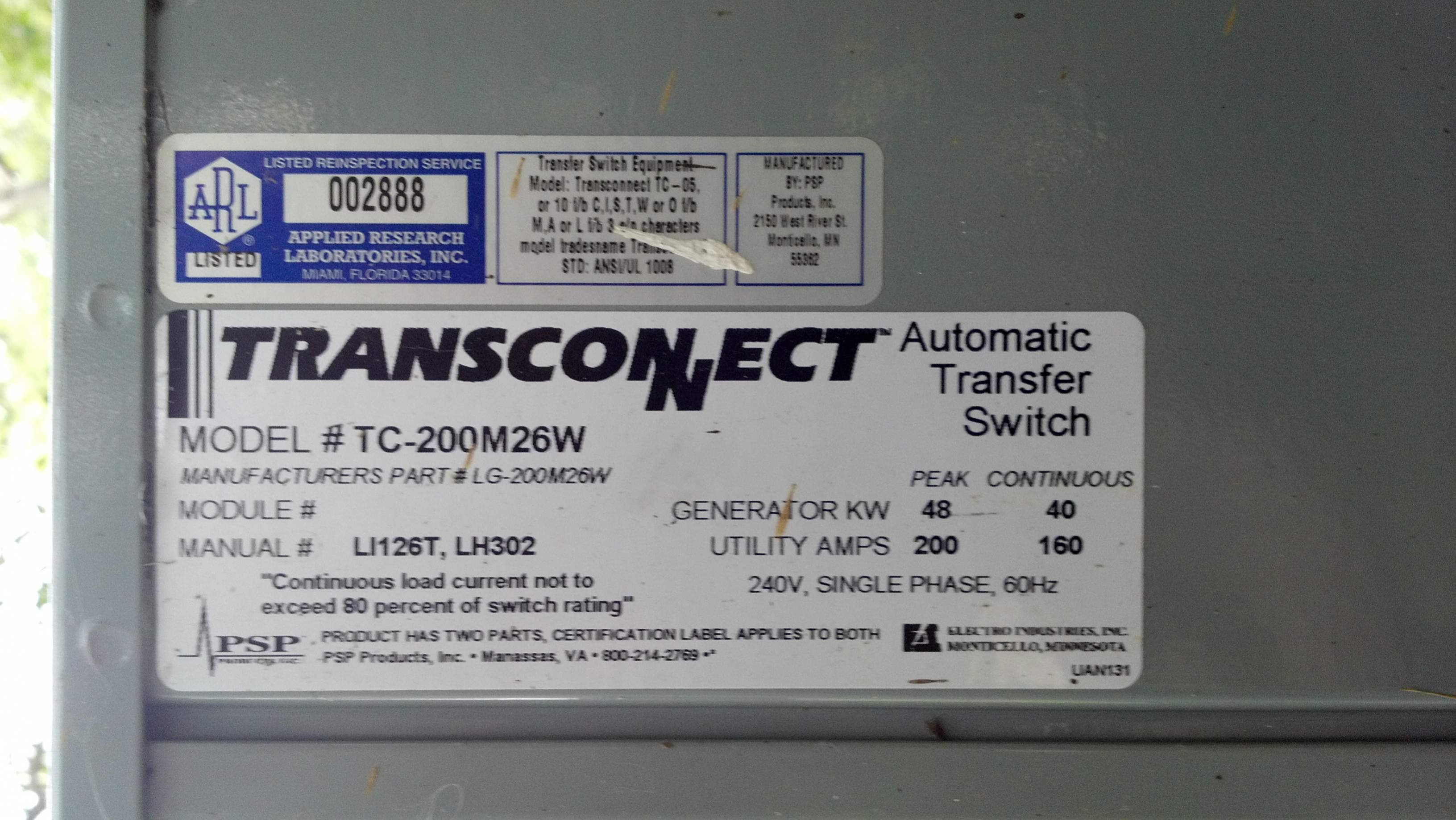

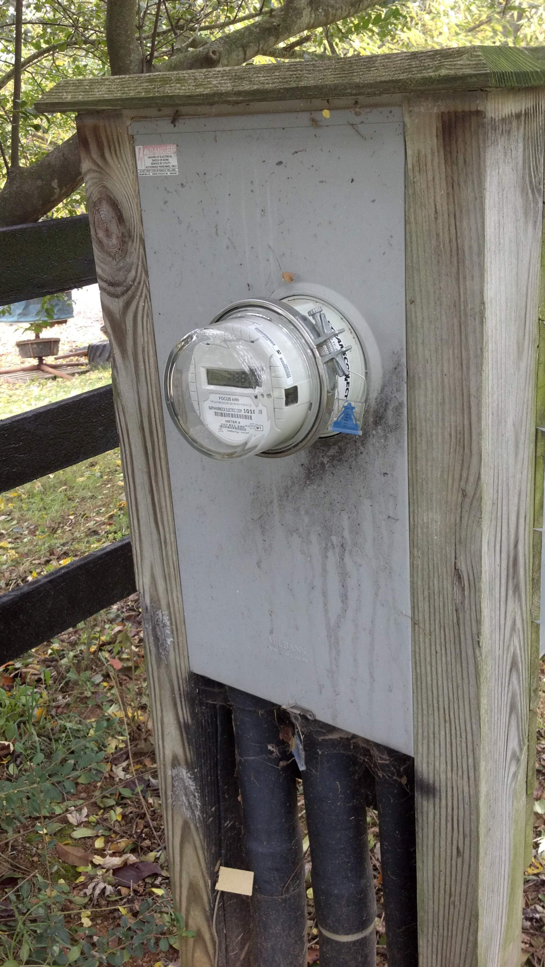

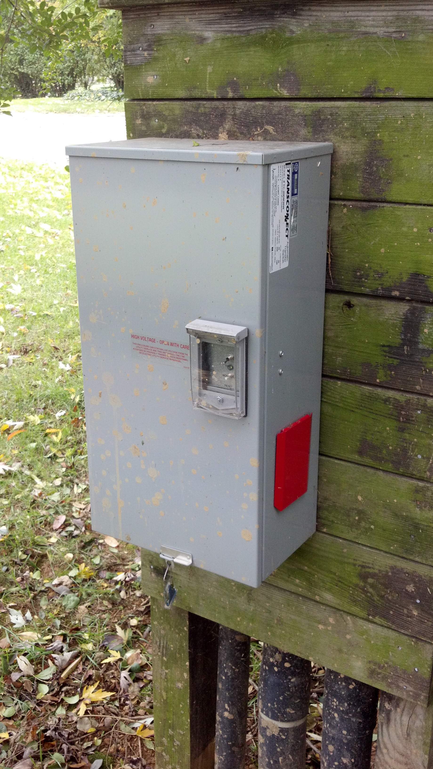

For larger service
I too have 400amp service at a central farm distribution point. It was easier and cheaper to have my utility put in a special hook-up. Transconnect unit. Similar to the generlink, a special collar moves the meter out about 4 inches. It then has a special pigtail which connects another box. The other box has all the automatic transfer and disconnect circuitry. I have a full power plug (dual modular anderson 350amp gray with 2/0 pins) The same which is on the pto generator. see below
This really works well for me. I have feeds going out from here to the shop, run-in shed, barn, and large house. Each with there own panels.:thumbsup:

How does the price of your setup com pair to a 400a transfer switch ?? Looks like a nice setup..
   / Generator backfeeding into utility lines #90
daybreak1998
Howdy,
A LOT easier and cheaper. I looked all over the place and the 400amp transfer switch is made of gold. A lot really depends on your utility. I am in Northern Virginia, and have Rappahannock Electric Coop. Here is there pricing page of switches REC Electrical Services Prices I talked with them and was able to bump up into the next size switch. I also paid a little more than the $1,400 which is the 25kw.
If you look at the break down of what it would cost with;
wiring
electrician labor
utility to pull meter and put back
permit
it really adds up. I am sure it would be more than the $1,400. And since the utility did it, they have a permanent permit :)
