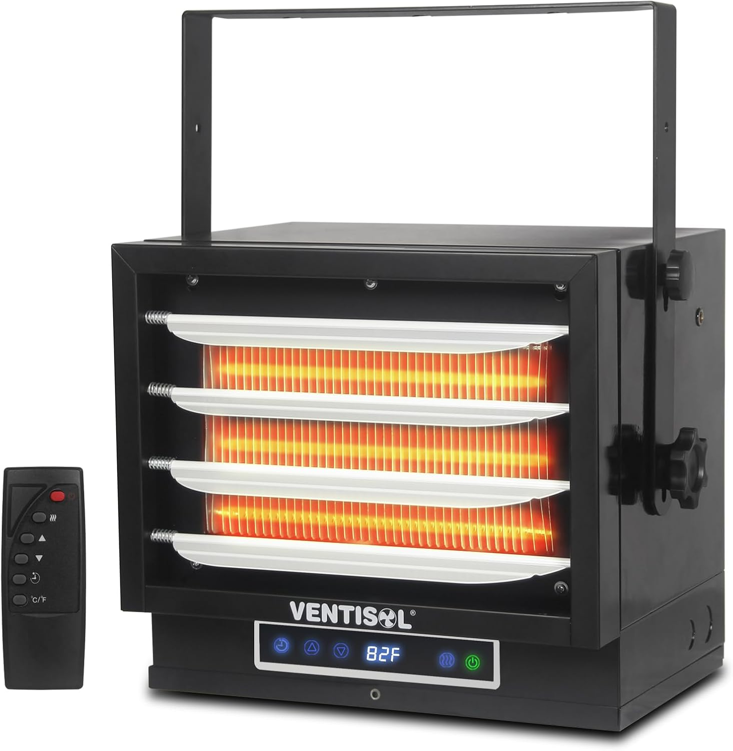

How do you guys put load on your generators during maintenance runs?
I usually just use the house as a load but the momentary loss of power during the changeover causes problems with household electronics. I've been thinking of getting a couple of cheap electric heaters, but I'd like something that draws a bit more for my 11KW generator.
Maybe something like this:
Any other ideas?

Call some of your local A/C repair companies. Ask if they have a used indoor fan coil from a change out with a 10kw heater. This setup will allow for you to check the +/-240v circuit. A simple tstat and you're in business. You're on the right track with the portable heater for the 120v circuit.
edit: what you're referring to is called a "load bank"

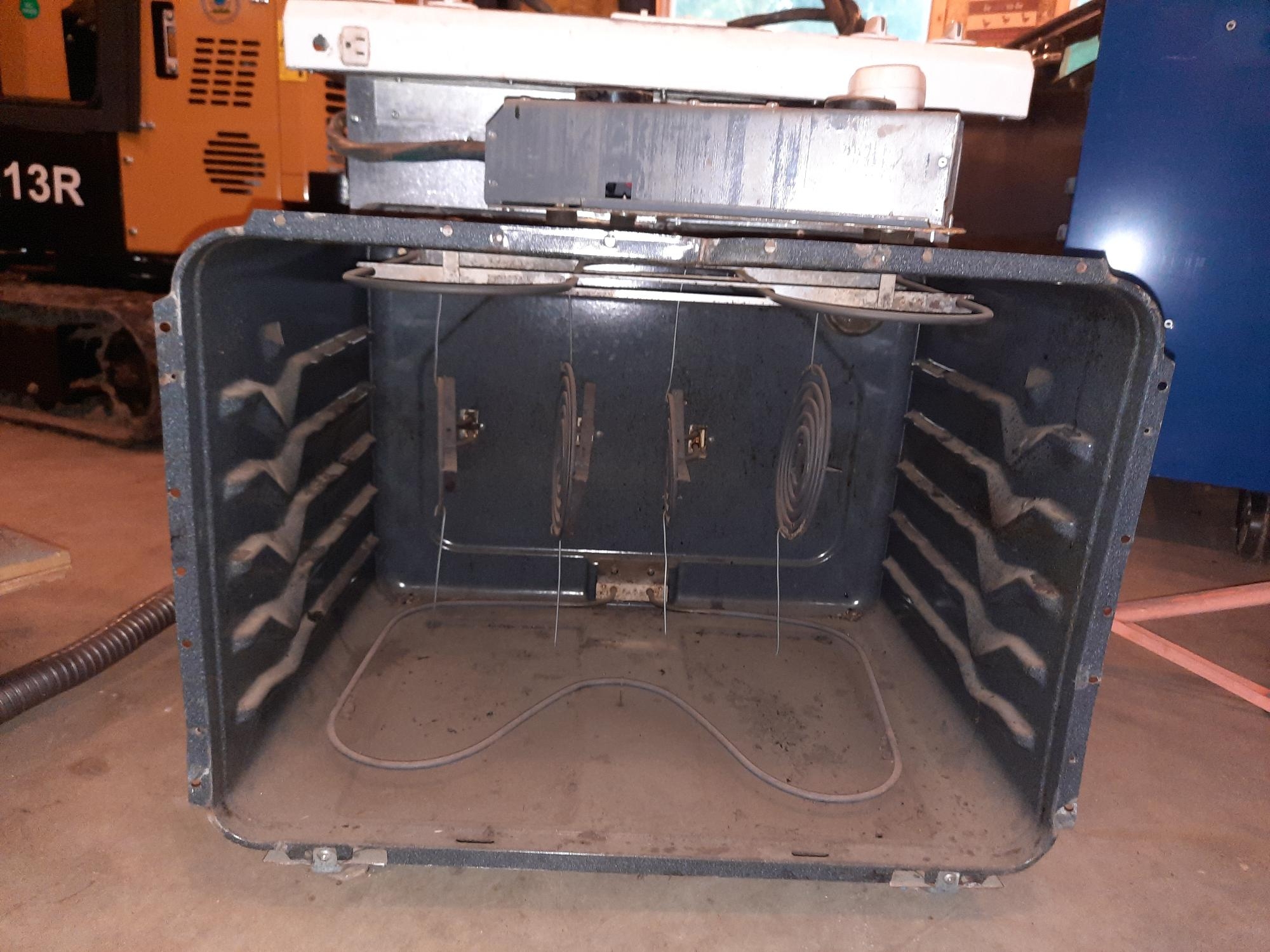

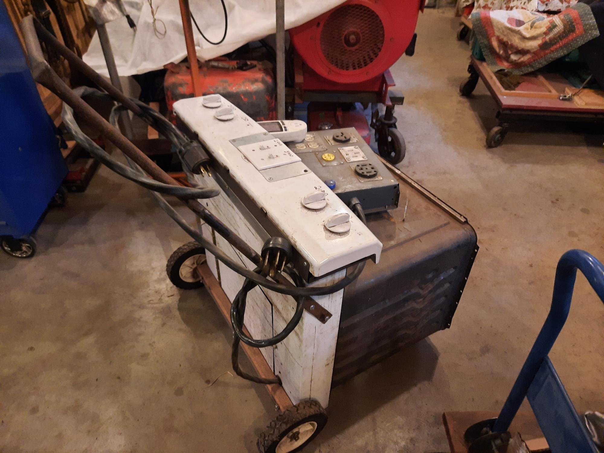

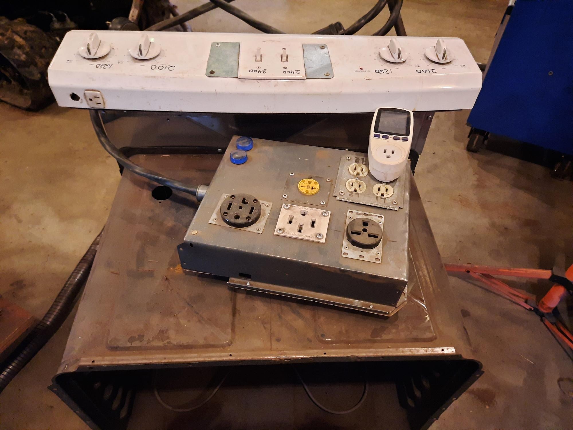

I have a few generators in the shop that need to be started up every once in a while, during the year. Running them with no load is not really a good way to exercise a generator. My load is a cut down kitchen range, with all the top elements in the oven, along with the oven elements and the oven is completely open at the front. Using the range switches will give loads from about 1kw to 12kw, and as a bonus, the elements will switch on and off if not put on high. This will give you a test for generator response to load variation. I will post a picture tomorrow.

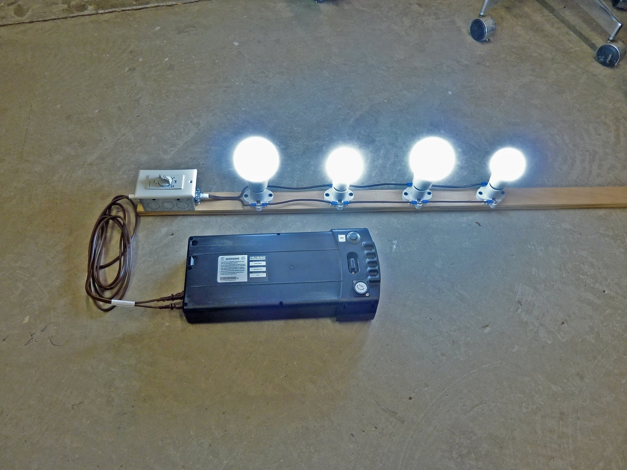

On a smaller scale, I have a similar rig I use to discharge my e-bike batteries:
Come to think of it, I do have a dozen old 600W incandescent bulbs I used to use in the barn before I converted to LED. They would give me a 7200 watt load with a setup like this.
