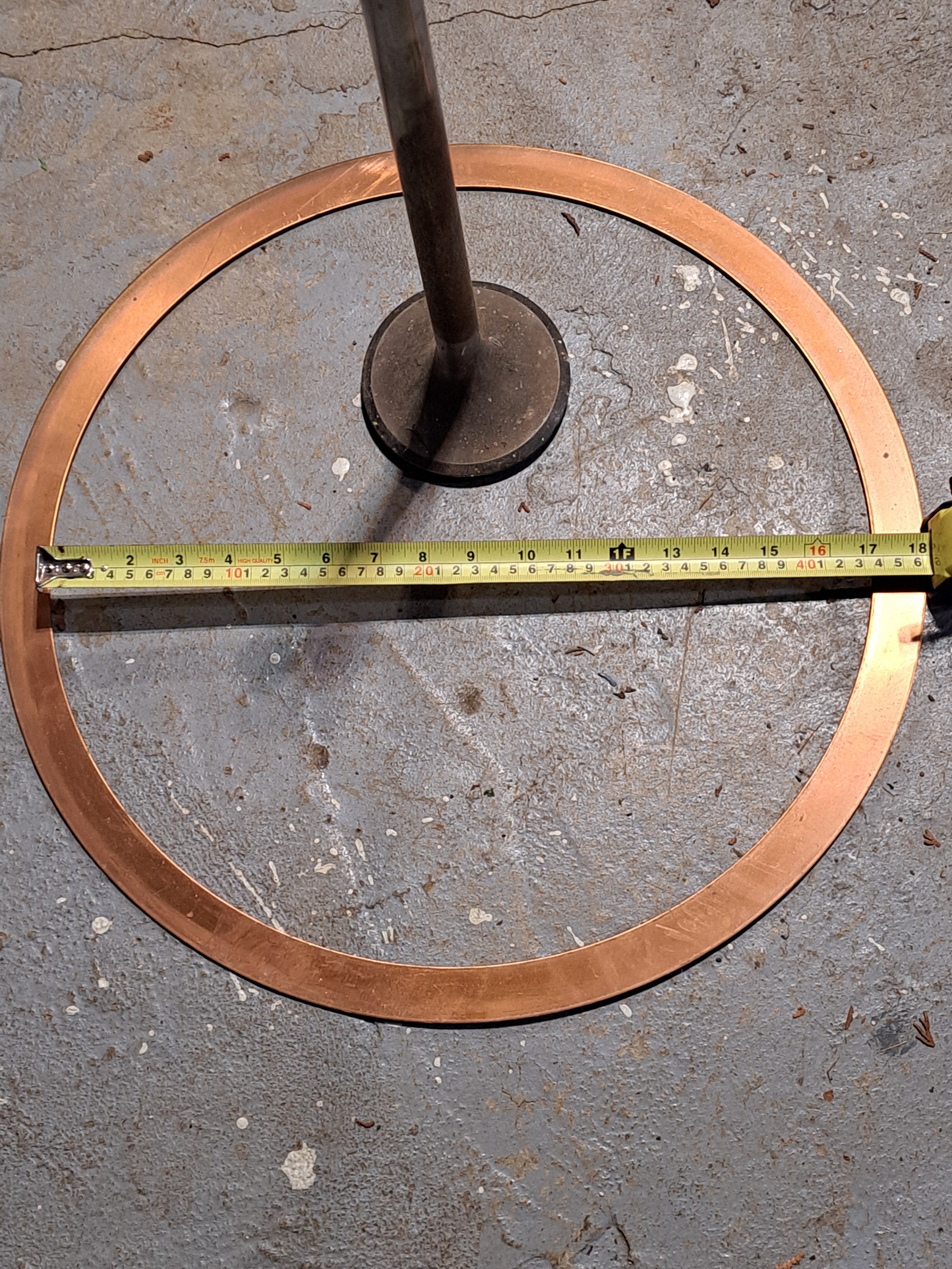

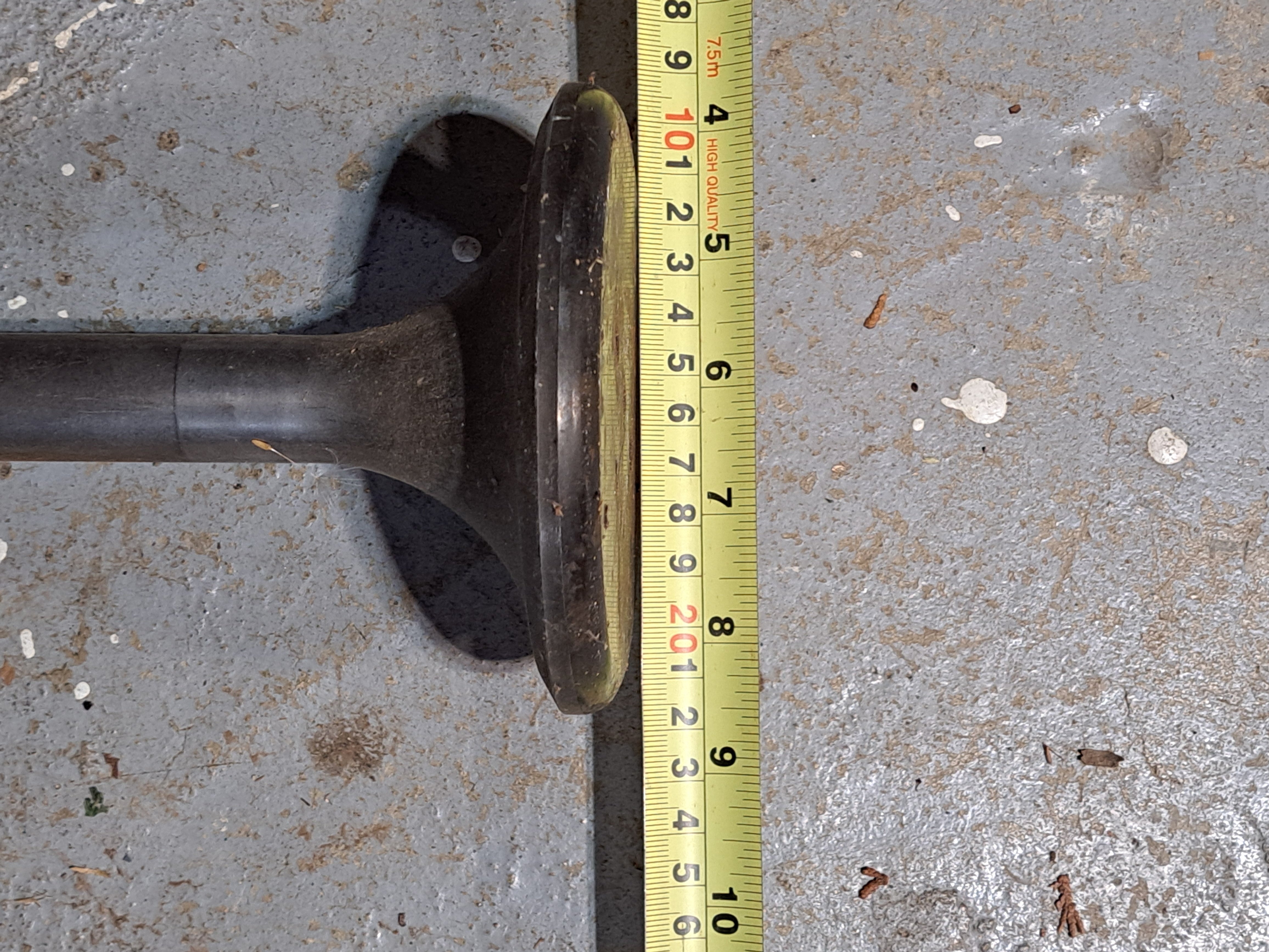

Here is a picture of the head gasket and one valve from the diesels I worked on when I was 18 yrs to 30yrs.
This unit was 420 hp per cylinder 514 RPM I think. Four valves per cylinder turbocharged intercooled. A real nice unit Mirrlees. Generators.
