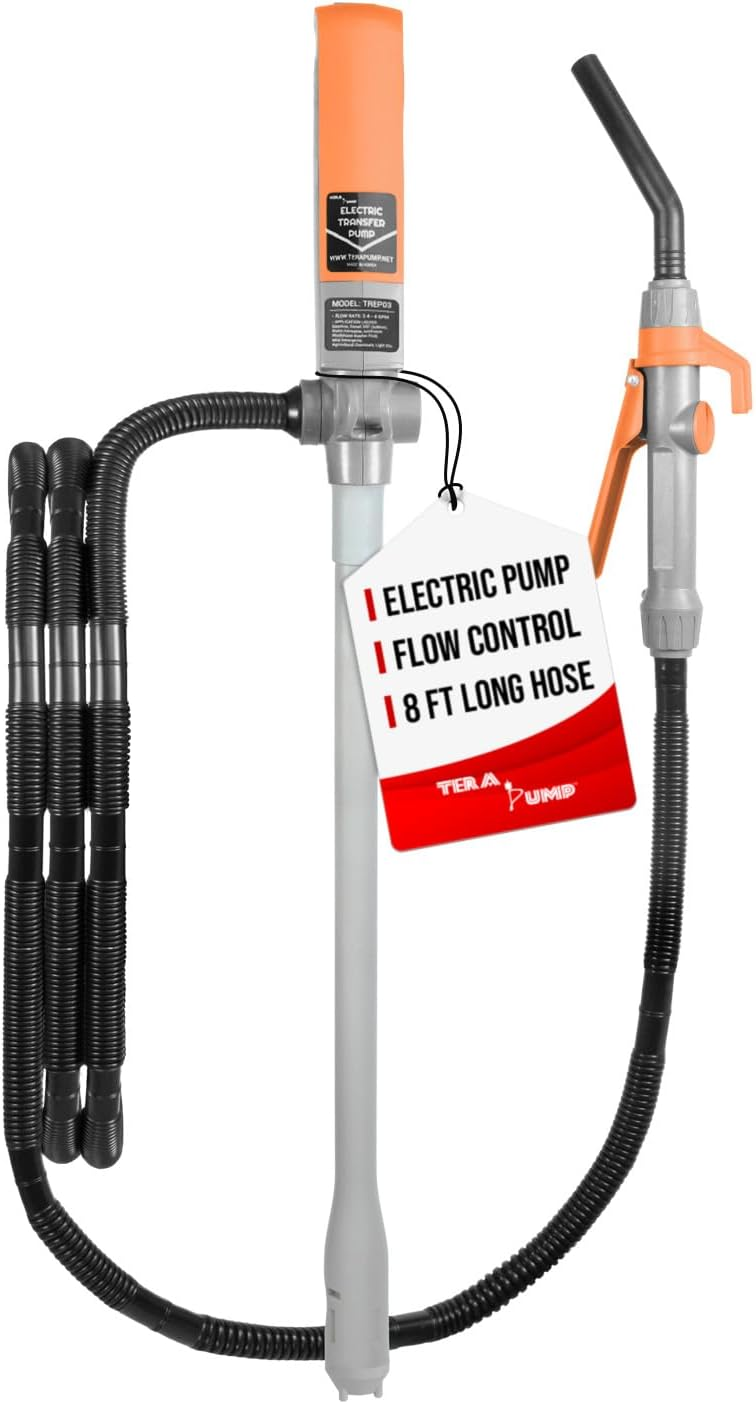

I use this Tera pump to remove as much gas from the generator tank as possible:

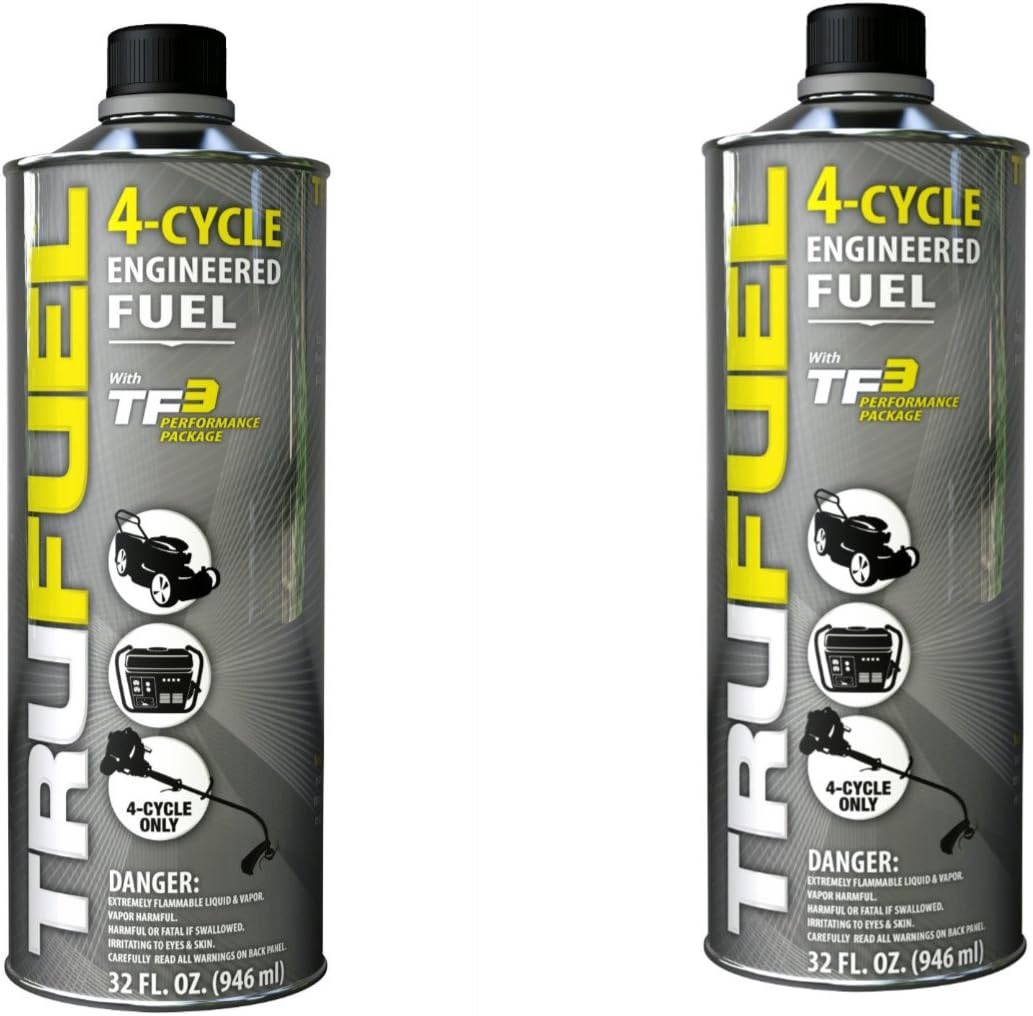

I then add a pint of Tru Fuel just before the engine dies.
It ensures a one pull start, even after a year of storage.
When it's time to rotate stored gas, I also use the Tera Pump to transfer gas from my 5 gal generator gas cans into my vehicles.
The pump fits into the mouth of most gas cans and the nozzle fits the gas tanks on most vehicles. It's tough to do with pour type gas cans on some cars.
   / Generator Dummy Load #46
Mr. BDHSFZ6, the pump sounds interesting, have you used it much? Just wondering based on some of the "1 Reviews".
Yeah, I saw those reviews but bought it anyway. I actually have two, one for gas and the other for diesel. I've had one for 4 years and the other for 8 months. I use them every couple of months to pump 10 gal or so, and have had no trouble with either.
The plastic tubing is the weak point. You have to be careful not to kink it since it gets brittle in cold weather.

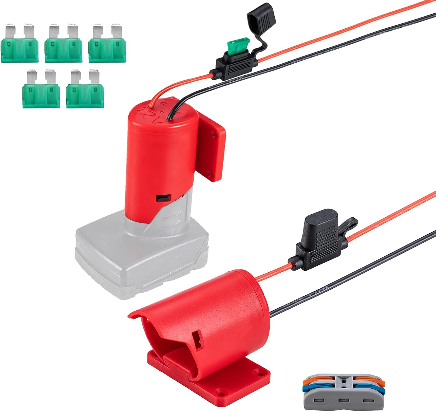

To save the hassle of having to plug in the pump to AC or 12V, I mounted this adapter to the pump housing and use my M12 Milwaukee cordless tool batteries:
