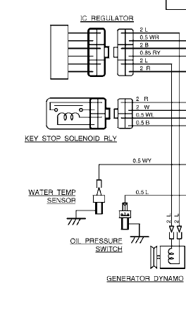

I found a wiring diagram and it refers to a dynamo' not an alternator.

B7800HSD (SUPPLEMENT), WSM WIRING DIAGRAM
The generator Dynamo is directly connected to the IC REGULATOR I have not been able to find the location of this part on the other parts diagrams found so far. Nor can I find a KUBOTA Test Procedure for the Dynamo. I find the idea that a generator Dynamo to support a 12VDC electrical system is putting out forty volts.
If, as you suggest, I should measure the amperage at the dynamo generator - how many amps should I find?

The rectifier/regulator module is in the dash.
The maximum continuous output amperage is limited by wire size and heat.
The minimum output is limited by resistance.
A "test" procedure for a bare dynamo would need to specify the load in Ohms, and to account for the magnetic field strength .
Are those Orsteads? or a Gausse, or a Tesla? Hmmmm
