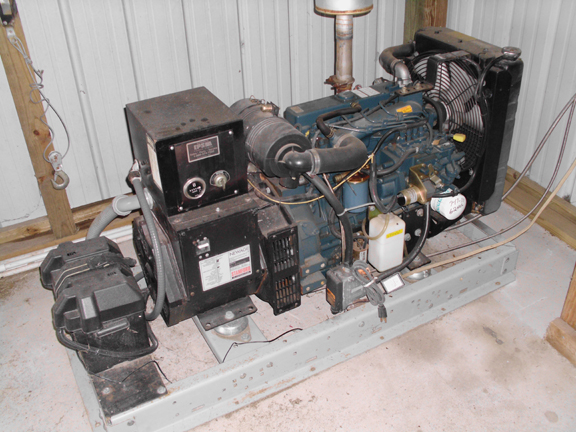

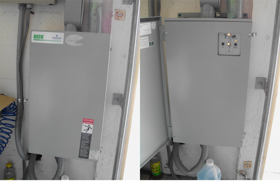

I live in Florida and got sick and tired of the portable/semi stand alone generator hassles. Upgraded to a Stamford NewAge genset powered by a Kubota V2203 4 cyl diesel. Everything runs through an ANSCO automatic transfer switch which also exercises the unit as I wish. Runs entire house including A/C, elect stove, elect water heater, lights, COMPUTERS etc. with not even a burp. Best investment I ever made.

The genset is a 20 Kva. I have it installed in an equipment shed about 200 feet from the back of the house. I have to walk out my back door to hear it running. I love it!

What do you feed it fuel wise?

Man you really didn't want to hear it! is that the only reason you put it so far from the house? What size wire did you need to carry 20,000 watts back to the house? Do you know what the fuel consumption is at half load?
I like that type generator the best, would like one in the 12-15 KW range.

The main reason that I put it there is because that is where the equipment shed was located. My brother, an electrician, took care of the wiring, but it looks like the same size wire that my main feed, from utility pole, comes in on. I'll ask him tomorrow. The advertized spec for 50% load is 0.45 gal/hr and 0.79 gal/hr full load. I've never really tired to calculate fuel consumption because I feel that whatever it is, it is. I have a 150 gallon diesel tank that feeds the generator as well as supply fuel for equipment and Kubota tractor.
I live on 25 acres in north central Florida. Mostly horse training facilities and large farms in this area and while we aren稚 bothered too much by hurricanes, we do get quite a bit of wind. With overhead electric lines and lots of very large old grow trees; we loose power quite a bit. Just last week the power was out for more than 15 hours.
