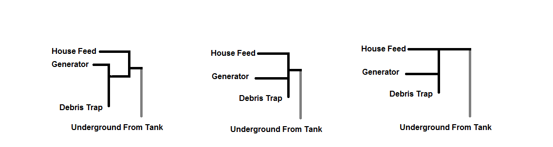

#196
Which version do I want for gas pipe routing? I'm leaning towards #2, though #3 would take a couple less black pipe fittings. Only things in the house that use gas are are burners (furnace, stove, wall heater), no other engines where debris would matter much. Haven't had a problem there in all these years.
671671d1601633676-generator-selection-gaspiping-png
/ Generator Selection? #197
None
At the first T the down leg is the trap, the up leg is then T for gen and house
