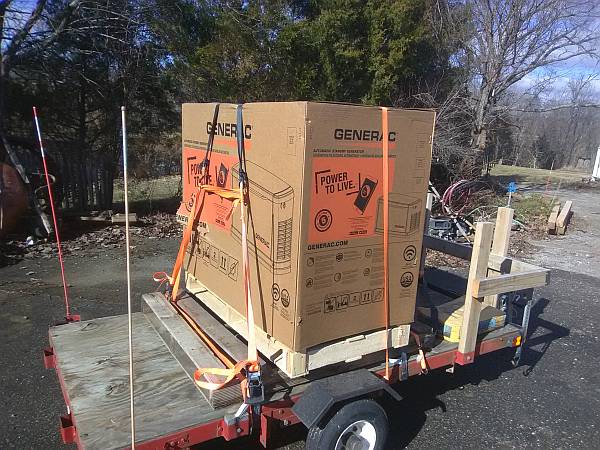

Saw something going through the PDF manual weeks ago about using 1" bars to lift the unit off the pallet. Can't find it in the printed book that came packed inside. I think the holes are the same ones the pallet tie downs are using. (Edit, I see it now. Small diagram on page 50.)
I need to get the composite pad out to use it to line up the J anchors when I pour the concrete.
But first I need to go back and get more concrete. Couldn't carry any more weight today.

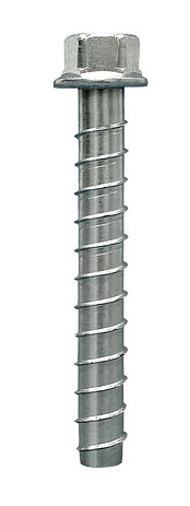

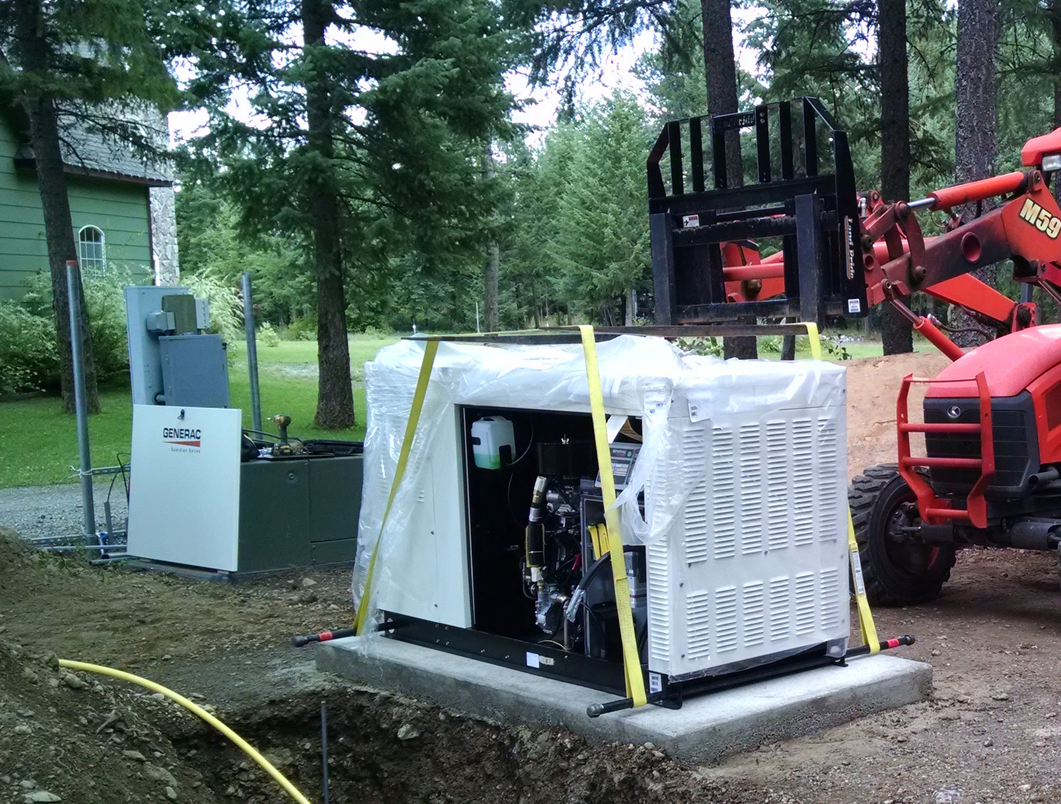

you dont need to disconnect anything. dont take the pad off. simply place the generator onto the concrete pad THEN drill out the front 2 anchor holes later on and install 2 Simpson bolts with an impact hammer. putting the bolts into the concrete first SUCKS. if its a little off, your screwed.
i use the 3/8" x 6" Simpson Titen bolt (THD37600H). the trick is to drill completely thru concrete and vacuum hole, redrill and revacuum than impact it in. works GREAT.
i usually install all 3 myself, but for the rear one you will need an 18" long impact drill bit, and not many people have that in their tool boxes ( i have 2).And really, with just the front 2 installed, nothing is going to move a 500# generator.
By the way, if you remove the bolts attaching the composite pad, good luck trying to resecure it to the generator. the nuts are internal and fall out when you remove the bolts. the only thing that will keep the 2 pieces together afterwards will be the anchor bolt.
i use a transport cart to move and set my generators, but 2 - 3/4" iron pipes and 2 web straps (moving straps with sewed loops) work just as well. will need a strong back and 2 strong and stupid people. i have had to move these units in the past and if the straps are just perfectly placed, 2 people can jog them into place pretty easily.
the absolutely easiest way is a tractor, a set of pallet forks and 2 longer moving straps. heres me moving a larger liquid cooled with this method. the air cooled are moved same way.IMG_0236.JPG

3/4 pipe would work if I had any, which I don't. I do have enough 1" steel bar I can cut. I had planned on doing what you show for the last move into place, but I might use the BH ... not sure yet. Also might use a chainfall. I've got a HF 1 ton and a load leveller.
The cardboard box top has the template for the holes. Think I might set the back one into the concrete, then drill the two front ones later. Pad will need to set for a week at least before I can put weight on it due to temperatures.
