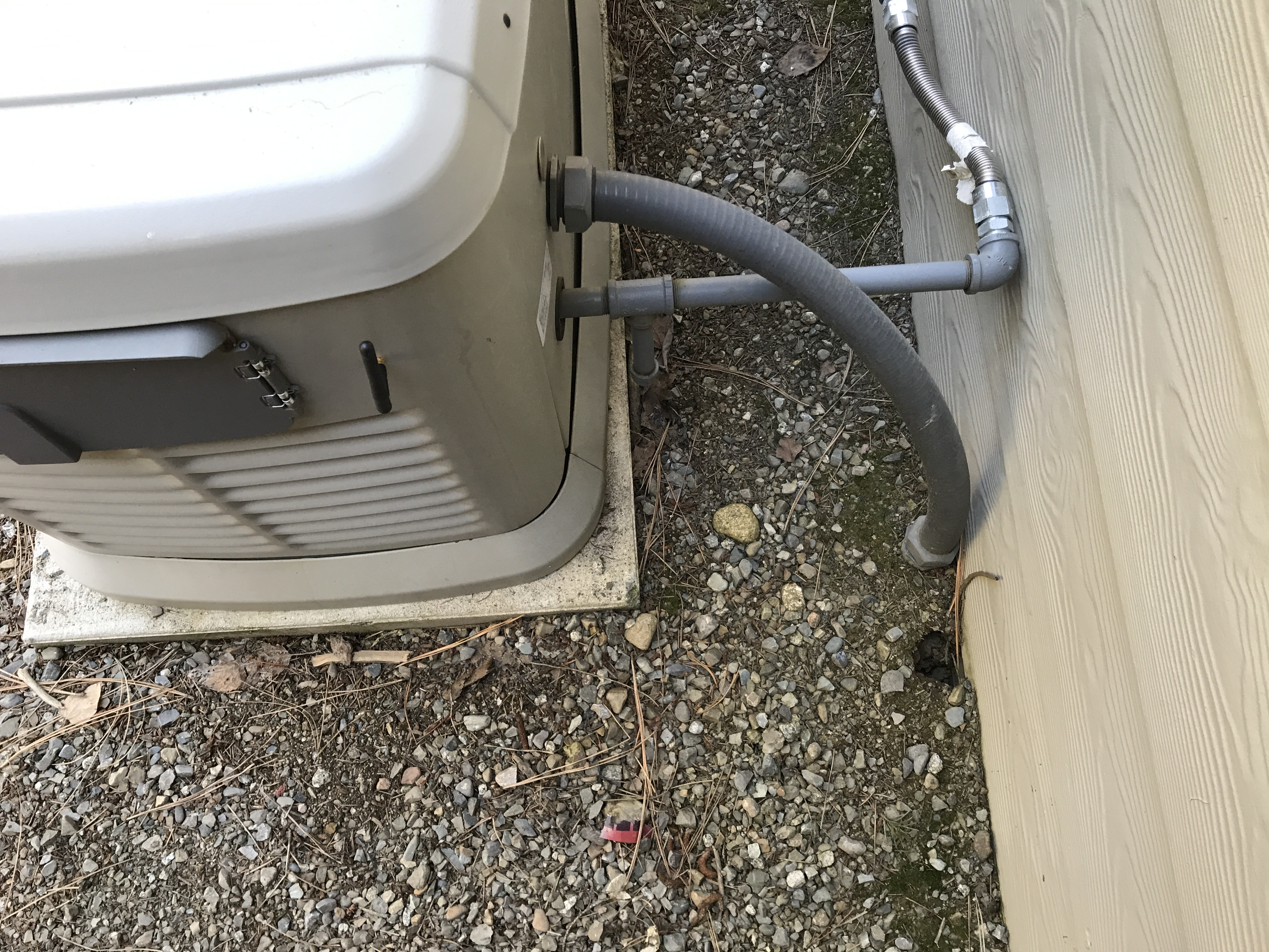

Been a LONG time since I've seen somebody try so hard NOT to take a job, but they succeeded in not getting it. Last contact was above when he said he wasn't familiar with the composite cable and that he would look it up, check the specs and call me back. His other beef was that it wasn't in conduit. It's rated for exposed runs, so there is no need for conduit. I was always taught to leave a drip loop. The run between the generator and the ATS is about 8' total with only less than three feet horizontal between the generator and the strut holding the ATS. I left a small sag in the horizontal run. He says no, no loop, has to be fully supported. For that matter, I have more strut on hand and could run that to support the cable if that was his last beef, but he hasn't bothered to get back to me.
This is a residential application, not heavy industrial. That small loop will not in any way affect the operation of the generator, nor pose any hazards.
The fact he wasn't familiar with the composite cable is one thing. The fact he hasn't followed through is another.
You may even agree with him and not want to do one like it in your area. I don't know, but I can't see that affecting the warranty in any way.
I'll call one other dealer today and see what they say, otherwise I'll be starting it myself. I'm about done trying to appease people and begging them to let me give them money.
I picked up a Group 26R battery today at RK. I have a VOM and Manometer. If you're willing and will be at TBN for a while (day and time to be determined), I'll try to have a computer out there while doing it, unless I can get the other dealer to co-operate.

Well. The composite cable is approved for buried and in wall, but its not sunlight resistant as far as I can determine. I always place the exposed exterior section in 1-1/4” flexible conduit

I couldn't find 1-1/4 flex. Nobody would sell it in less than 100' coils that I could find. I needed about 6 feet at the most. I was able to uncoil a foot or two of 1" enough to get around the generator end to help with strain relief, but not enough to do the full length.
Also, the version of cable I bought IS rated for UV protection if you can find the post above with the link.
Type: Power Composite Installation Cable - TC-ER (Exposed Run)
600 Volts, 90°C dry, 75° wet
TFFN Conductors (PVC/Nylon)
PVC Jacket
UL Listed 1277 Type TC-ER
FT4 / IEEE 1202, Sunlight Resistant, Direct Burial
This specification covers the construction requirements of multi-conductor power cables in accordance with UL, Inc. Standard 1277, (UL) Listed as Type TC-ER. (Exposed Run)
The construction consists of stranded, bare copper conductors with Polyvinyl Chloride (PVC) insulation and nylon jacket. The conductors are cabled together and have a sunlight resistant, Polyvinyl Chloride (PVC) jacket. - Sequential Marking

Yes, it mentions a messenger wire, but again, we're only talking three feet.
Also, this is under awning that blocks all direct sunlight, but does not inhibit ventilation.
But none of that would affect the operation of the engine.

cool, did not know about sunlight resistance. back in 2014 when i started using the stuff, it was not rated for sunlight....but back then it wasnt rated for use in framing either. things change. 3 foot doesnt seem like any issue anyways. that stuff is sold by the foot, but only in wholesale houses, and they generally wont sell to the public.

#420
It's running.
I took a shot before I saw your post. After I worked out and past all the weasely lawyer words and diagrams and got down to the one, two, three steps it didn't seem too bad. LP pressure is 10.7 WC or so while running, was 10.9 WC before start. Once I hit 'Manual' is cranked about 3 seconds then fired right up. I'm on the load side now during the first 20-30 minutes they call for.
Next I guess is the auto-transfer test.
Haven't done Activation or WiFi just yet.
