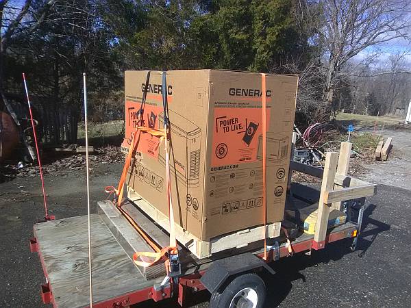

#349
I have no idea how this arrived in 4 weeks instead of the 14+ everybody was saying.
682012d1609694994-generator-selection-16kw-jpg
Really screwed up my scheduling though.
