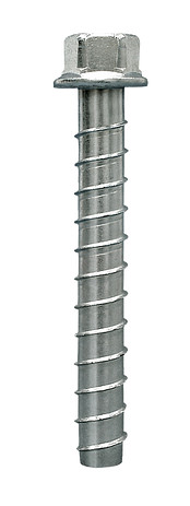

you dont need to disconnect anything. dont take the pad off. simply place the generator onto the concrete pad THEN drill out the front 2 anchor holes later on and install 2 Simpson bolts with an impact hammer. putting the bolts into the concrete first SUCKS. if its a little off, your screwed.
i use the 3/8" x 6" Simpson Titen bolt (THD37600H). the trick is to drill completely thru concrete and vacuum hole, redrill and revacuum than impact it in. works GREAT.
i usually install all 3 myself, but for the rear one you will need an 18" long impact drill bit, and not many people have that in their tool boxes ( i have 2).And really, with just the front 2 installed, nothing is going to move a 500# generator.
By the way, if you remove the bolts attaching the composite pad, good luck trying to resecure it to the generator. the nuts are internal and fall out when you remove the bolts. the only thing that will keep the 2 pieces together afterwards will be the anchor bolt.
