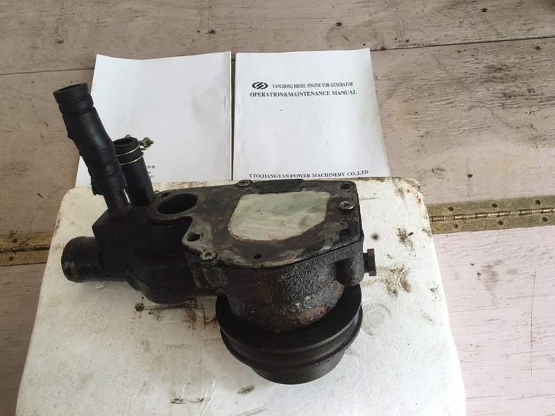

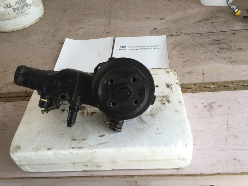

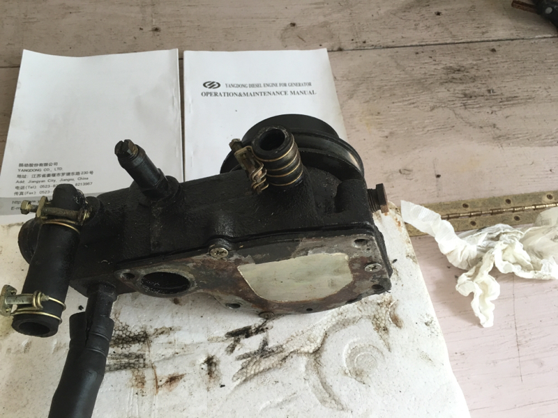

Perhaps not the most correct forum, but I have a 24kw generator, built in Phoenix from mostly Chinese components. The engine is a Yangdong YSD490ZLD diesel. The water pump went bad. At this point, the dealer, Affordable Generators in Phoenix has not been helpful with a replacement, saying not in stock and has to be ordered from the factory. I've asked for the appropriate part number, but nothing so far. If anyone has any suggestions as to remedy, I would appreciate it. David

Is it possible to get the old one rebuilt? Might be a lot easier than ordering one.
A lot of Chinese stuff is a copy of something else. Maybe, just maybe, a water pump from whatever it was copied from would fit. 24 kw is about 18 horsepower. Look around at all of the 20 ish HP diesels you can find. Might get lucky.
How much is it to order a water pump from the factory. Might take a long, long time, but it could be the low cost option.
/ Generator water pump
Is it possible to get the old one rebuilt? Might be a lot easier than ordering one. A lot of Chinese stuff is a copy of something else. Maybe, just maybe, a water pump from whatever it was copied from would fit. 24 kw is about 18 horsepower. Look around at all of the 20 ish HP diesels you can find. Might get lucky. How much is it to order a water pump from the factory. Might take a long, long time, but it could be the low cost option.
Yes, I'm looking into the rebuild possibility. Are you familiar with any rebuilders? Haven't found one likes calmly yet.
I had great luck getting a fuel pump/governor for this engine from Aliexpress. While I can find pumps listed for that engine, none of the pic match. If I had a part # I'm confident someone there would have it. I'm at the mercy of Affordable Generators for the factory order unless they provide me the part #. Unfortunately, the part in the supplied manual appears to be different.

If all else fails, you can try an aftermarket 12V electric WP and plate over the existing hole. They can be sourced from most auto parts retailers. Just a thought.

Thanks.
I would have to figure out routing for other connections. Wouldn't loss of the fan be a problem?

Happy to report my dealer "found" a water pump in inventory. I got it yesterday, figures crossed it was right one. It is!!!!.
Installed the hose nipples today, need to cut a gasket. Waiting for the diesel mechanic to tell me when he's coming to install. Normally, I'd just do it, but had this guy confirm that the word was in fact the problem and he uninstalled the broken one. Had told him he would install they replacement as I was hoping it would arrive while I was on vacation. Interesting character to visit with anyway.
