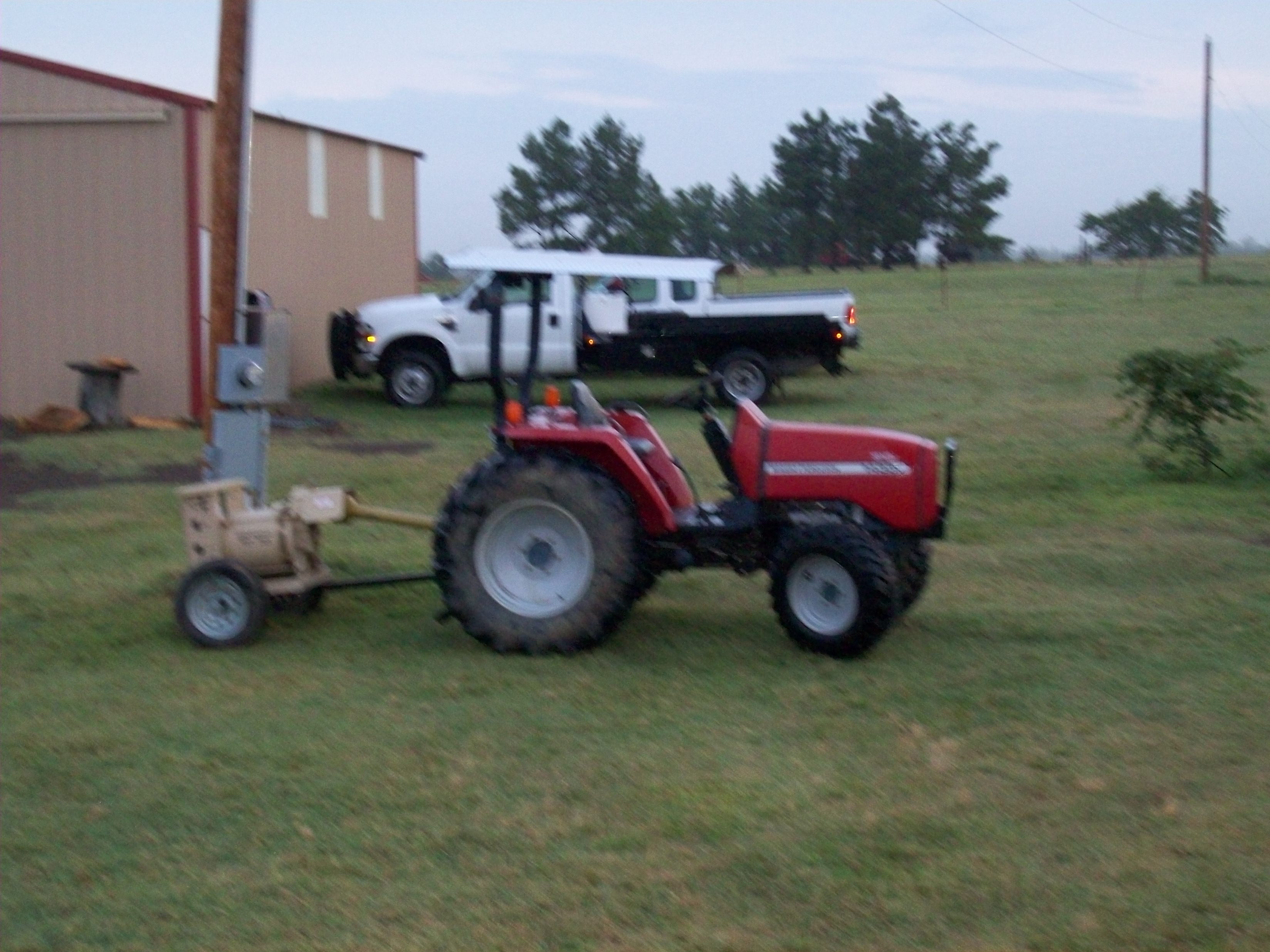

A pto generator is great. They are a very low maintainence item in my experience. As mentioned, you really need a transfer switch. If you don't have a transfer switch stick to running necessary items from extension cords.
The one we have is a left over from when we owned a commercial hog facility so it is 40 kw continous and 60 kw surge. A little oversized for a house. It is defintely not straining at all even when we are running the A/C ect. Here is a pic of a MF 1433V running it about a month ago during an early morning power failure. All my other tractors where out in the hayfield, so this was the only one home to run it. It did a good job, but we only using the fridge, freezer and well pump( and the coffee maker;) ) This rig needs all of 75 pto hp when it was near full load running the hog barns. You can see the top of the manual transfer switch behind the meter.
