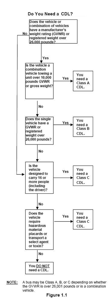

Again, Facts? Finding someone that agrees with you doesn't prove anything. If that was true we would be done here because jonavan agrees with me.
Here is an example of Facts.
Vehicle groups and endorsements
ァ 383.91Commercial motor vehicle groups.
(a) Vehicle group descriptions. Each driver applicant must possess and be tested on his/her knowledge and skills, described in subpart G of this part, for the commercial motor vehicle group(s) for which he/she desires a CDL. The commercial motor vehicle groups are as follows:
Code of Federal Regulations207
(1) Combination vehicle (Group A)輸ny combination of vehicles with a gross combination weight rating (GCWR) of 11,794 kilograms or more (26,001 pounds or more) provided the GVWR of the vehicle(s) being towed is in excess of 4,536 kilograms (10,000 pounds).
(2) Heavy Straight Vehicle (Group B)輸ny single vehicle with a GVWR of 11,794 kilograms or more (26,001 pounds or more), or any such vehicle towing a vehicle not in excess of 4,536 kilograms (10,000 pounds) GVWR.
(3) Small Vehicle (Group C)輸ny single vehicle, or combination of vehicles, that meets neither the definition of Group A nor that of Group B as contained in this section, but that either is designed to transport 16 or more passengers including the driver, or is used in the transportation of materials found to be hazardous for the purposes of the Hazardous Materials Transportation Act and which require the motor vehicle to be placarded under the Hazardous Materials Regulations
Commercial motor vehicle groups. - Federal Motor Carrier Safety Administration
The FMCSA even the answers question point blank for people that can't read.
Question 2: Is a driver of a combination vehicle with a Gross Combination Weight Rating (GCWR) of less than 26,001 pounds required to obtain a CDL even if the trailer Gross Vehicle Weight Rating (GVWR) is more than 10,000 pounds?
Guidance: No, because the Gross Combination Weight Rating (GCWR) is less than 26,001 pounds.
Interpretation for 383.91: - Federal Motor Carrier Safety Administration
They even made a picture if that wasn't enough.

You really are A PIECE OF WORK! Read what it says over 10k trailer let me say it sloooow for you. The 26k applies to a single vehicle or truck and trailer combined. Then READ or,or,or a trailer in excess of 10k. Which in this case the orignal poster would need a trailer rated at over 10k to haul around a M59. I tried but I just can't fix stupid!!
