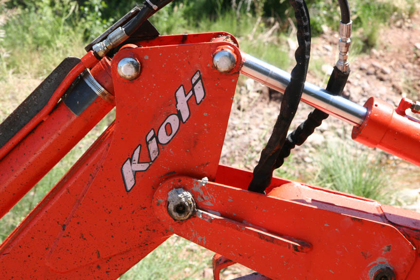

Is there a good parts inventory in this country? I may be looking at a new cylinder sleeve, and I'm wondering how long I should expect to wait for it. I have to plan my work around the delay, when known.
What has your experience been with major parts?
Thanks, Charlie

Thanks, folks: if I need the hydraulic cylinder sleeve, it looks like it might be a long wait. I'll call the dealer on Monday. I'm exploring a repair (stripped fitting welded on).

Any pics? At first I thought you were talking about an engine sleeve, then your last post says Hydraulic cylinder sleeve. You might be better off just getting a replacement cylinder from Tractor supply, if in fact that's what your talking about.

BTDT: sorry for the lack of clarity. The photo in the next post shows the cylindrical sleeve of the bucket curl hydraulic assembly. Thanks for the Tractor supply hint.
BTI: thanks for asking.
I MAY need a bucket cylinder outer sleeve, because one of the hose fittings welded to it is stripped. I hope to be able to replace the fitting, and am still researching what it will take to repair it. In case everything else fails I thought it would be wise to know availability in country, and for this and other parts approximately how long it would take to obtain if not in country.

Here is the photo

I would take it off and take it to a reputable cylinder shop.
They should be able to fix you right up.

Like BTI said, take it to a hydraulic shop. They will fix it for very little compared to what the dealer will want for a new cylinder and it will be a lot quicker turn around.

Figure any machine shop could do the job, we have done it many times when cutting cylinders down for some applications, a cylinder shop could do it easily
