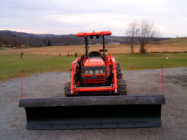

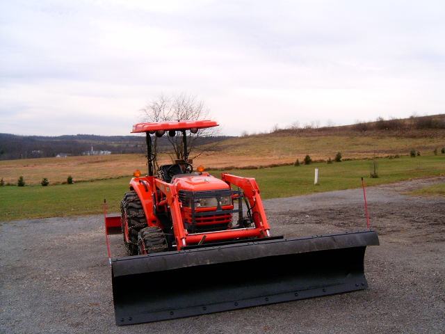

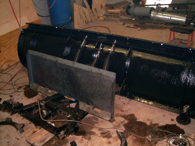

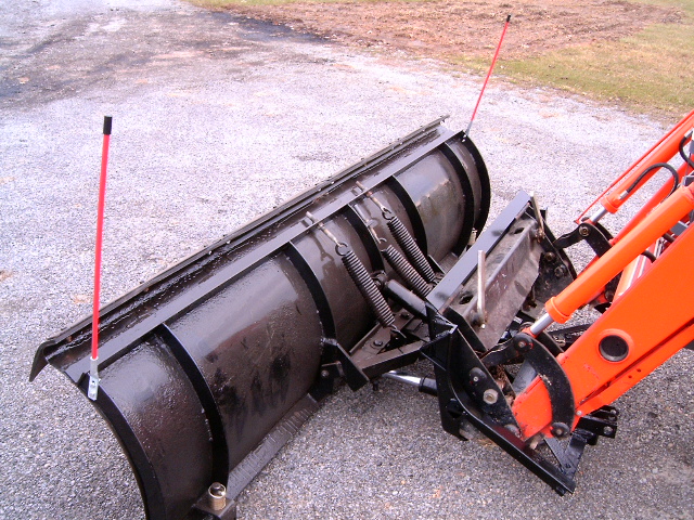

Put on tire chains and rear blade today.
And mounted a new to me Western 9' snow plow.

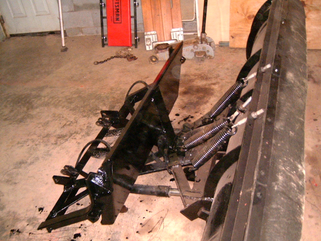

Found this truck plow cheap. Tore it a apart, cleaned it up and painted. Then changed it around adding a QA plate to attach to the loader.
I need to finish running hoses from the rear remotes to run the power angle and I should be ready to go.
Now I will wait and see if my DK 35 can handle a 9' snow plow loaded with snow.

That's an impressively big and heavy-looking plow! Post pics to show how big a pile of snow it takes to stop you :)
/ Getting ready for snow
I will try to remember to do that.

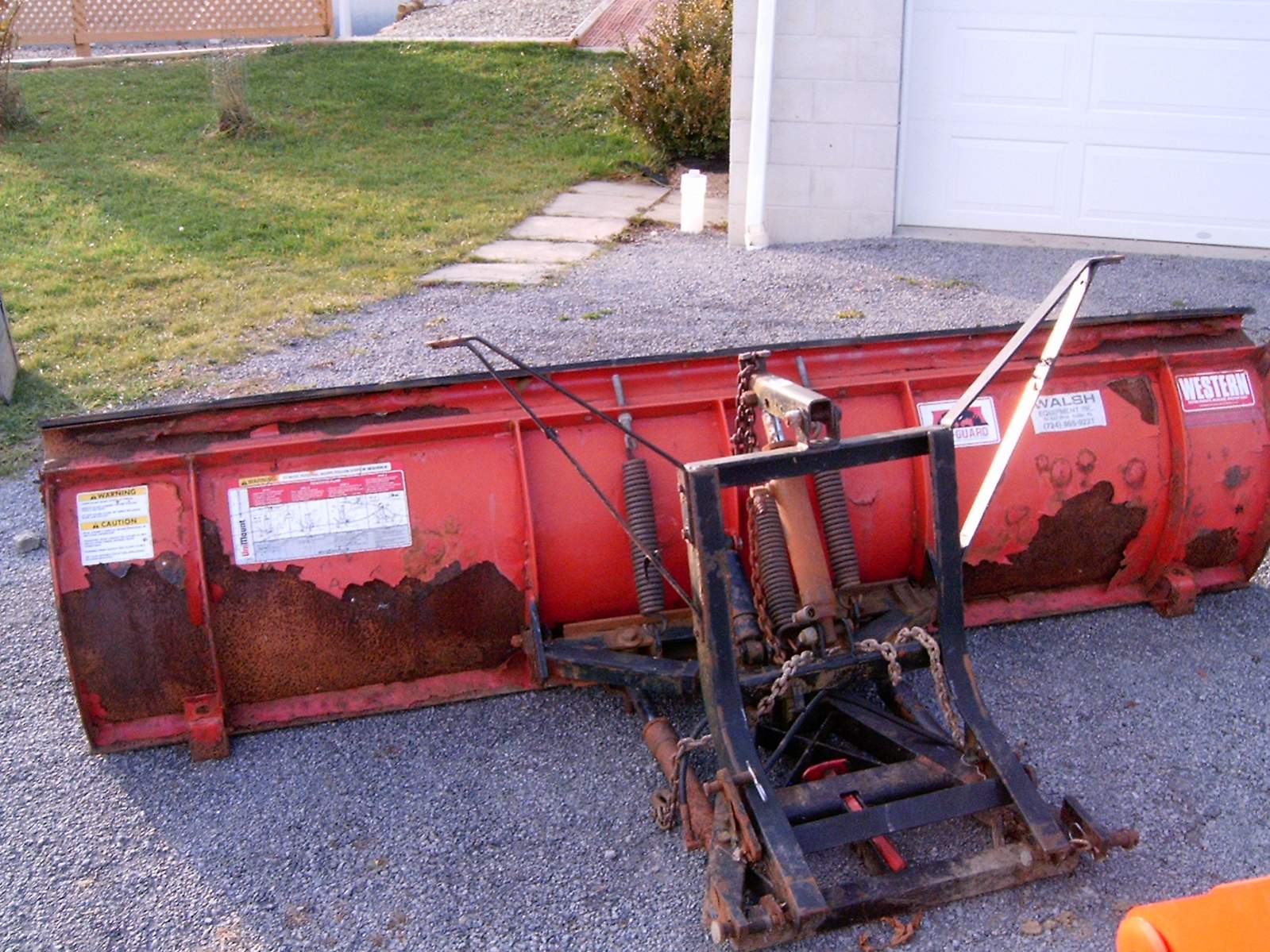

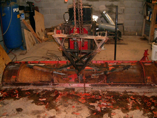

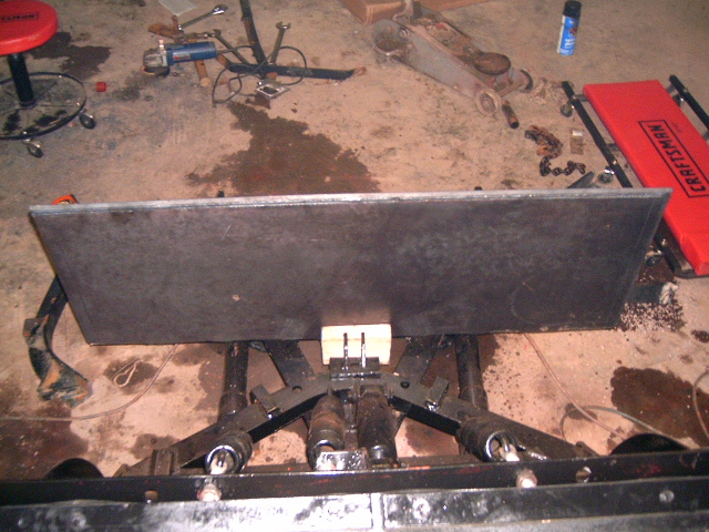

Here are a few pictures of what I started with.
Plow had a lot of rust. Took plenty of cleaning, scraping, welding and painting.

/ Getting ready for snow #4
Vince, that thing's a beast. Looks like a fun project. It'll be interesting to hear how it does.
I bought an old box blade a while back. It didn't have any paint on it; was all rust. I scraped it down and wire brushed it, then painted it with POR15, and then overcoated with chevy engine orange. It's been sitting in the weather now for 3 years and no signs of rust or paint fade yet. Time will tell if the POR15 was worth the cost.

/ Getting ready for snow #6
I have a 7' plow on my DK45 and i also have chained up all 4 tires. It works with power to spare.....just keep an eye out to the lower end of the quick attach plate while plowing. if it touches the ground at all it will push the front end sideways.
I found the sweet spot for mine and i can do most of my plowing (did a 9-10" snowfall) in high range and max side tilt.
I could have gone with a wider plow, but everyone from the dealer to others here on the site recommended nothing more than 7' for my deeper snows. I need the faster speeds to blow as much of the mess off the side and over the mounds.

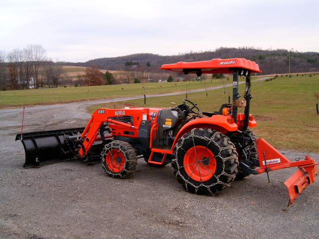

I had been plowing with a 7' front blade for years.
But it didn't have power angle. I was planning on converting my old 7' to power angle this fall. But I just happened along this 9' truck plow cheap and decided to try that route for now and see how it works.
I still have the 7 footer if I need it.

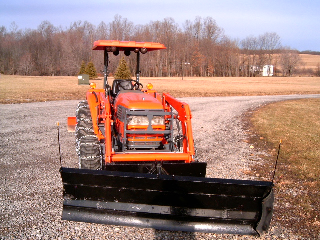

I was thinking of taking the same approach....was wondering how you decided where to mount th QA plate
/ Getting ready for snow #9
Looks good. Can't wait to get some more snow. Just got our first snow that need be plowed two days ago, only a couple inches but I was either going to sit in here on TBN thinking of using my tractor or actually go out there and do it!:laughing:
I tryed to stay a far forward as I could to keep the blade closer to the tractor/loader.
But just far enough back that the blade could pivot freely and I could still get some gusset/support bars welded in the front side of the QA plate

/ Getting ready for snow #11

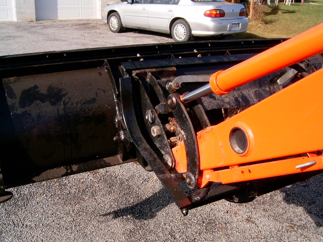

thanks, its hard to tell but does the frame work come close to the loader arms or loader cross brace if you roll the blade forward..??
#12
It has plenty of clearance past the front of the tractor and grill guard, so I can lift the loader arms and blade to full height if I want.
It will hit the bottom of the loader arms in the dump position.
I can roll the blade down in the dump position just under half way before it will touch.
For me thats not an issue. I never have the need to roll my snow blade down that far.
I can try and get a picture sometime this weekend if you want.

Dear Dr. Frankenstein,
Nice monster you have created; now all you need is the requisite lightening bolt (snowstorm) to jump start your creation!:thumbsup:
Careful not to rack those loader arms with that big a plow- the DK-35 loader has it's limits with that kind of force.

I took a few more pictures of the QA mount

This is the blade rolled down to were it begins to touch the loader arm.
Hard to tell in the pictures, but the loader arms are probably around 2' off the ground and the front of the blade is setting on the ground
This works fine for me. I've been plowing with a front blade on my loader for years and never needed to roll the blade beyond this point anyway.
