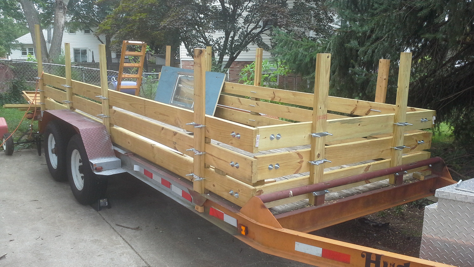

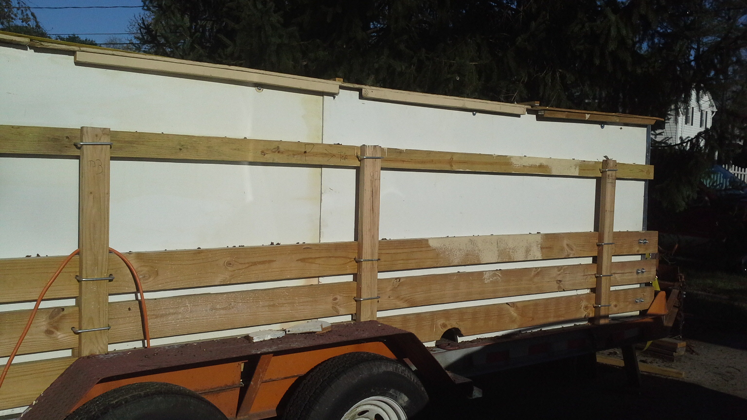

Hudson 16'+2' dovetail with M4700
Hudson 16'+2' dovetail with sides for carrying stuff, takes about an hour and seven 2"x6"x16', some 2x4's and about $100 of nuts and bolts.
Hudson 16'+2' dovetail with enclosed 4' high body, takes about 2 more hours and 9 sheets of plywood plus a few bits and pieces.
For it's next iteration I'll probably add a foot or two to the side height.

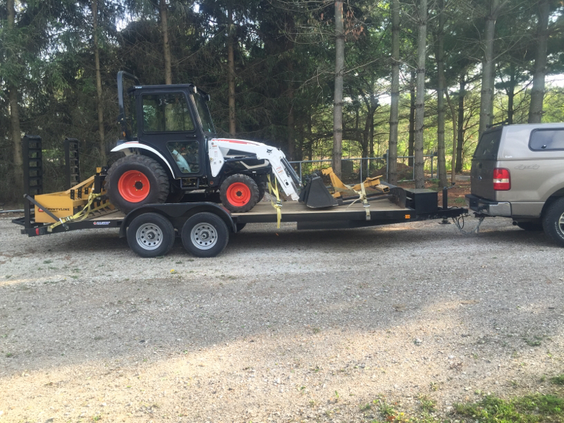

I used a 16 foot 7 k landscape trailer for years. It was lightweight and pulled very well however. When it comes to Halling tractors I found I was constantly overloading it with weight and length. I recently upgraded to a 20 foot 10 K car hauler with standup ramps. So far I've been happy with it but it is a heavier trailer so you can feel it more when it's empty and being longer it takes a slightly larger turning radius to make a turn. Everyone said to stay away from the standup ramps because they take away from your ability to overhang the back. But I rarely do that so they have worked out very well especially that they are spring loaded and easy to lift.

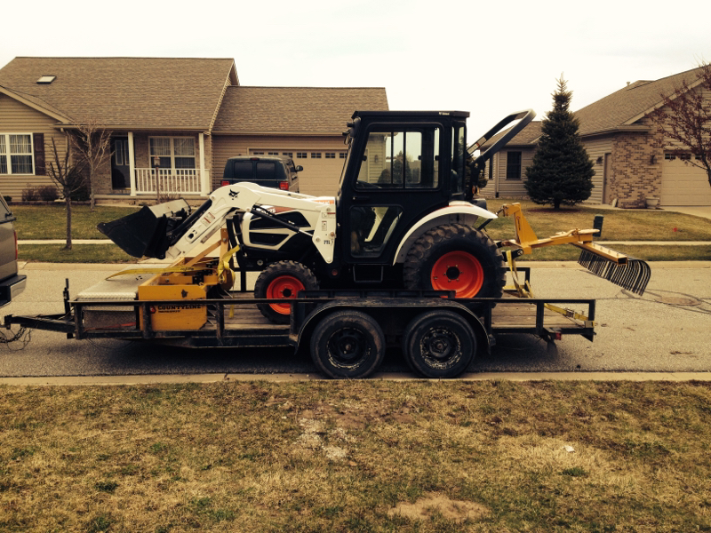

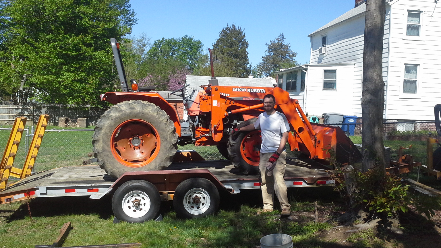

Here is a pic of the 16' 7 k you can see why I needed a bigger trailer. My tractor is the same size as a kioti ck 27 for a size reference.

Here is the new set up.
