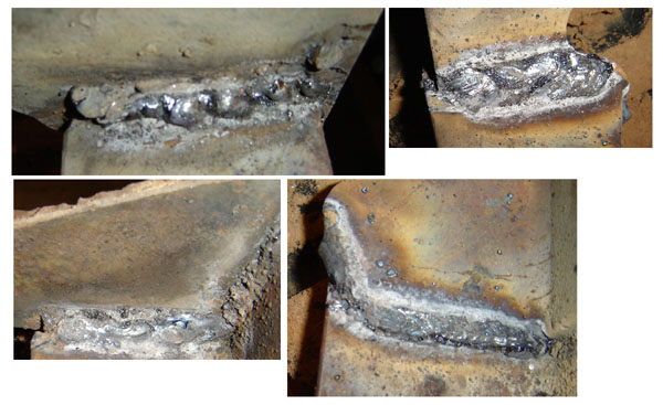

Here come my first 4 welds
Just some scrap that was laying around,,,
Put together randomly
Feel free to giggle at them..
I actually seemed to get one of them decent looking but then the last weld was actually worse...
You try to figure out the order I did these in...
tom
The metals here are appx 1/4 to 5/16 angle and one larger piece of appx 3/8 plate that I attached the angle too.
How's your progress Mith ?
